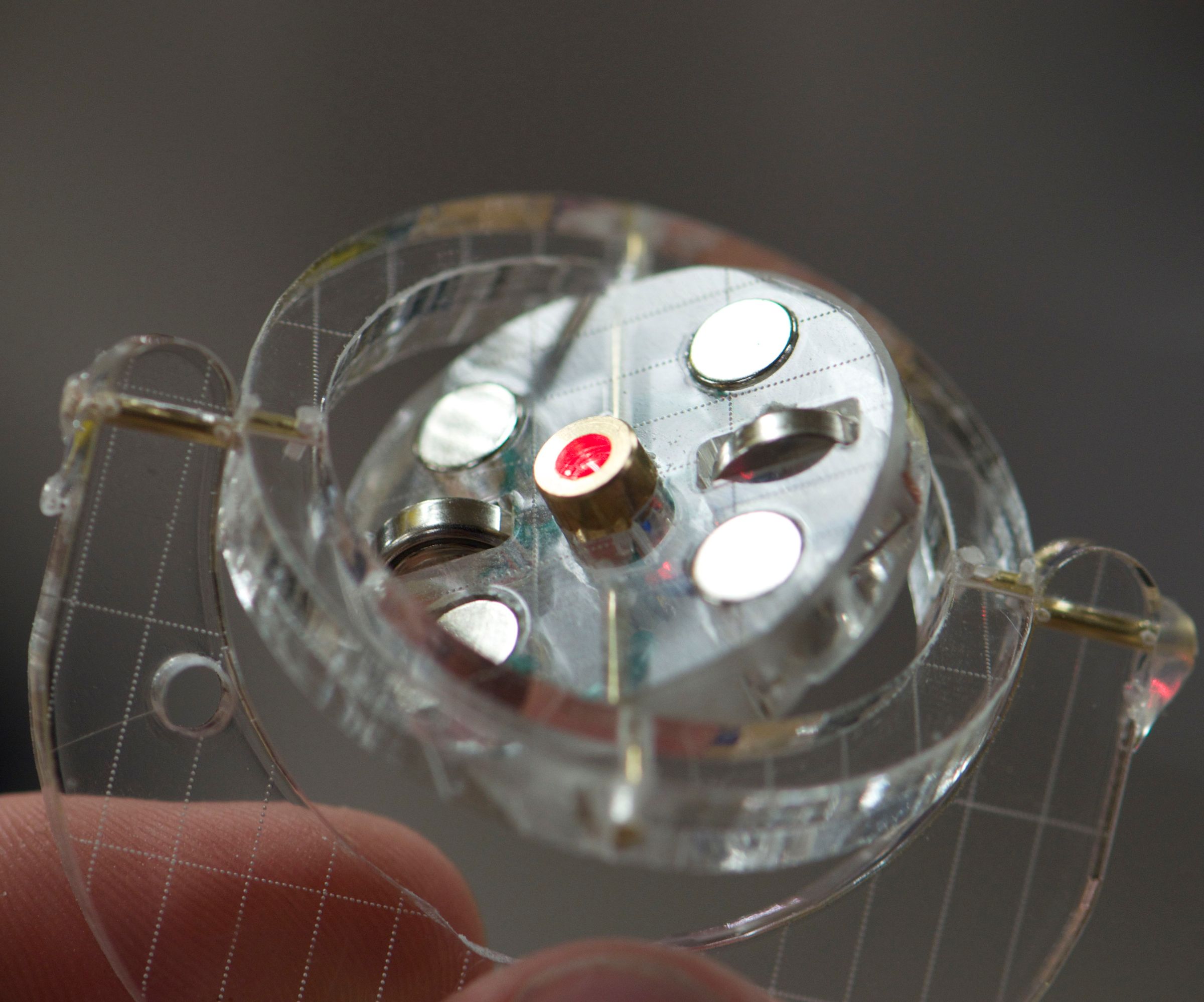

To sense the home position of the iris, I installed a hermetically sealed magnetic sensor. When a magnet on the rotor nears this sensor, a contact is closed which is detected by the microcontroller. This then defines the home position.
The magnet is held onto the rotor with a 3D printed mount which has long slots to allow fine adjustment of what angle the system sets as 'home'.
