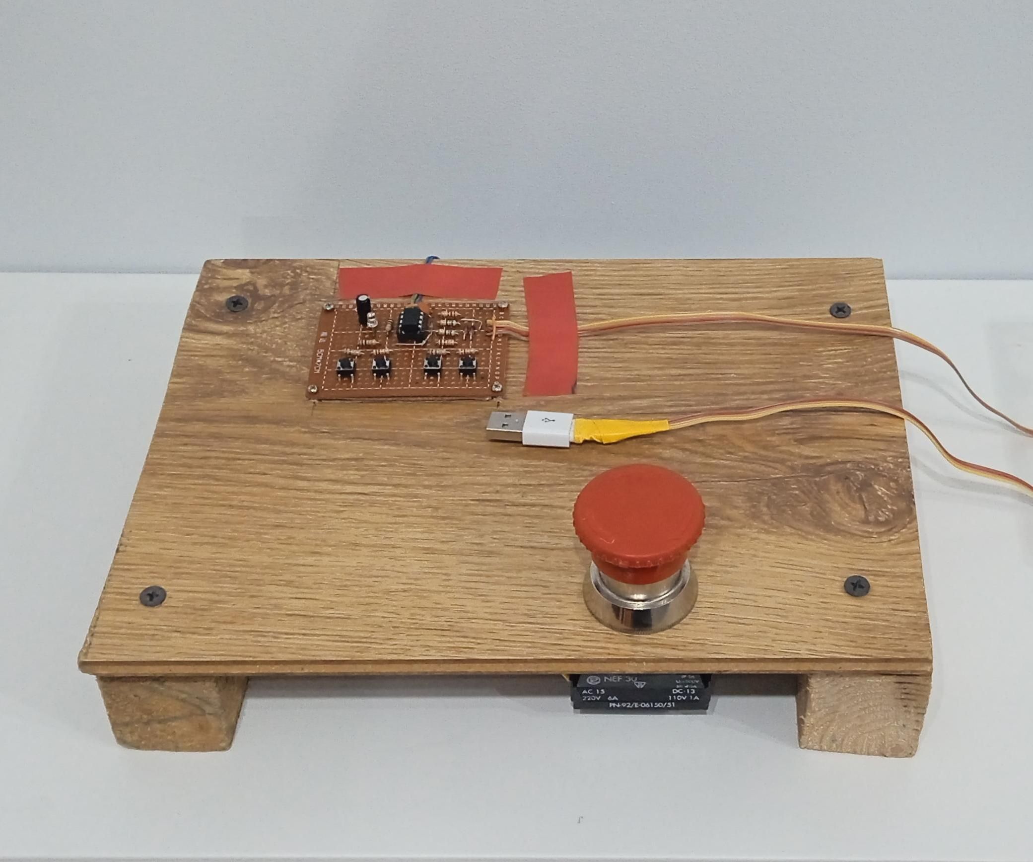

Step 2: How Fan Control Works
Channel A uses two inputs. Each of those Channel A inputs has a level associated with it, lets call those levels A0 and A1. By default both of those levels are 0. Both inputs have threshold RPM values associated with them (3 thresholds per input). When first threshold is achieved, A0 or A1 increases to 1, when second it increases to 2, and the third threshold sets one of the input levels to 3. Later A0 and A1 are combined (simply added together and prevented from achieving a value higher than 3), making main output Channel A level number in 0-3 range. This number is used to control output fans speed, 0 means that they are powered by 7-8V (duty cycle of 0%). Higher output levels mean that fan is powered from full 12V for 33%, 66% or 100% of a 100ms or 33ms cycle (it depends on selected frequency).
Channel B has only one input (B1, physically it is shared with Channel A [PB1 pin]). There are six possible B1 levels (1-6), default level is 1. Five threshold values exist, which are able to increase B1. B1 is used as main output Channel B level. When it is 1, 7-8V powers output fans for 33% of cycle time in one cycle, in the other one for 66%, for the rest of the time power is disconnected. Level 2 means 66% of every cycle is 7-8V, rest 0V. Level 3 means that 7-8V is constantly applied. Levels 4-6 mean that fan is powered from full 12V for 33%, 66% or 100% of the cycle, for the rest of the time voltage is 7-8V.
Frequency of this PWM control by default is 10Hz. It can be increased to 30Hz by closing J7 jumper pins.
When higher threshold is reached, A0, A1 and B1 levels increase instantaneously. When RPMs fall however, level is held for 200ms and may only decrease by 1 per 200ms. It is to prevent rapid changes of those levels when input fan RPM is very close to the threshold.
Step 3: Soldering Electronic Components
Solder all electronic components to the prefboard (except Attiny13, it will be later put inside a socket). Use copper wires (0.5 mm diameter ones from UTP cable should be perfect) to make electrical connections between components. If you have trouble with pushing large wires coming out of Molex(AMP MATE-N-LOK) connector, you can drill larger holes for them. If you don’t want to use a drill you can always turn a screw few times inside small prefboard holes. Make sure that wires do not cause any short-circuits.
If you prefer to make your own PCB I also provide .svg (board dimensions are 53.34x63.50mm) and .pdf (A4 page size, inside .zip archive) files. Single sided copper clad board should suffice, as there is just one connection on the front side (it can be made with a wire), so files for the front side are provided main so that this connection can be identified.
I strongly recommend that you cover back of PCB with some insulating material that will prevent any accidental short circuits. I used few layers of regular paper that are held to the PCB’s edges by few strips of insulating tape.
