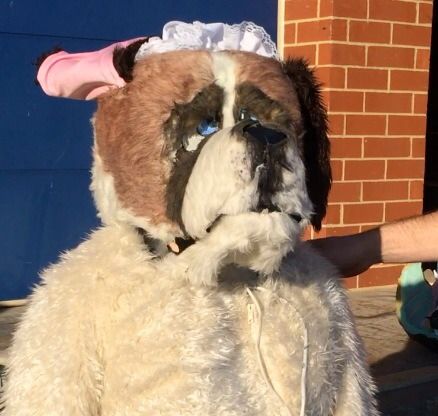

Step 4: Cut Out Head Space and Glue
Step 5: Carve the Heck Out of It
Used just about anything to shape this: cheese grater, saws, sander, rasp, files etc.
Step 6: The Tail
Same principles, cut into segments and used fence hinges.
Here's the trick. The hinges pop right back out so I used expanding spray foam in the gap to seal em in. If one pops out I recommend the same.
Attach croc vynyl from fabric empire using liquid nails
