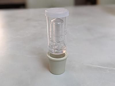

1 airlock:
One of the tricky parts of making wine is that, during fermentation, CO2 is produced that we need to allow to escape the liquid, otherwise, our brewing vessel will become pressurized which could, as you might expect, cause some major issues later on. However, we can’t just leave the jug open because we don’t want a bunch of random microorganisms from the air getting into our wine; we just want the microorganisms we put in there on purpose. Therefore, we will use an airlock device on the gallon jug. The airlock is filled with water so that CO2 can bubble out of the jug but the outside air can’t get in.

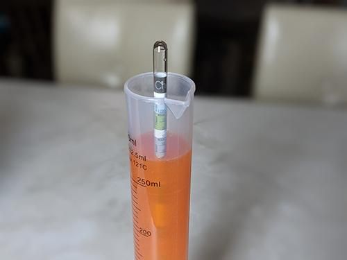

Anyway, to measure the alcohol content of the wine, we will use an instrument called a hydrometer. A hydrometer is used to measure the specific gravity of a liquid, which is a measurement of the relative density of the liquid. As the alcohol content of our wine increases, the density of the liquid will decrease because alcohol is less dense than water or our candy corn juice. By measuring the specific gravity before we start fermentation (called the original gravity) and the specific gravity periodically during fermentation, we can use an equation to calculate the alcohol content of the wine.
Measure the Original Gravity
Alright, so in this step we will measure and record the original gravity of the candy corn mixture before starting fermentation. First, fill the graduated cylinder with the candy corn juice. The specific amount does not matter as long as there is enough for the hydrometer to float in the liquid without touching the bottom of the graduated cylinder.
Then, go ahead and float the hydrometer in the liquid.
Carefully peak through the graduated cylinder and take a measurement of the specific gravity off the hydrometer. It should be somewhere around 1.1. Then, because we will not need to reference this measurement again for several days, go ahead and write it down somewhere so you can refer back to the reading later.

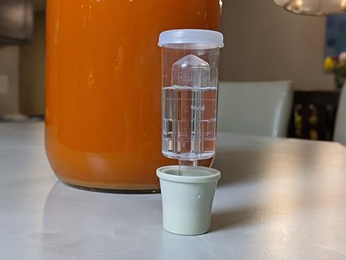

Now that the candy corn juice has cooled down to room temperature, we will add the yeast and the airlock to start the fermentation process. Adding the yeast is really easy. Just pour the yeast into the gallon jug, being careful not to spill any. The yeast, plus the other ingredients in the Brewsy bag, will dissolve into the vibrant orange candy mixture.
Before adding the airlock, we will give the jug a good hearty shake. Screw one of the caps tightly onto the jug and give the entire thing a shake for a few minutes to make sure all the ingredients in the Brewsy bag are fully dissolved.
Then, if you take a look at the airlock, you will find a water fill line on the outside of the device. Take the top cap off of the airlock and carefully fill the airlock to this line with water, then replace the cap.
Take the rubber stopper part of the airlock and press it hard into the top of the jug. Then, finish the airlock installation by pressing the stem of the airlock into this rubber stopper.
Finally, stash the gallon jug in a dark place that is warmer than 72oF. If the ambient temperature of your home is a bit cooler than this, you can wrap the gallon jug in a towel. In addition to alcohol and carbon dioxide, the fermentation process also gives off heat so insulating the fermentation vessel can help keep it a bit warmer than ambient. Speaking of towels, it is also wise to put down something under the gallon jug to catch any juice that might spill if the yeast gets just a little bit too active in there.
