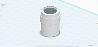

First, place a cylinder for the main body of the tube. Then, add another cylinder for a support ring near the top of the tube.
Next, we can cut a hole in the middle of the tube for the plants to go into. We can then cut holes on either side for the axles to slot into.

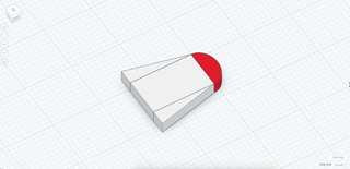

Add slightly less than half a cylinder on top by cutting away the bottom part of a sideways cylinder.
Add the reinforcements to the base using rectangles.

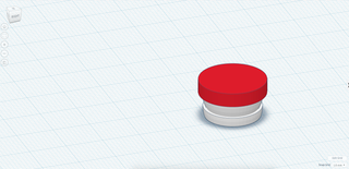

Create a ring by cutting a tube in half and place it on the base.
Add another, more squared, ring by cutting away the center of a beveled rectangle and placing it on the base.

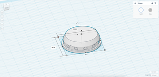

Create the foundation of the base using two cylinders.
Add decoration to the foundation using cylinder holes.
Add a cone to the top of the foundation.
Cut away the top of the cone to top off the base.
