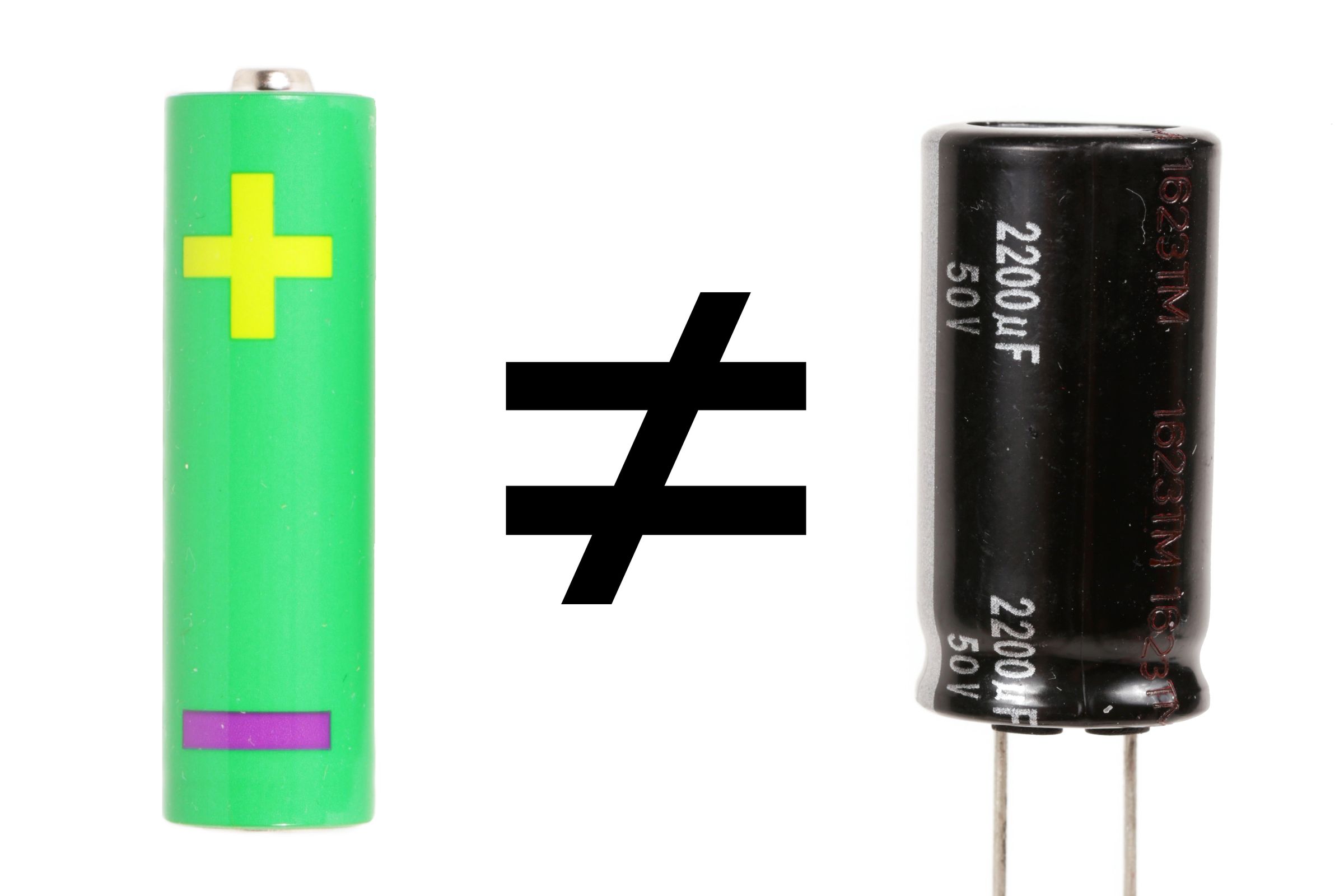

It is important to stress that capacitors do not equal batteries.
The difference between a battery and a capacitor is that in a battery power is generated through a chemical reaction, and in a capacitor a charge is stored and maintained in an electrical field. A battery can yield much more energy for a longer period than a capacitor. On the other hand, a capacitor - even with much less power storage - can discharge considerably more energy exponentially faster than a battery. This is ideal when you need a lot of energy fast.

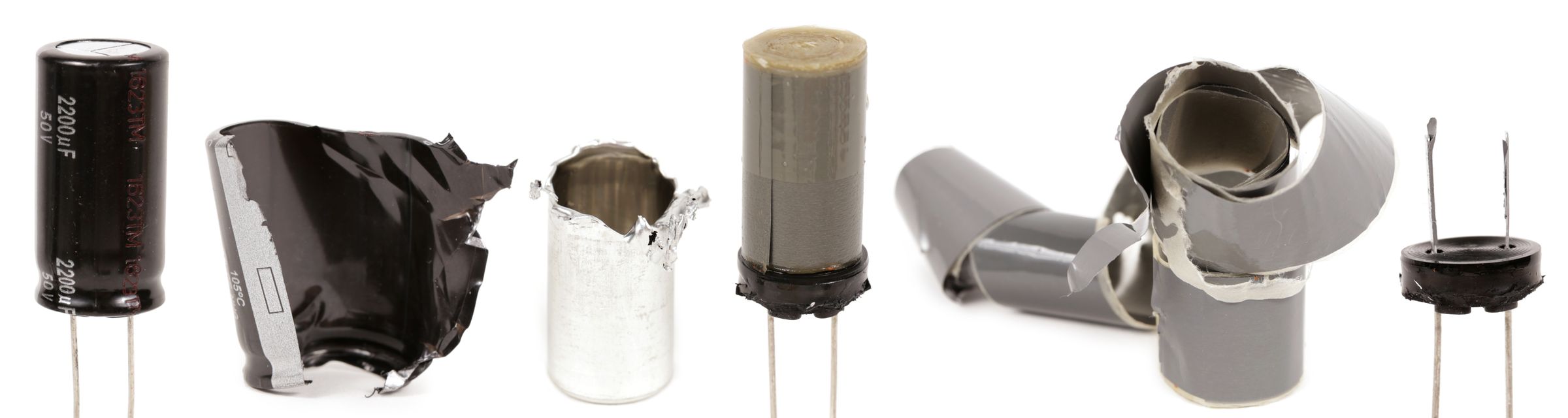

A capacitor consists of conductive metal plates separated by an insulating material called a dielectric. The dielectric can be anything such as ceramics, plastics, oxidizing metals, glass, and paper. For instance, if you crack open an electrolytic capacitor you will find it's just two metal plates wrapped in a chemically coated film. When electricity is applied, the metal conductors polarize the electrons in the film and store an electric field.

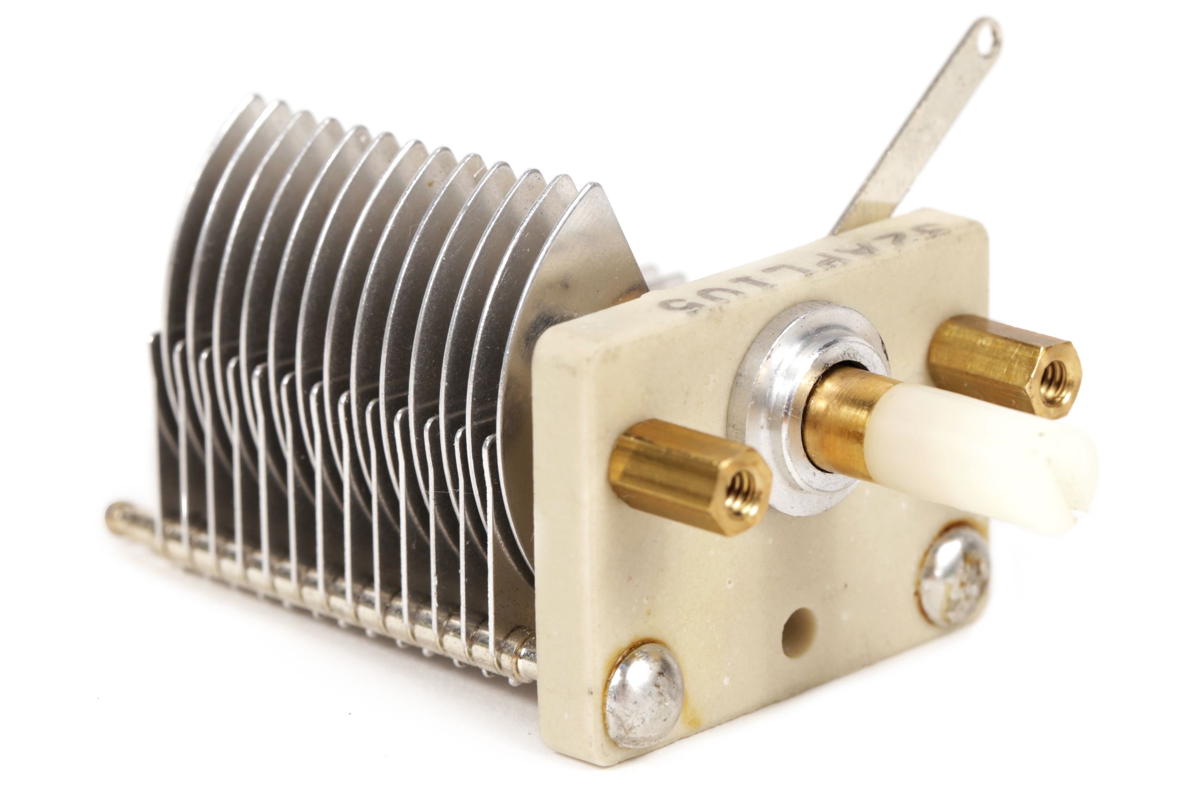

If you were to look at this old-fashioned adjustable capacitor you will notice that it is just a series of metal plates that slide between one another without touching. In this scenario, the air is the dielectric. If it seems weird that air can be charged to hold an electrical field, think of lightning and the Jacob's Ladder project.
Depending on how much physical overlap there is between plates determines how large of an electrical field can be held. The more surface area that the two sets of plates shares between them, the greater the electrical field will be, and the more capacitance it will have.

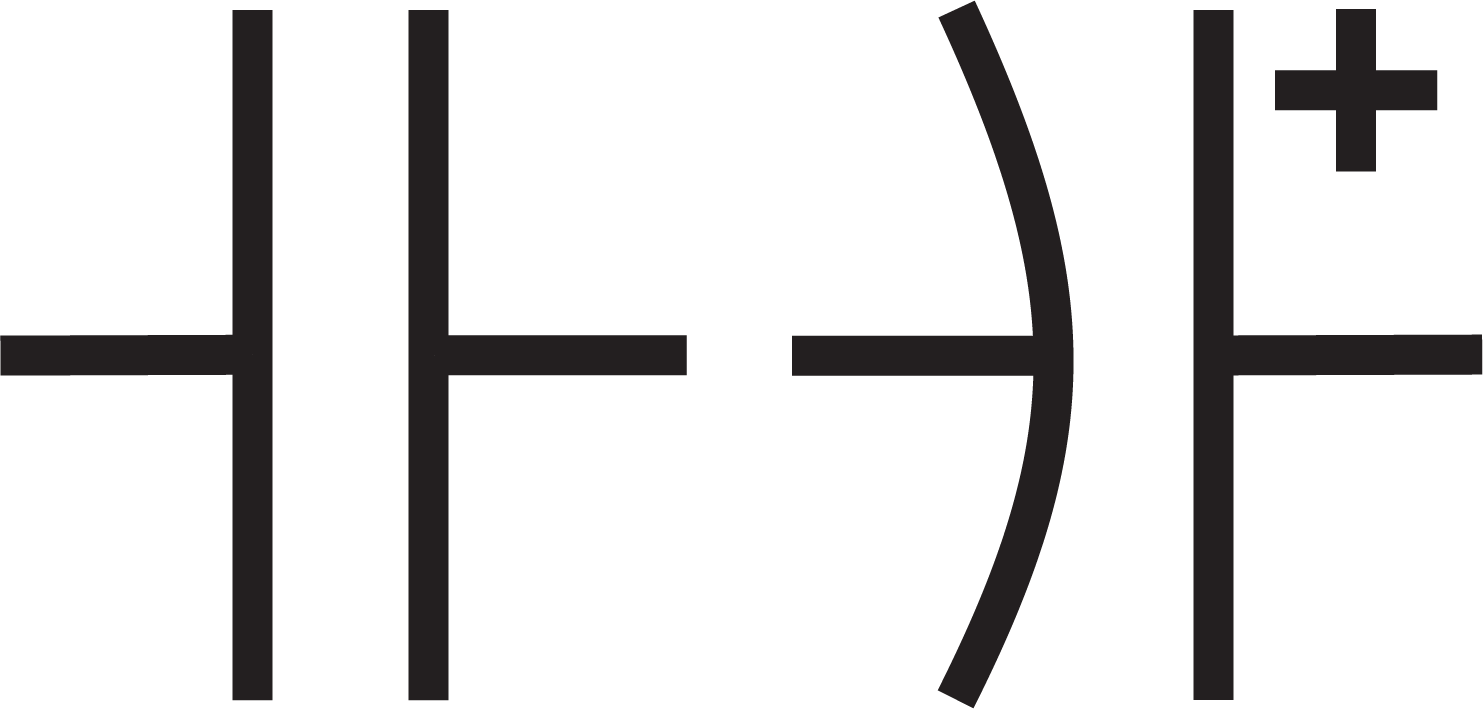

The two schematic symbols associated with capacitors are pictured above. The less complex one on the left is for non-polarized capacitors and the more complex one on the right is for polarized electrolytic capacitors.

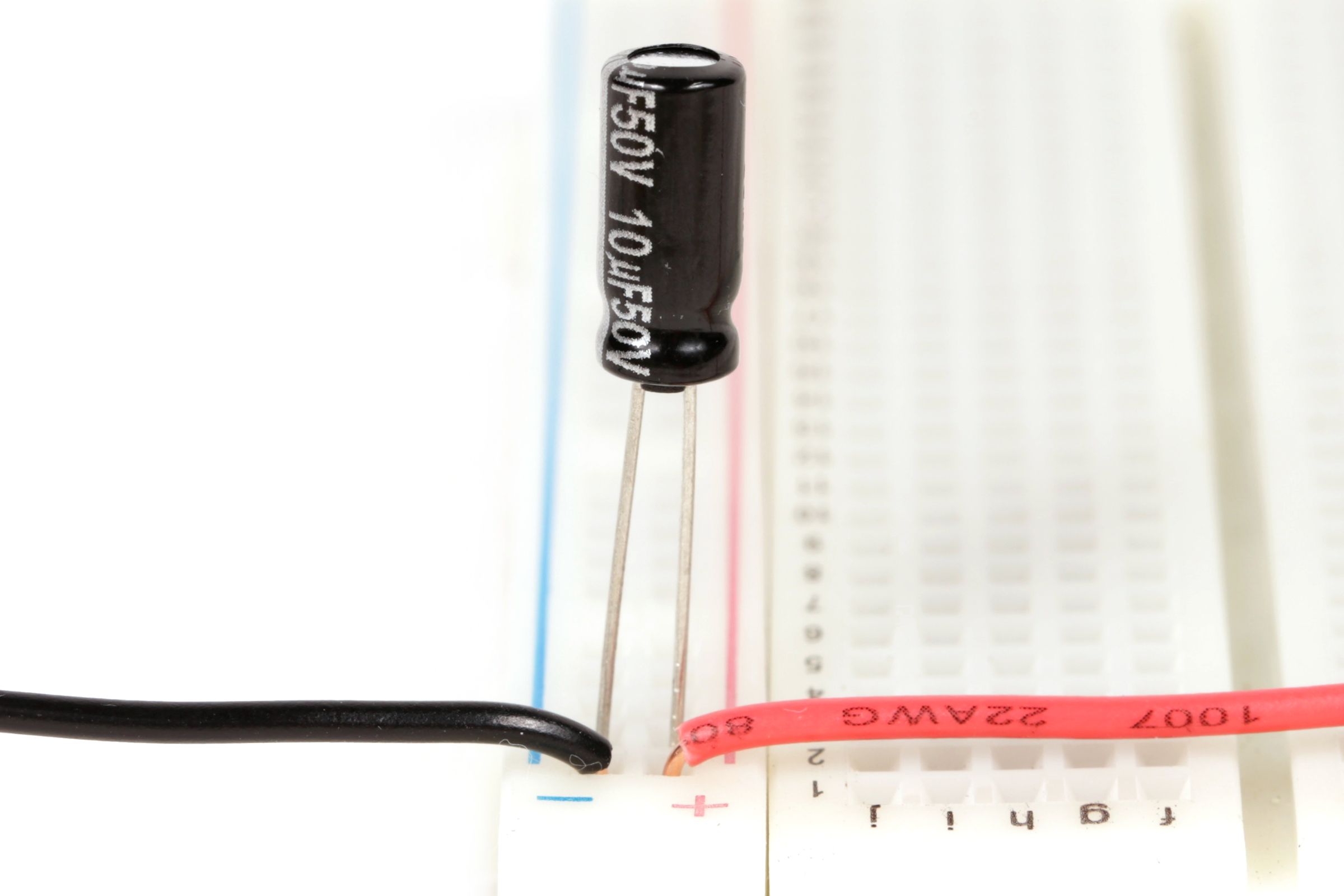

Capacitors can be either polarized or non-polarized. Put simply, a polarized capacitor has a positive lead which needs to be connected to power, and a negative lead which needs to get connected to ground. Nonpolarized capacitors can be connected any which way.
Ceramic disc and mylar film capacitors are non-polarized.
Electrolytic capacitors are polarized.

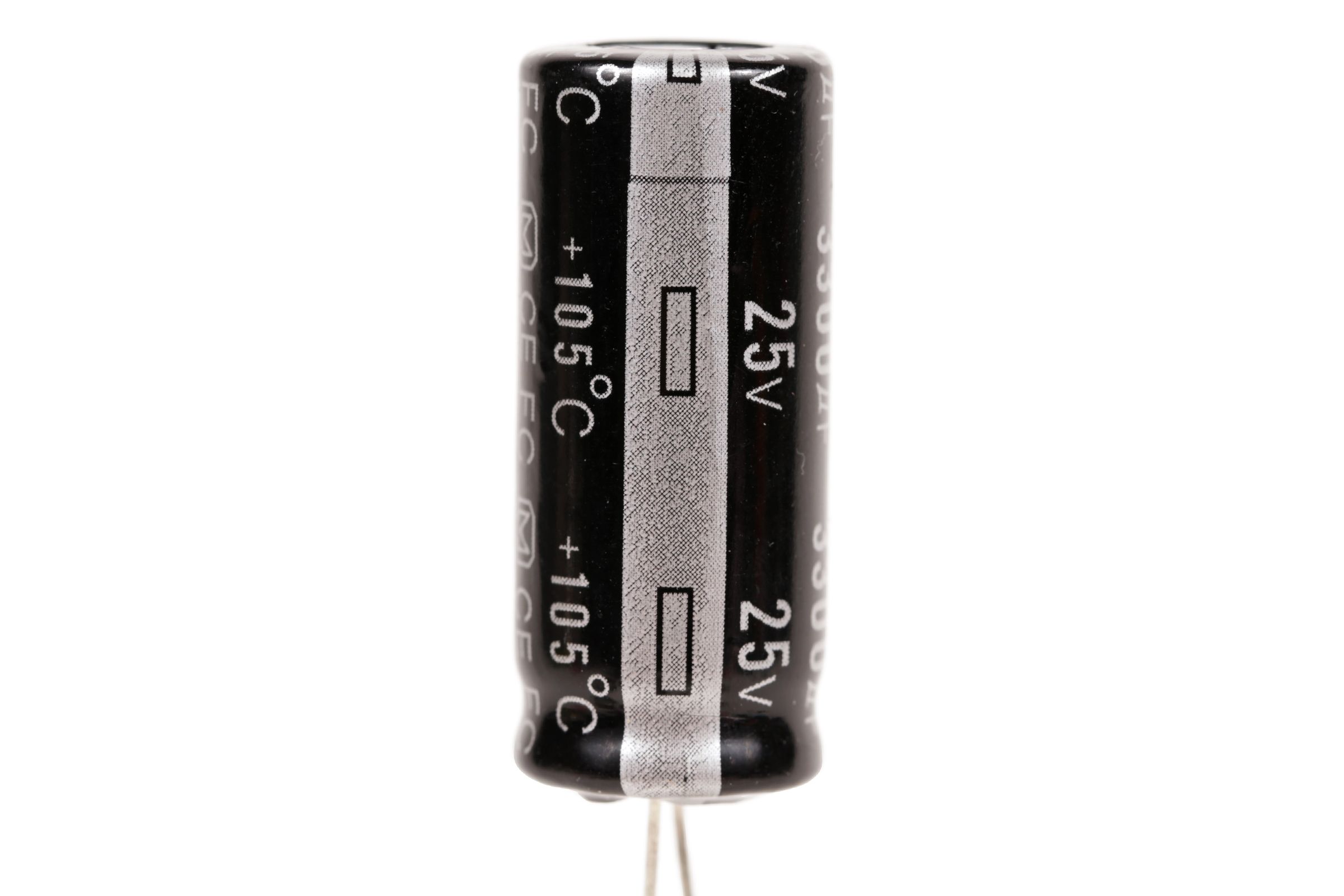

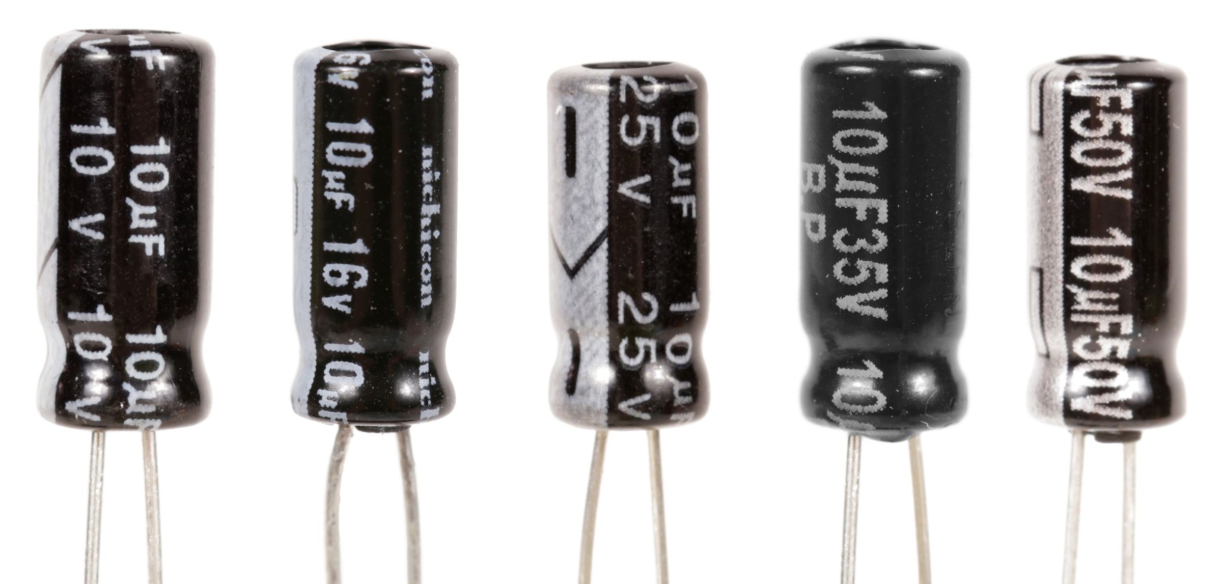

Reading electrolytic capacitors is a bit easier. You just literally read them. They have their capacitance and voltage rating printed directly upon them. We have yet to touch upon voltage rating. Suffice it to say that the voltage rating is only important in that your supply voltage should never exceed it. This is unlikely for the type of electronics we are doing.
On electrolytic capacitors, the most important thing to pay careful attention to is the stripe marked with a minus sign indicating the capacitor's negative lead.
