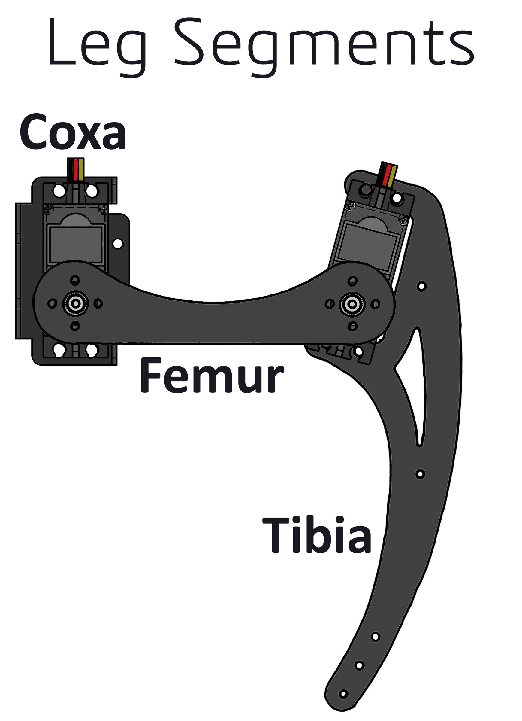

Step 2: Anatomy of a Hexapod
Before we get to actually building the hexapod, it will be useful to establish a naming convention for the different parts of the robot. The robot has three segments on each of its six legs and three servos for the joints between the leg parts. The naming scheme we will use for the different parts of the legs will be analogous to the arthropod leg.
The leg segment closest to the body will be called the coxa. In our build, the coxa is a servo bracket assembly we will start building in the next step. The second leg segment is the femur. The third leg segment, the last one on each leg, is the tibia.
The servos will be named according to the leg segment they move. The servo that attaches to the body of the hexapod is the coxa servo. The servo that lifts and lowers each leg is the femur servo. The servo that allows the legs to bend in the middle is the tibia servo.

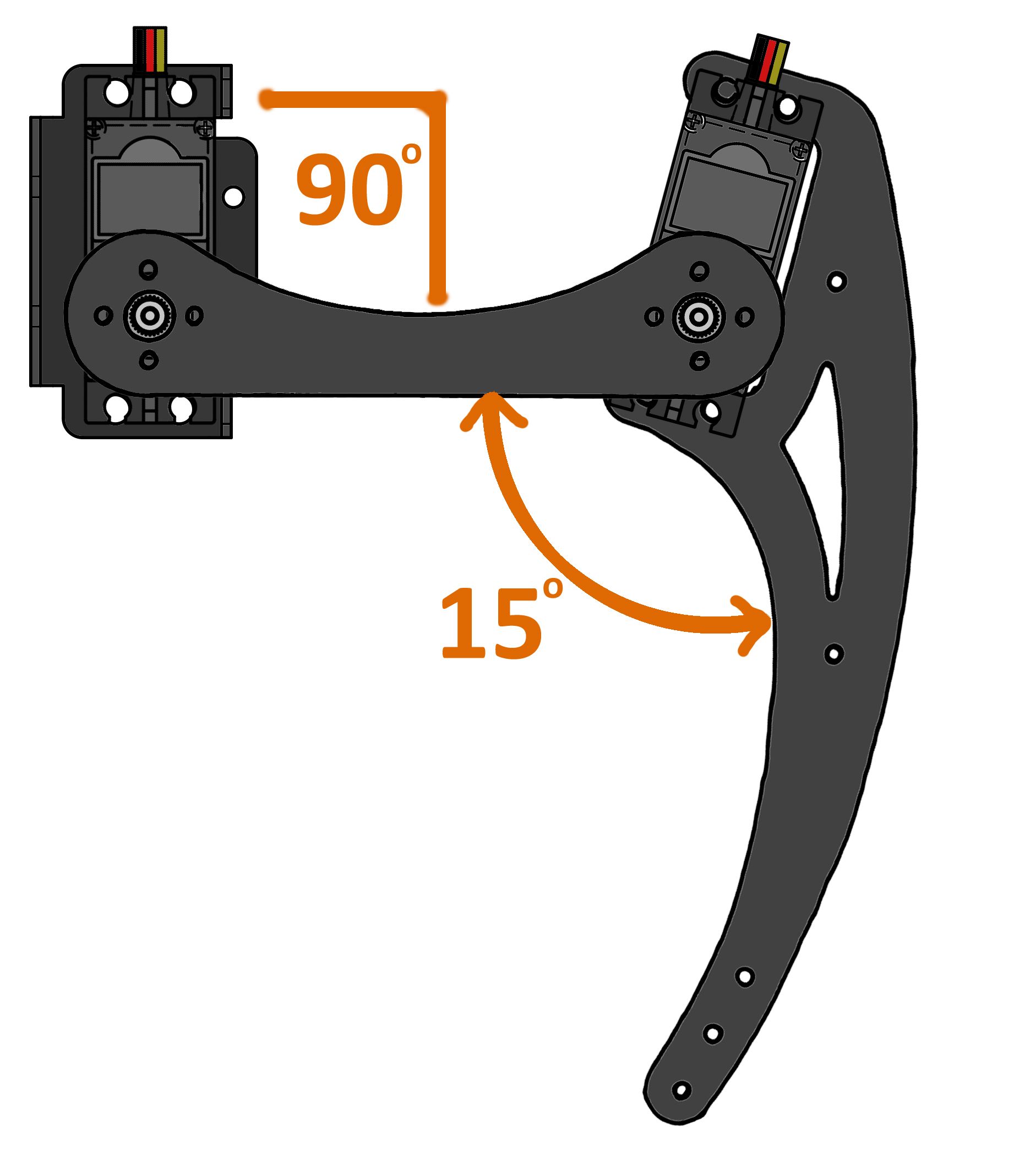

Next we need to connect the servo horns to the femur so that, after the next step, we can assemble the legs. The Hitec HS-645MG servos actually come with a few different horns in the box. The ones we will use on the Capers II robot are the white circular horns that may have come pre-installed on your motors.
Each of the femur parts needs two servo horns. Unlike every other part of the robot, we do not need to worry about building the femurs in mirrored pairs because they are symmetrical anyway.
Attach a servo horn onto each side of each femur using four M2.2 thread-forming screws on each servo horn.

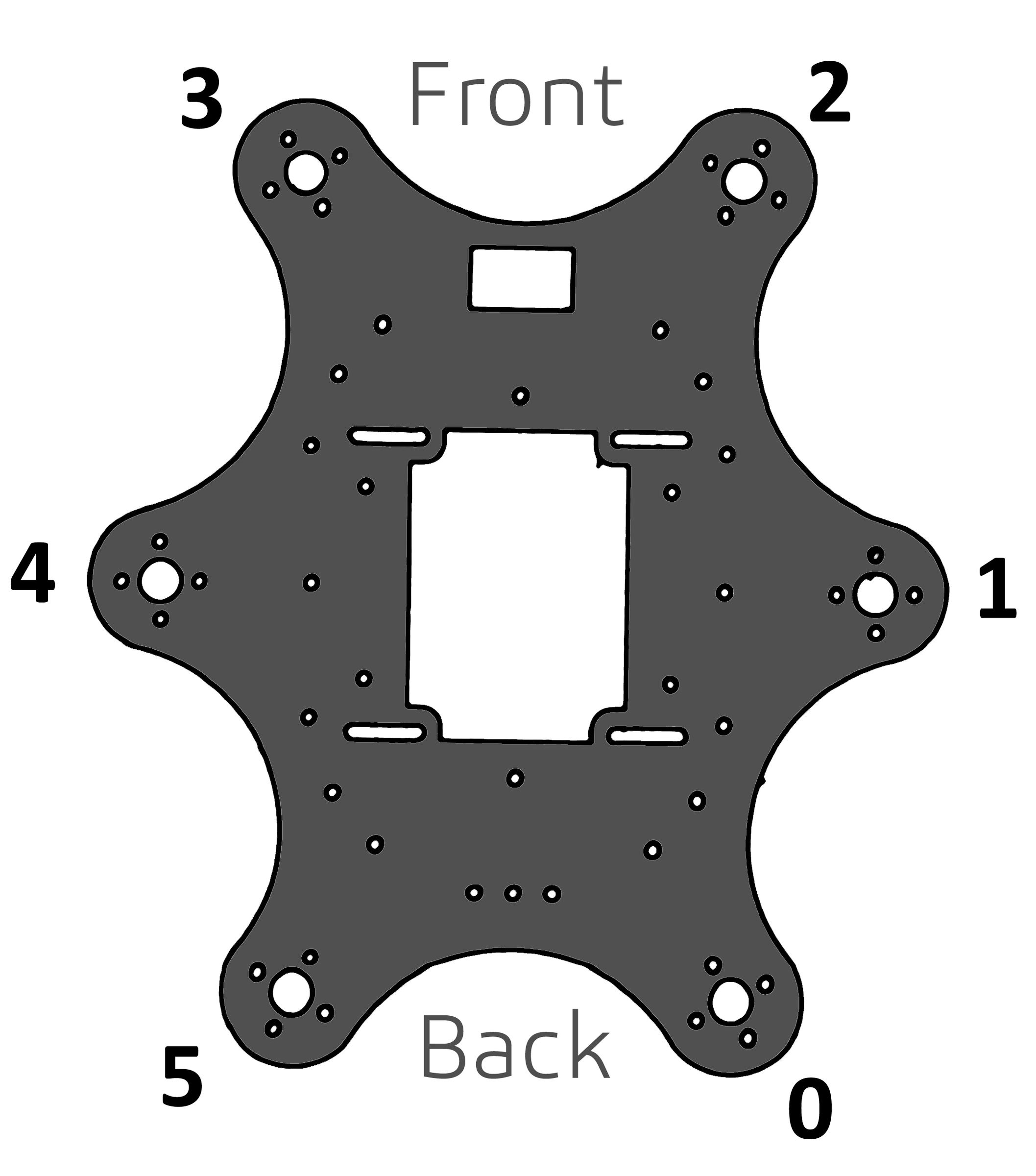

Step 9: Attach Servo Horns and Standoffs to the Upper Chassis
Now that the legs are all fully assembled, we will set them aside briefly while we turn our attention to the hexapod's chassis. In this step, we will accomplish two related tasks before we start working on the electronics.
First, six servo horns will mount onto the upper chassis piece in the same way the servo horns were mounted onto the femurs. Using a pair of M2.2 x 5mm thread-forming screws, attach six servo horns to the part.
Second we will attach the six M3 x 50mm screws to the upper chassis piece in preparation for mounting the lower chassis towards the end of this Instructable. There will be one standoff mounted near each of the legs.

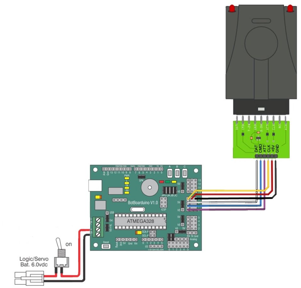

The next component to be added to the electronics stack is the controller. Before actually mounting the controller on top of the Botboarduino, we need to connect the receiver electronically - and we will also be adding a few other electrical connections as well.
Connect the Controller Receiver
The controller receiver comes with a set of pin-terminated wires in the box. There are six connections on the receiver. On the Botboarduino, the receiver connects to the 6-9 block of pins:
  • Receiver GND to Botboarduino pin 9 GND
  • Receiver 5V to Botboarduino pin 9 5V
  • Receiver CLK to Botboarduino pin 9
  • Receiver ATT to Botboarduino pin 8
  • Receiver CMD to Botboarduino pin 7
  • Receiver DAT to Botboarduino pin 6
With the electrical connections made, we can mount the controller receive on top of the Botboarduino. First, add a nylon nut on top of the two nylon standoffs on the side of the Botboarduino with the screw terminal. On top of these nuts, add two [add length]mm nylon standoffs. On the side of the Botboarduino opposite the screw terminal, add two [add length]mm nylon standoffs. Place the controller receiver on the two standoffs on the screw terminal side of the Botboarduino. The receiver should fit snugly into place with the end of the receive itself nestled next to the wires we've already plugged in.

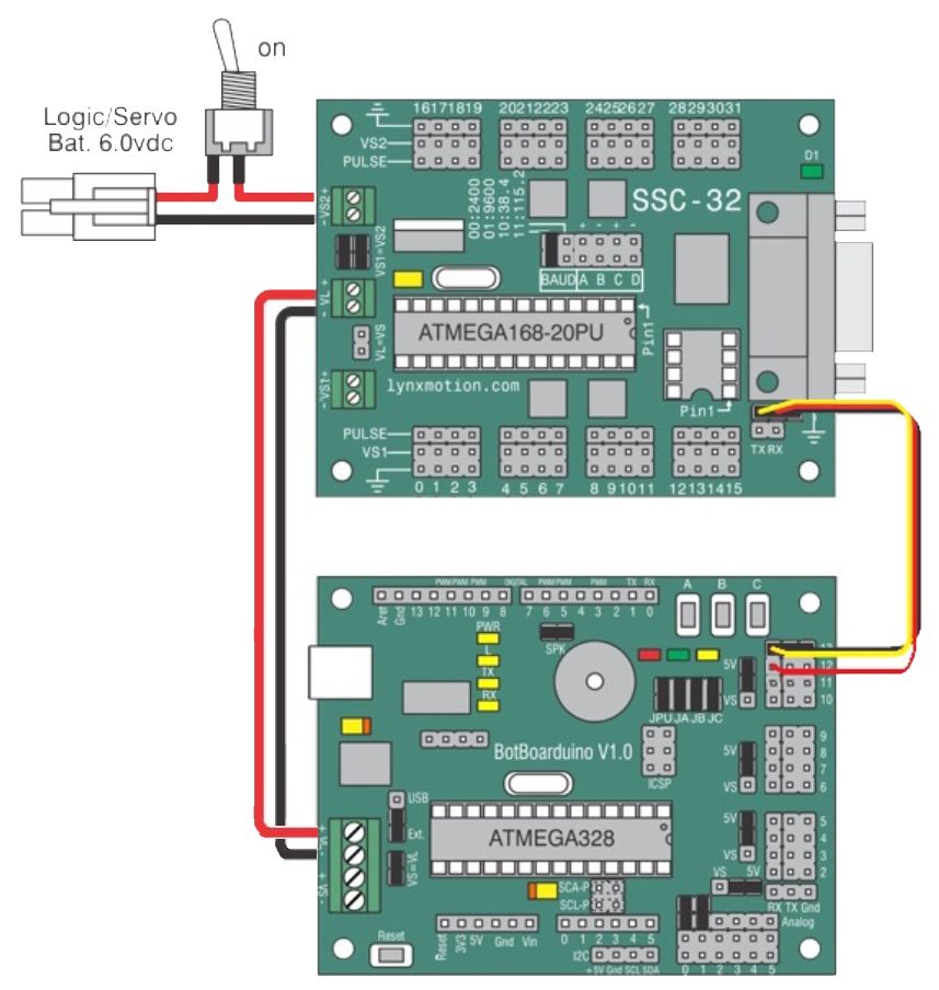

Step 15: Add the SSC-32 Servo Controller
Our stack of electronics will be topped off by the SSC-32 servo controller. The SSC-32 simply mounts on top of the standoffs added to the stack on top of the controller receiver. Orient the SSSC-32 so that the screw terminal on the SSC-32 is on top of the screw terminal on the Botboarduino, because we will be connecting these screw terminals together. Fasten the SSC-32 in place using four nylon nuts.
With the SSC-32 in place, we will make a few connections using the wires we installed on the Botboarduino earlier. First, power from the battery will be connected directly to the SSC-32 - we will do this in the next step. Then, the SSC-32 delivers power to the Botboarduino. We already have wires installed on the VL screw terminal on the Botboarduino. Attach the other end of this wire to the VL screw terminals on the SSC-32.
Next we need to connect the Botboarduino and the SSC-32 together so that they can communicate with each other. We already have three wires installed on the Botboarduino. These wires connect to the RX/TX/GND pins in the middle of the SSC-32.

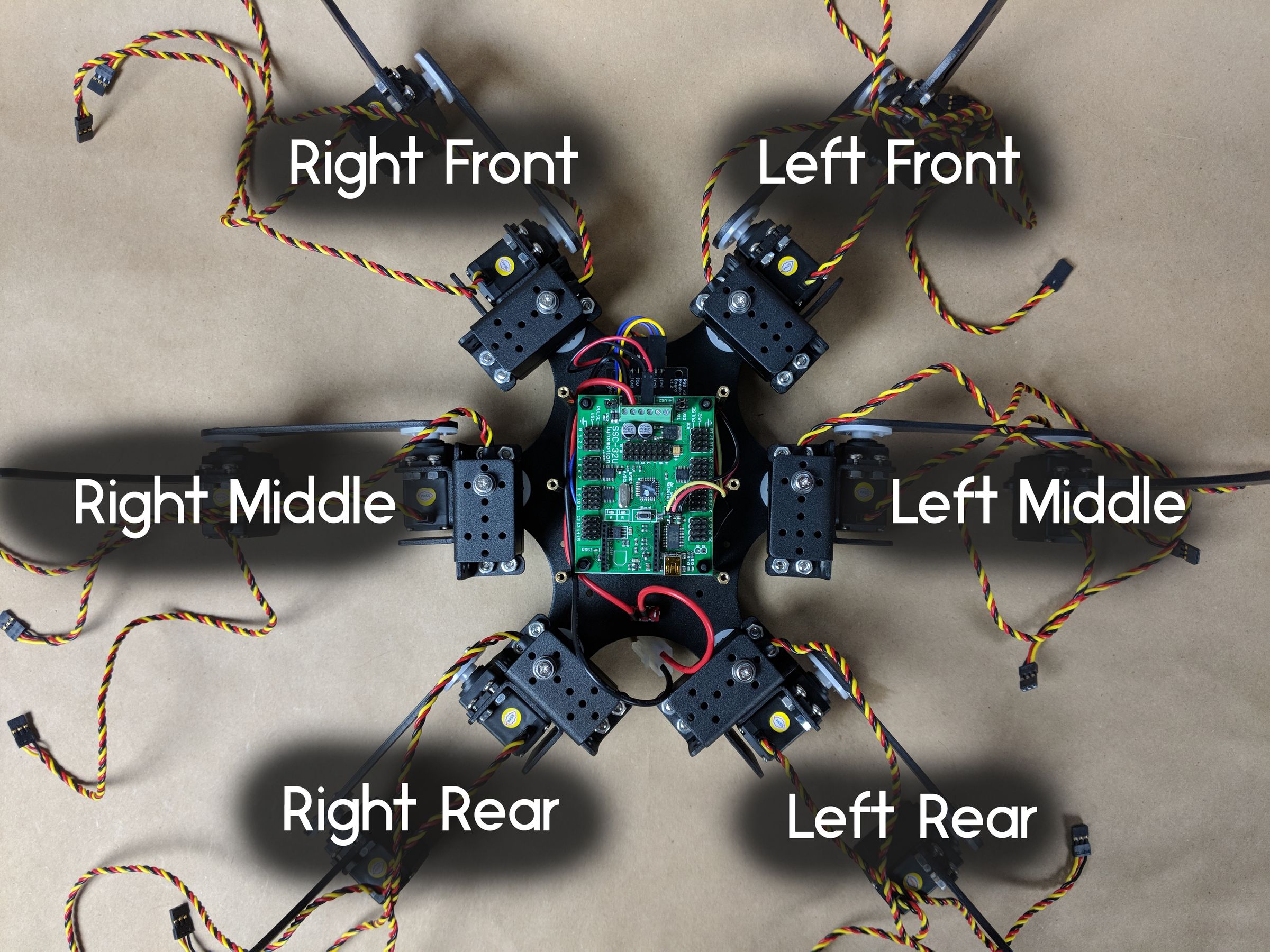

Step 18: Attach Servos to the SSC-32
All 18 servos on the hexapod connect to the SSC-32 servo controller. The Botboarduino then issues commands to the SSC-32 to move the servos to angles calculated by the inverse kinematics algorithms that constitute the bulk of the Capers II code.
The SSC-32 has a row of servo connectors on each side of the board. These servo connections are grouped in blocks of four rows each. Each leg connects to a different block. The pin numbers for the servo connections are defined in the code.
There is one tricky aspect to connecting the legs. In order to actually make the connections, you need to turn the robot upside-down. This means, that when you are looking at the robot from the side with the switch closest to you, the right servos will actually be on the left side of the robot.
Each row of connectors has three pins: ground, signal, and 5V. Connect the servo cables with the black ground wires towards the outside of the board.

To use servo offset mode, first plug the Botboarduino into your computer via USB. The USB cord can reach the port on the Botboarduino through the front two legs. With the robot connected to your computer, turn on the switch and open Serial Monitor in the Arduino IDE. When the robot starts, you will be presented with some instructions in Serial Monitor. To enter servo offset mode, send "O" to the hexapod.
Once servo offset mode starts, you will again be presented with some options. The first step is selecting a leg. All six legs are designed by a number in the code:
  1. Rear Right
  2. Middle Right
  3. Front Right
  4. Rear Left
  5. Middle Left
  6. Front Left
To select a leg, send the leg number, along with servo designator over Serial. You can specify the coxa servo with "C," the femur servo with "B," or the tibia servo with "C." Once you have a leg selected, send "+" or "-" over Serial to increase or decrease the servo zero position.
