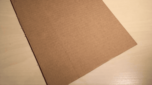

- Cardboard

First, I made patterns to cut the shapes out of the cardboard. No need to explain how to cut these patterns, just use the appropriate tool.
