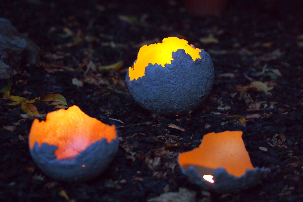

A fun and easy project to try with concrete is to make Concrete Balloon Candle Holders. This is a great project to get your hands dirty and make something simple, yet very cool.
