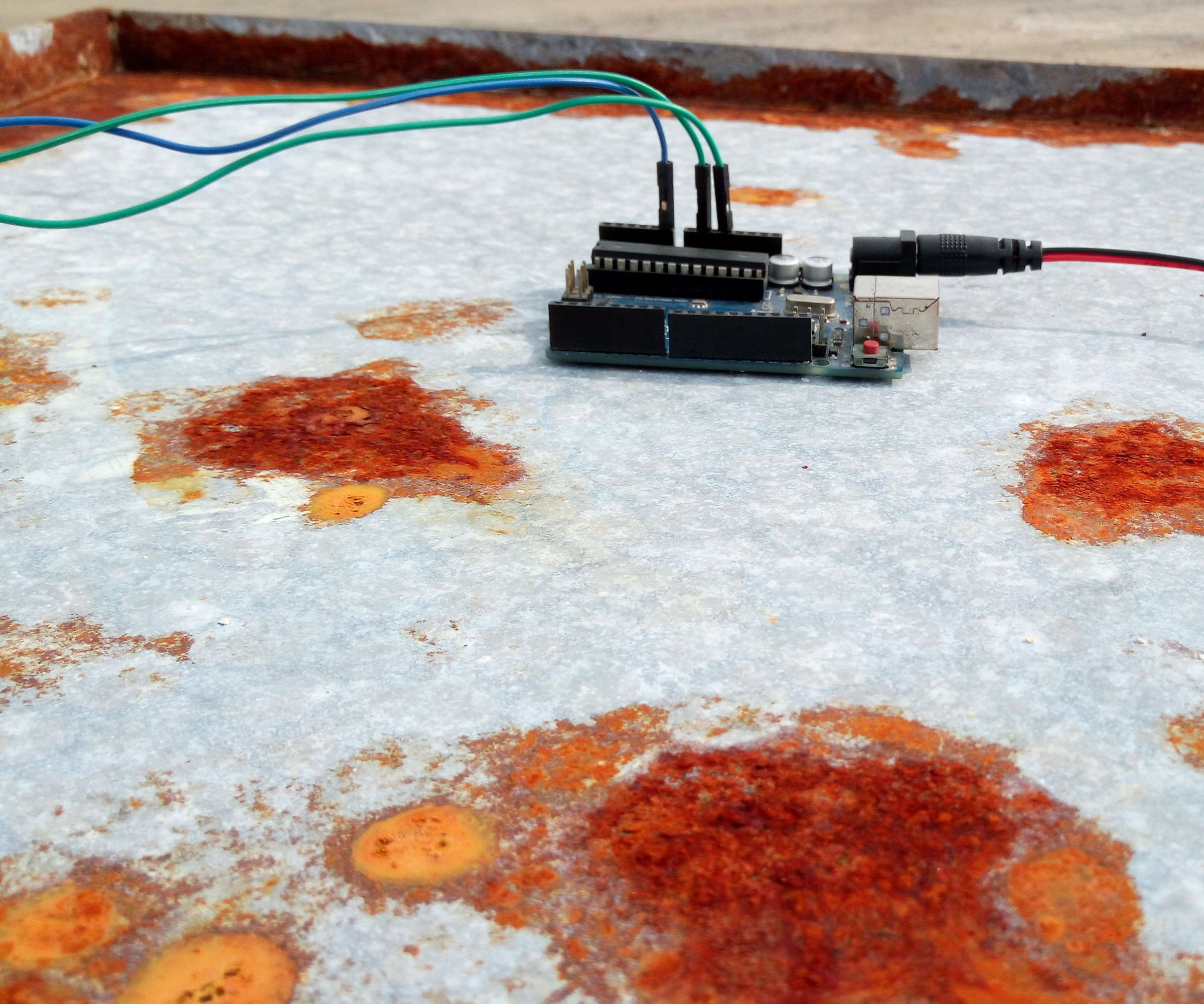

Interfacing LM35 to Arduino by Connecting the temperature sensor to board Connect the +Vs to +5v on your Arduino board. Connect Vout to Analog0 or A0 on Arduino board. Connect GND with GND on Arduino. The Analog to Digital Converter (ADC) converts analog values into a digital approximation based on the formula ADC Value = sample * 1024 / reference voltage (+5v). So with a +5 volt reference, the digital approximation will = input voltage * 205.
What's Connected
Arduino UNO,Temperature Sensor LM35,Wires for connecting it
