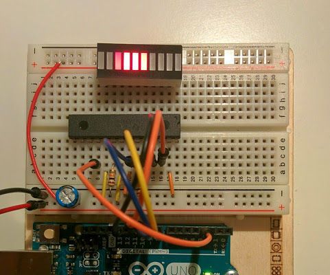

Step 2: Wiring It Up
In the schematic I have described how to connect all the components using an Arduino Uno board and a mini breadboard.
- The ESP's VCC pin is powered by the 3.3V output pin of the voltage regulator (AMS1117 in my example). The 10uF capacitor is connected to the output pins to stabilize the regulator. The CH_PD pin must also be connected to 3.3V. The GND pin is obviously connected to ground.
- The ESP's TXD pin can be connected directly to the RX pin of Arduino (emulated on pin 6).
- The ESP's RXD pin is connected to the TX pin of Arduino (emulated on pin 7) through the level shifter.
If you are using an Arduino Mega you need to change the wiring schema an connect the ESP TX/RX pins to the Arduino Serial1 pins. This allows to have a more fast and reliable communication link between the Arduino board and the ESP-01 module.

The picture is quite clear about what I have achieved.
