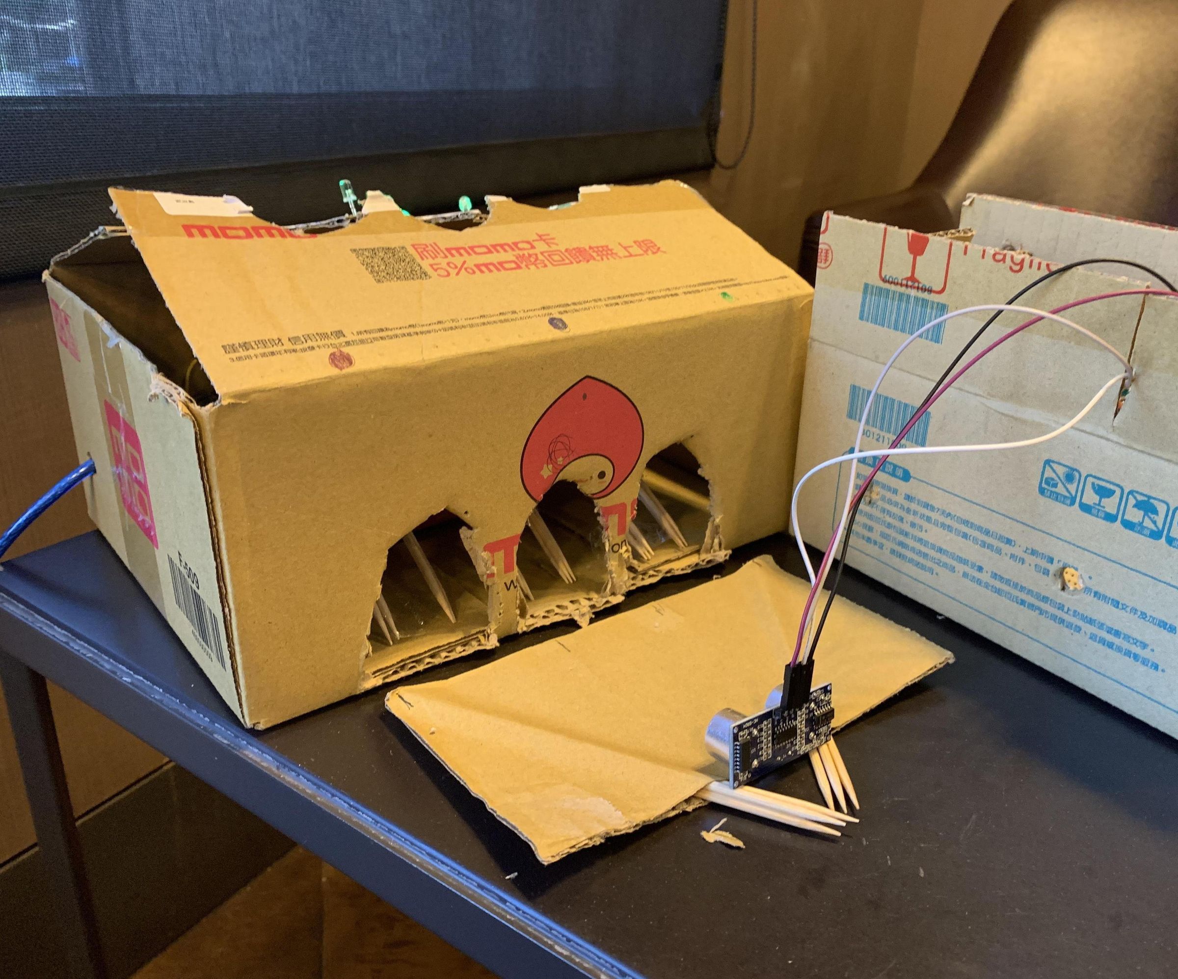

以簡單的裝置及易懂的規則為主要設計概念,搭配scratch小遊戲,設計出有創意和意義的裝置。
操作方式:
利用筷子,根據燈泡顯示出來的顏色,將所對應的物品投入相對顏色的孔洞。scratch小遊戲則會與病患互動
作品特色:
加入燈光效果使老年人能更清楚指令,同時配合scratch小遊戲增加遊戲趣味,並以簡單的操作方式搭配日常生活用品(筷子),增添便利性。

Step 1: Type the Code
Step 2: Set Up the Bread Board
Step 3: Set Up the Appearance
Step 4: Scratch Coding
Connecting the device with scratch, would enhance the challenge of the game, which further provide a better atmosphere.
將此裝置連接至 Scratch,增加遊戲趣味性,進而增進復健效率。
Step 5: Enjoy the Game
1. prepare a pair of chopsticks
2. starts the device and scratch
3. look at the color of the light and put the ball in the selected hole
4. play until the winner is out
