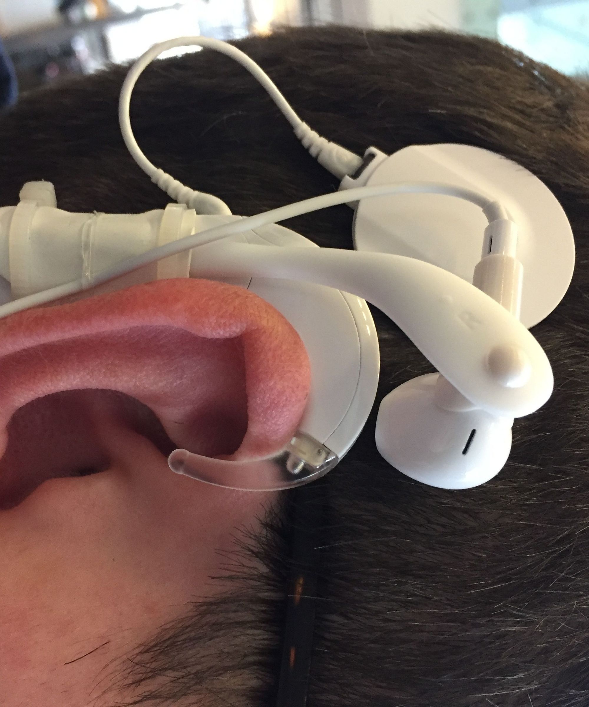

Since cochlear implant microphones sit above the ear, and the user does not hear through their ear canal, users have traditionally been unable to use AirPods. These are instructions for attaching earbuds to bilateral MED-EL Sonnet cochlear implant processors in such a way as to direct the audio output into the cochlear implant microphones, allowing the wearer to utilize off-the-shelf AirPods. These AirPods are attached to the battery pack cover so they can be removed when not in use by switching out the battery pack cover. This makes them small enough to be carried in a pocket unlike over the ear headphones that are more common with CIs. Unlike a direct to audio cable the user can still hear ambient noise and conversation while using their AirPods. Since AirPods have a microphone built in the user can comfortably talk on the phone while wearing the AirPods. Basically it's awesome.

The AirPods have a sensor that will cause the music to stop playing if there is nothing in their immediate vicinity. It's a nice feature if the AirPod is going to sit in an ear, not so helpful if the AirPod is going to sit on top of a CI device. Use some white painter's tape to cover the sensors. (We used blue painter's tape, which you can see clearly in the photos.)
Step 5: Glue the Arms to the Battery Cover
Before gluing anything put the AirPods in the attachment arms so that you can ensure that the speakers are exactly where you want them, with the front edge of the speaker just over the front edge of the front microphone and the speaker flat against the top of the processor. Use the Double Bubble Non-Sag Red Epoxy to make a firm hold, which will take about 10-15 minutes.
