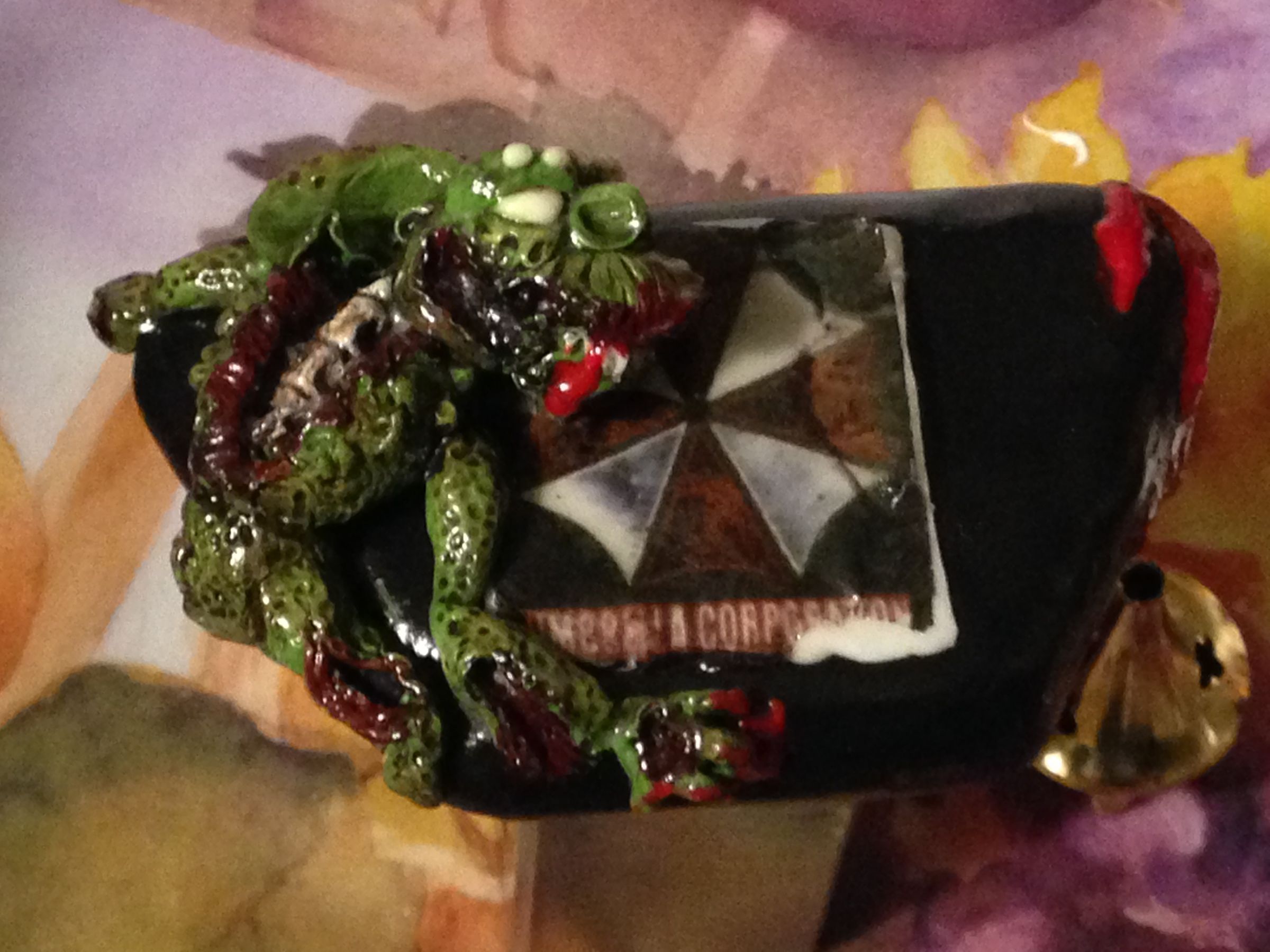

Step 1: GUO Head
Refer to the pictures for sculpting the head.
Additional Notes and Comments -
Roll a piece of aluminum foil into an egg shape and cover with a piece of flattened clay. I wish I had created a more narrow head. If I had to do it over again, I would have probably started with the body then sculpt the head based on the body size.
Roll out pieces of clay to build up the face and blend the seams. I used Fimo clay for the face. It was firm enough so that the details were not accidentally smooshed. Roll pieces of the clay to build up the chin and create skin folds.
The picture shows a tongue added. I later removed it to add a much longer tongue.
The teeth was created by creating indentations with a modeling tool. However, I later modified the teeth to make them sharper. I should have rolled conical small pieces of the teeth and add it to the face at this point
The antlers were created around a wire for better support.

Step 5: Painting the Sculpture
Refer to the pictures for painting.
At first I began painting without priming the scultpure and had terrible results - paint didn't adhere smoothly. I first tested the Games Workshop Chaos Black Primer on a small model to make sure it didn't adversely affect the painting.
Prime the entire model with Games Workshop Chaos Black primer.
Base coat the model with Stracken Green. I did not base coat the mouth, tongue, antlers, or the opened wounds and left them black.
Base coat the spine with Bone.
Base coat the antlers with White Scar.
Base coat the tongue and intestines with Screamer Pink. Mix some White Scar with the Screamer Pink for different parts of the intestine.
Add some Blood for the Blood God to the gaping wounds.
Wash the entire scultpure with Agrax Earthshade and allow to dry completely.
Dry brush some Orgryn Camo to the raised areas of the skin.
For the pustules, first add Cadian Fleshtone to the top of the pustules. Then add the Screamer Pink around the base. Add Blood for the Blood God around the base of the pustule.
Add Nurgle's Rot to the open wounds, pustules, intestines, and around the spine for running pus.
Add additional Blood for the Blood God around the wounds and mouth.
Wash the entire scultpure again in Agrax Earthshade.
I added varnish to the entire sculpture for protection.
Later I looked at the scultpure and decided to fix the teeth. Because the sculpture was already painted and varnished, I used cold porclenain clay for the teeth, then washed it with Agrax Nightshade.

Step 9: Assembling the Lamp
Cut a round piece of cardboard to fit on the flat bottom part of the bowl.
Flatten a piece of clay and cover the cardboard.
Roll 3 long sausages of clay. Place the lamp piece on the clay and place the long sausages around the contour of the lamp piece. I stacked 3 of the sausages of the clay until it reached the desire height. The clay was placed in a sort of U shape to accomodate the lamp cord.
Bake the clay.
Turn the glass bowl upside down and glue the clay piece to the flat side. I used Gorilla Glue for this.
Glue the lamp piece to the clay (refer to picture). I used 5 minute quick cure epoxy to glue the lamp piece.
Add some epoxy around the indentation of the sculpture base and glue the inverted glass bowl. Make sure to fit the glass bowl into the indentation. Add some additional glue or silicone to further seal the edge of the bowl to the base.
Finally I took some cold porcelain clay, mixed black acrylic paint with it and covered the outside of the base to hide the glue. I have a link to cold porcelain clay in my other instructable.
Finished!
