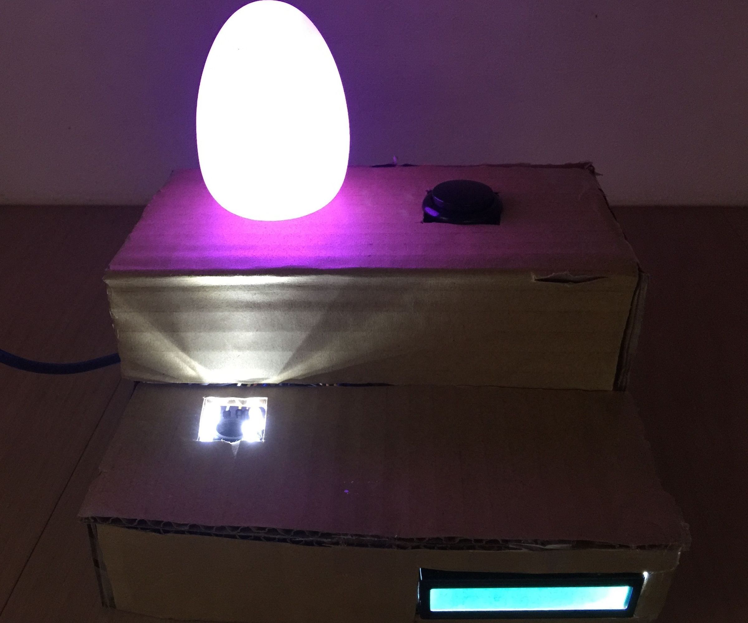

Step 3: Make a Container for Your Arduino
Measure the distance between your Arduino and the breadboard, and cut it out with a cardboard box. After bonding, place the component in.
The shell size:
- Length: 22cm
- Width: 21cm
- Height: 11cm
Step 4: Using Your Color Detection Paint Machine
Connect the USB cable to the Arduino and after the power is turned on, you can start using it!
Adjust the three colors you want (recommended to use three primary colors: red, yellow, blue)
Suggestion: the more color the better, the lighter it will be unclear
If you want purple water, choose the bright purple object to sense, then it will mix blue and red together to become purple.
If you want green water, choose the bright green object to sense, it will mix blue and yellow together to become green.
