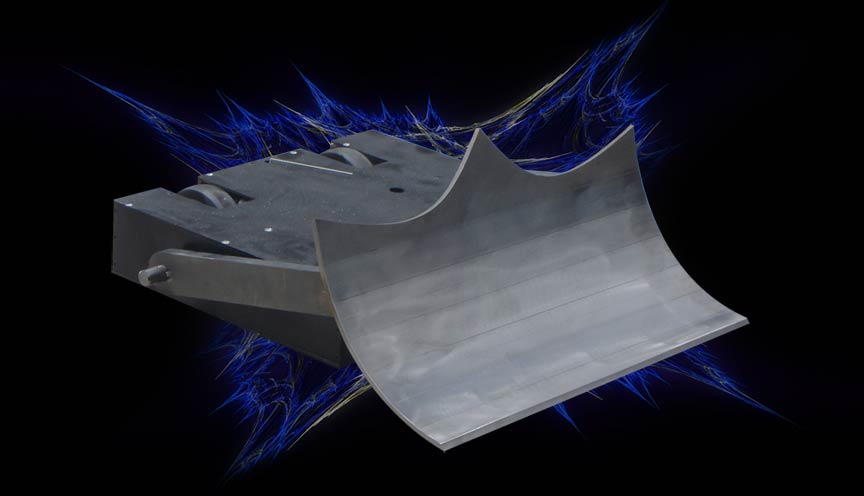

1. Wedges- Simple, few moving parts, it's a fact wedges win
2. Rammers- Need a lot of power, more expensive than a wedge do to the larger batteries and motors. If you build a rammer make it fast and make sure it accelerates quickly, your arena isn't that large.
3. Plows/Scoops- Both effective, scoops start shallow the shoot almost straight up like on Breaker Box, you can make a nice 'spinner killer' with these.
Check out wikipedia for a more in depth list.
I would suggest a wedge to any newcomers. They are successful and simple, therefor easy to build. If you must incorporate an active weapon then go for a servo operated lifter.

Step 11: T.O.D- My Robot
T.O.D stands for Thing of Destruction. I think it's a rather clever name that will scare the opposition away. I used a dicarded tin for the chassis and bolted everything else on. In order to save weight I drilled holes in the top armor.
TOD was fairly cheap to make
Transmitter and reciever- 50 dollars
Motors- 20 dollars
Bolts and Screws- 10 dollars
Armor- 20 dollars
Chassis- Free
Wheels- Free
Battery- Free
ESC- 60 dollars
Overall about 110 dollars.
