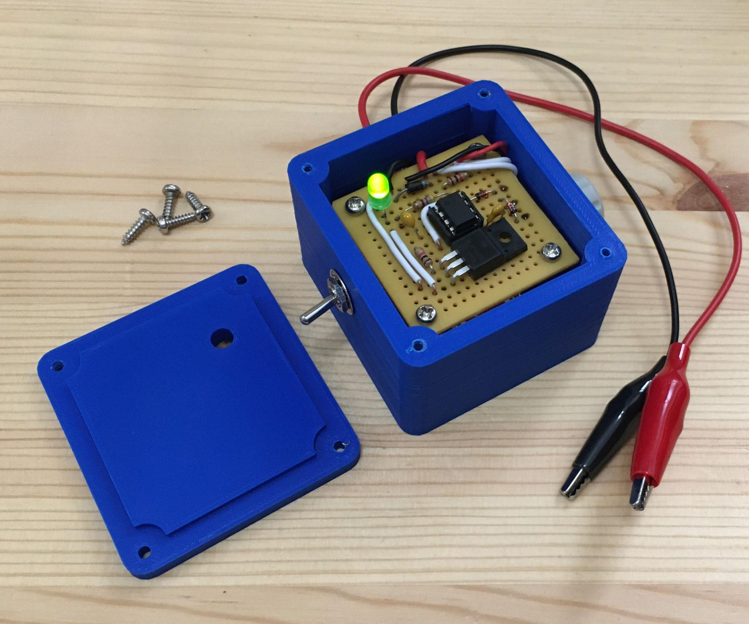

Step 6: Assemble the Circuit Board
With your new board etched, you can now begin soldering everything together. Use the diagram in the previous step as a reference. If you are creating Circuit 1, you will need to use "ON 1" and "OFF 1" in the diagram. You will also need to attach a 1N4001 diode to "OFF 1", even though it isn't shown in that diagram. If you are creating Circuit 2, you will need to use "ON 2" and "OFF 2". In this case, you should attach the diode to "ON 2". (If you are unsure about where something goes, refer to the main schematics in Step 4.)
Although the soldering is pretty straightforward, be very careful not to accidentally merge the traces. They are a little too close together on this board because I had no prior experience in PCB design. Next time, I will be sure to spread them out more. Also, notice that the LED is mounted on the underside of the board. This is done so that it will fit through a hole in the outer casing later on.
When you have finished soldering, check for short circuits using the continuity setting on your multimeter. Test pairs of adjacent contacts that are not directly connected. If any pair shows approximately zero ohms of resistance you probably have a short circuit. Look closely at gap between the contacts and remove any particulates that you can see. Finally, provide power to both circuit boards and test it out. Fingers crossed!

Next, determine how you want to arrange the components inside of the housing. Once you know that everything is going to fit, wire the components together according to the diagram above. Place the latching circuit in the housing first, and make sure that LED fits through the hole you drilled. Secure it in place with hot glue. Do the same with the receptacle, making sure that the slots are properly aligned. Secure the remaining components, and liberally apply hot glue. You definitely want to cover the relay contacts, the receptacle wires, and the back of the prongs since these will all be carrying high voltage AC. Finally, make sure that no accidental connections are being made and temporarily the housing together with a bit of glue. I say temporarily because you don't want to close it all up, only to find out that you forgot to solder something.
Step 11: Test It Out
Now comes the moment of truth. Plug your circuit into a power strip or an extension cord (so you can easily cut the power if something goes wrong), and press the ON button. The indicator LED should light up and remain on. Press the OFF button and see if it goes off. Now plug an appliance into the receptacle and test it again. If everything is working, congratulations! Seal up the seam of the case with hot glue and you are finished. If it didn't work, don't despair. My prototypes failed more times than I can remember. Just keep working at it and you will eventually succeed!
