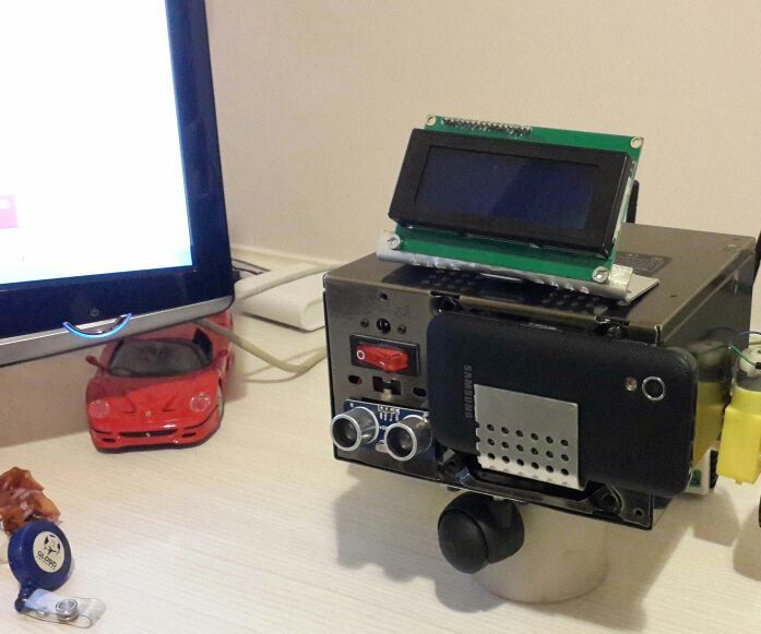

I always had problem to check my hardware while playing games, programming and etc... that is why I decided to make this Computer Monitor using Arduino; I called it Retrovisor (Rearview mirror in portuguese).
Using this you can check your CPU / memory usage, process running, stand by process, battery life and network usage without opening any screen on your computer.
For this I used an old font case, arduino Duemilanove, 4x20 LCD and node.JS.

And voilà, you are now monitoring your computer hardware using Arduino and Node JS.
