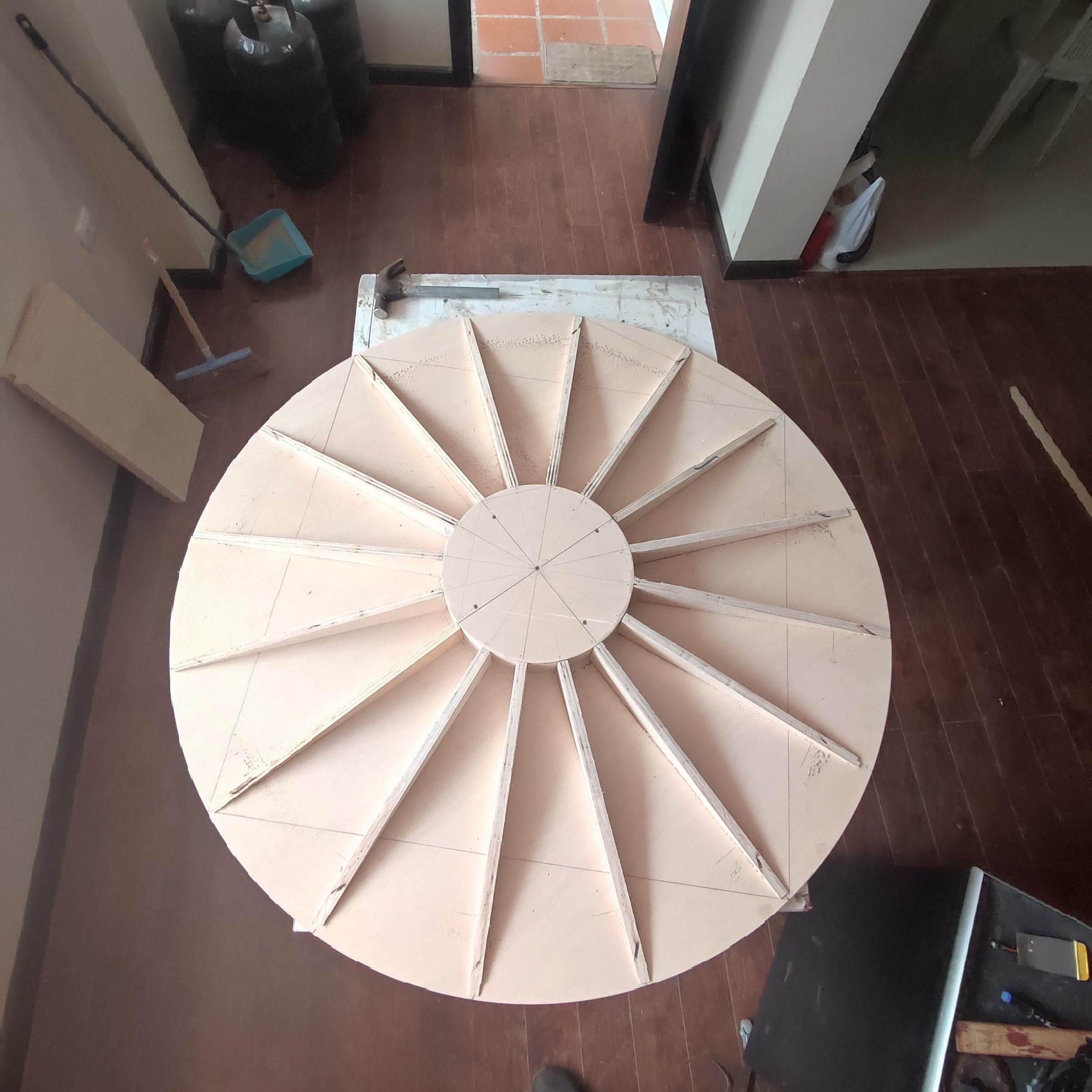

Now it's time to cut the 16 triangles that will form the ribs. Then, one by one, we will carefully place them on each of the marks we previously made (I forgot to do this, and indeed, it was harder to draw those lines now). We use glue, the brad nailer to hold them in place and then reinforce from the other side.

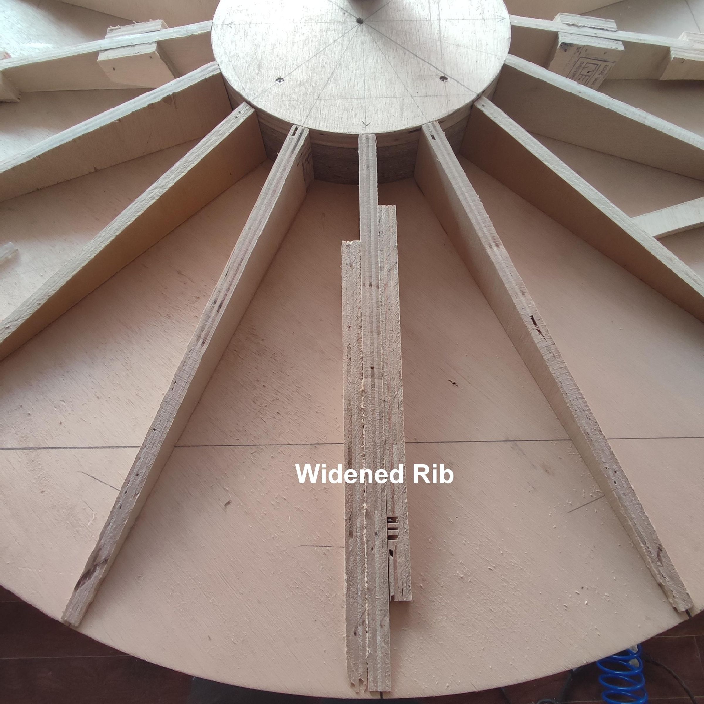

With the structure ready, we can begin to cover it with the flexible plywood panels. Using the template, I cut out the shape in paper and verified that everything would fit correctly. In theory, these panels are joined at their ends at 4 out of the 16 ribs, closing the entire circumference. These ribs are the ones that need to be widened so that when two panels are joined, they have enough surface area to support themselves. For this reason, I added some plywood scraps at these joining points.

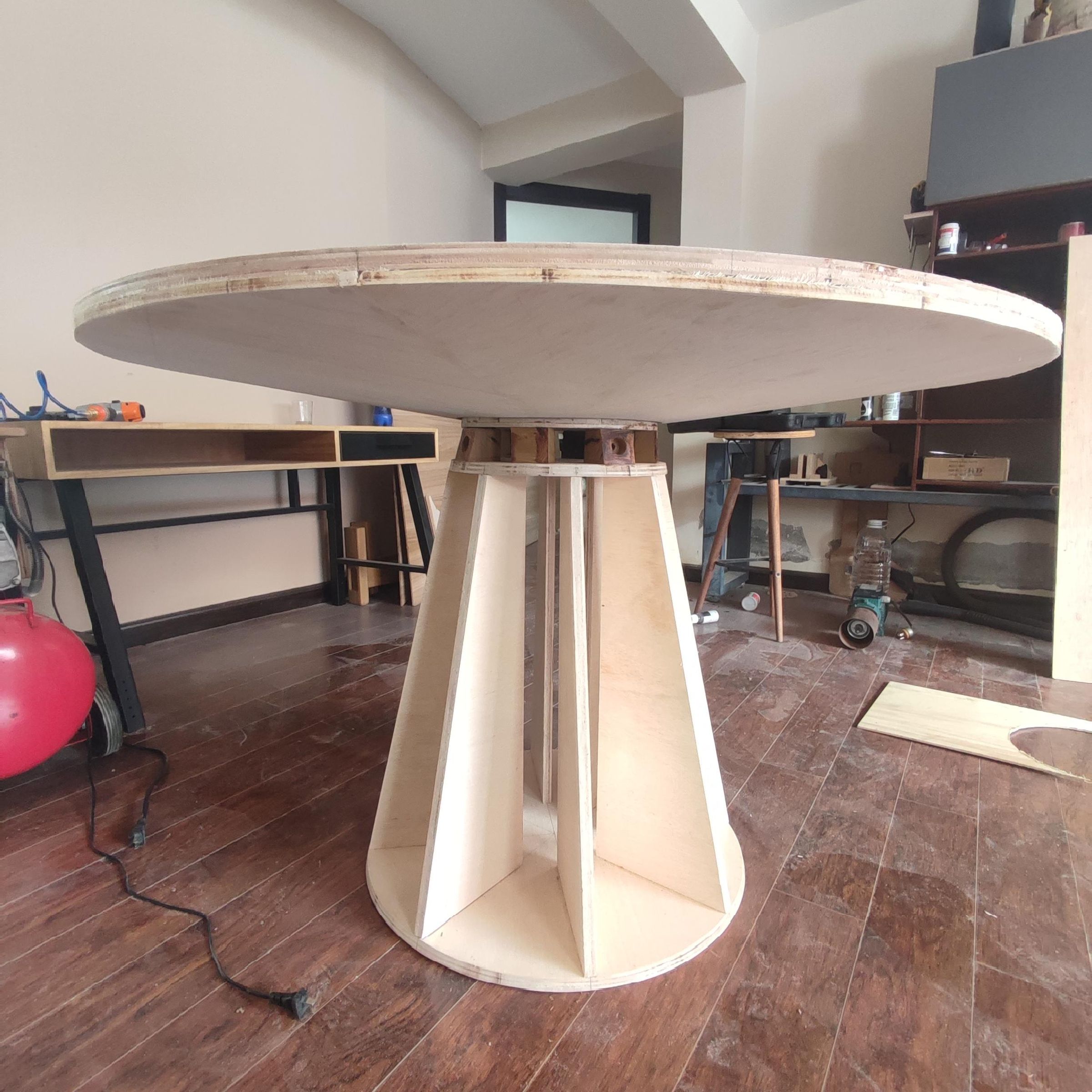

Step 4: Base Structure

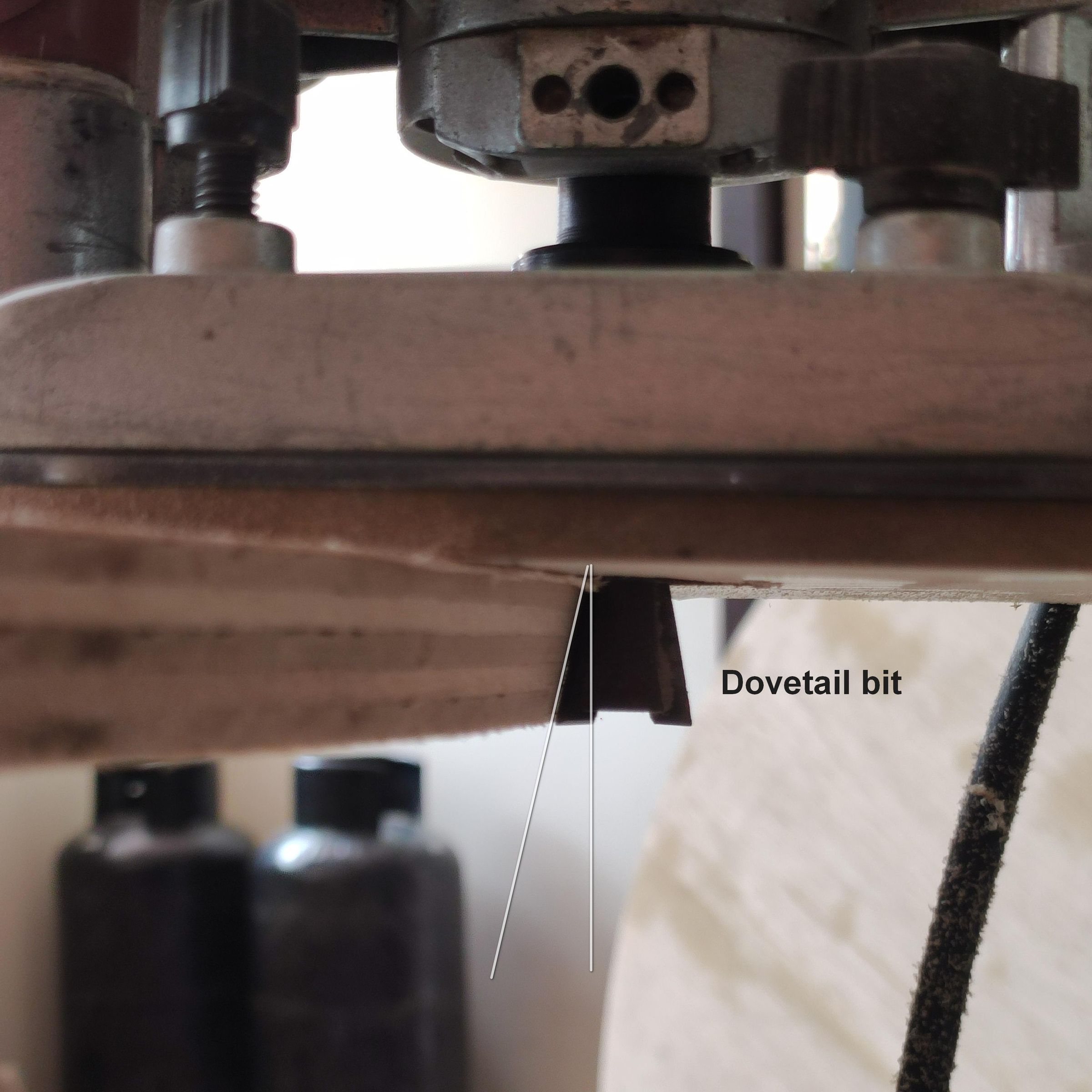

Now, we will continue with the base structure by cutting the 8 large ribs and the 3 circles that compose it: the base, middle, and top circles. There's no change in the procedure for the ribs; it remains the same as before. However, there is a slight modification required for the circles. Since these circles are internal and are surrounded by the flexible panels, they cannot have right angles on their edges; they need to have an incline to fit properly.
I solved this by cutting and shaping the circles to the specified measurements and then beveled them using a dovetail router bit. It happened to be a coincidence, but that angle adapted very well to the cone's shape.

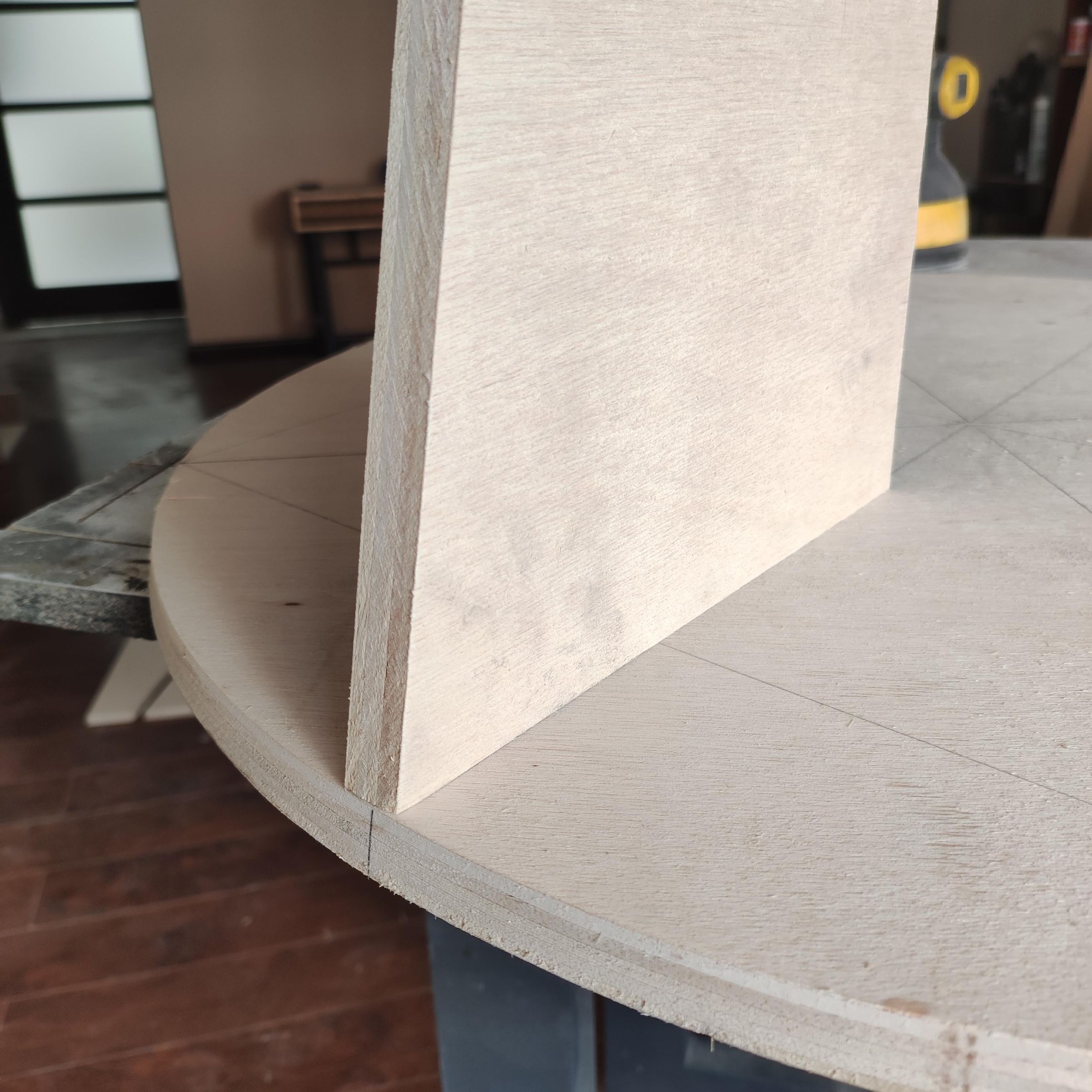

With these three circles ready, we can start assembling. Once again, the process is similar. I mark the location of each rib on the base and middle circles and secure each of these pieces in place. After fixing them with glue and nails, I also add some screws at both ends to provide additional reinforcement.
Step 5: Just in Case
After joining the base pieces, I thought it might need a bit more stability. So, I quickly cut these small trapezoids to fit between the ribs.
Step 6: Connection Blocks
Now it's time for the system that will allow the table to be separated and joined as needed. These connection blocks are essentially cubes that will accommodate the bolt, which will grip onto the L brackets anchored to the top part.
I made these cubes from hardwood, and they have a through 5/16" hole. On one face, they have another hole of a larger diameter to insert a washer. There are 8 cubes in total, 4 with holes and the other 4 without holes. They are placed on the middle circle following the same distribution as the large ribs, alternating one with the other.
These cubes must be securely fastened as they are an important part of the entire structure. Then, the last circle is fixed on top of these cubes, closing the entire skeleton of the base. Next, a new concentric circle is cut into this piece to create a ring. This way, the top part will have a place to rest, and it will also allow the L brackets to connect with the blocks.
It's worth noting that since the cubes are positioned between two circles, they need to have the same angle on one of their faces as mentioned earlier.
A preview so far.

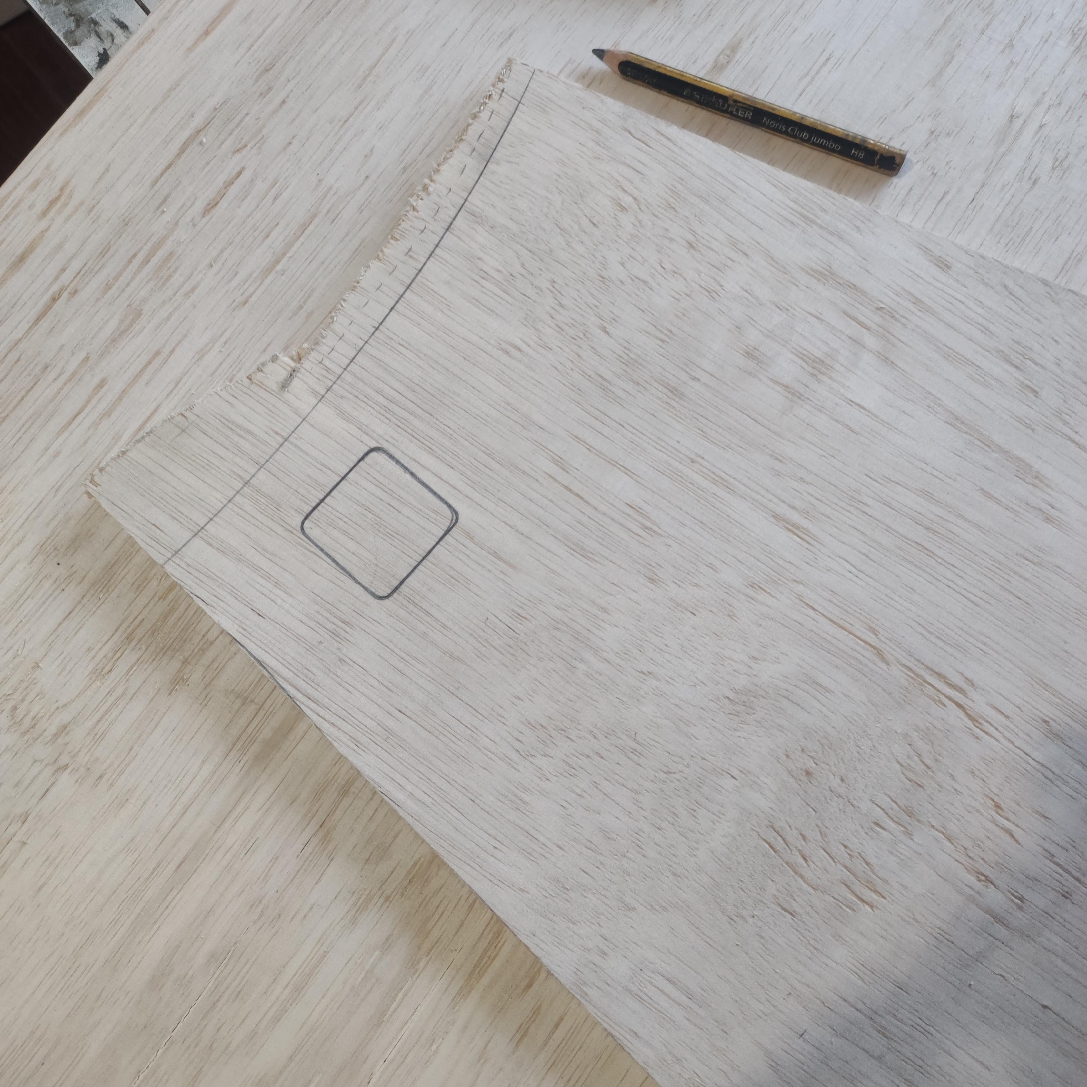

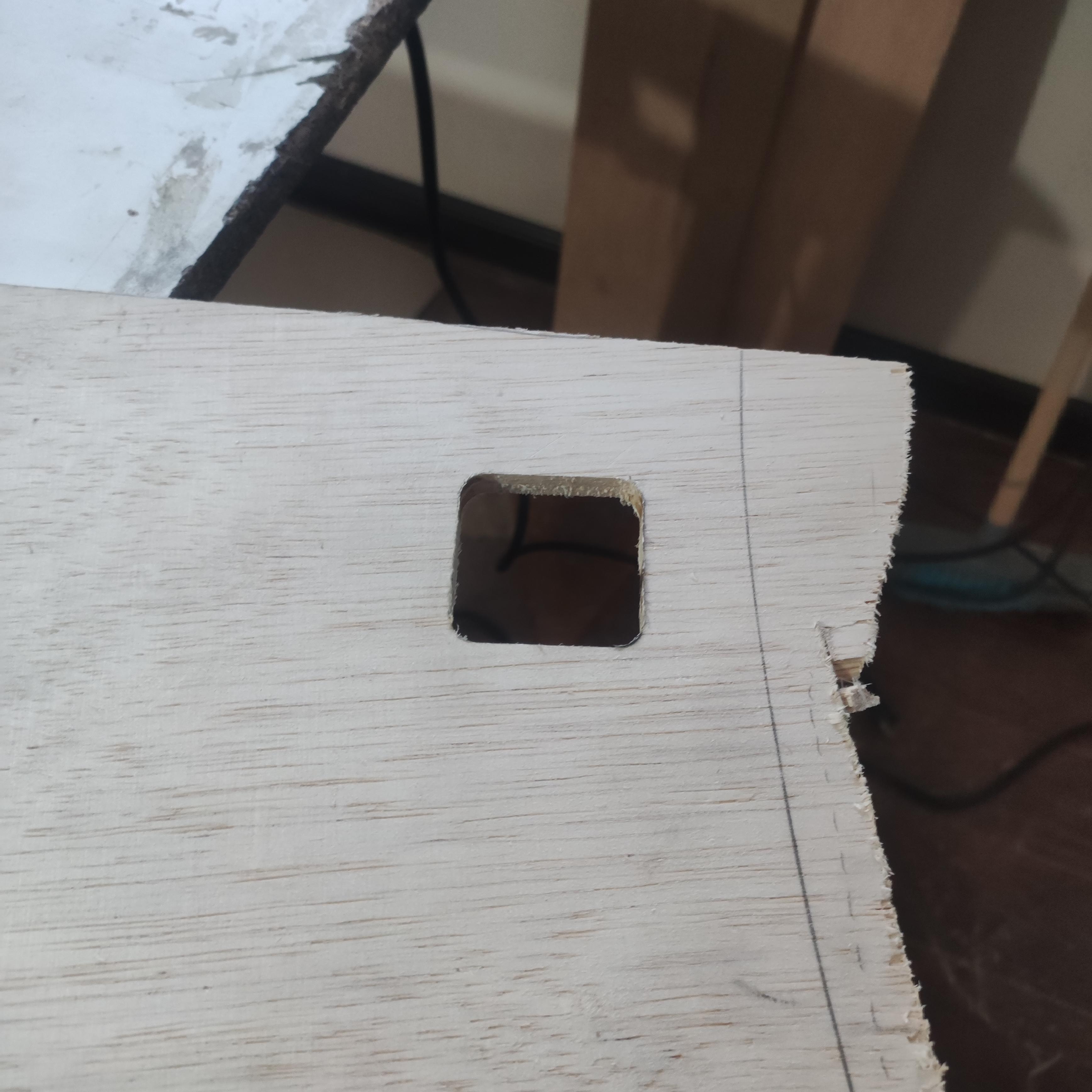

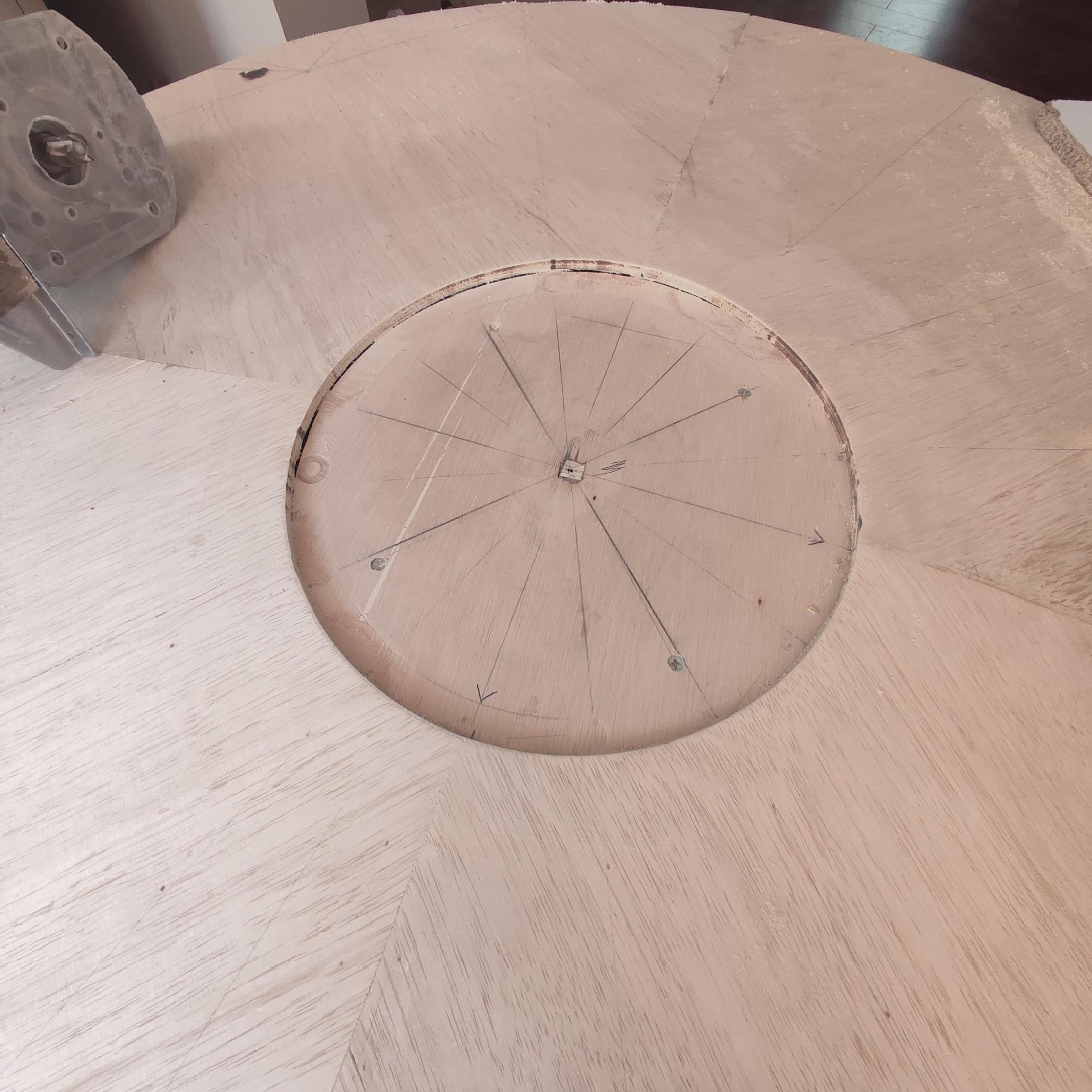

Now it's time for the flexible panels for the base. The procedure is the same, but this time, when creating the template, you need to add a mark to indicate the position of the bolt. I didn't include this detail in the .dxf file because it's safer to trace its location using the physical model. With this ready, we can verify that everything fits correctly and cut the 4 parts.
A detail to note is that I made a mistake when attaching the connection blocks. Without realizing it, I positioned them offset from the large ribs, which is why I couldn't make the hole in the center of the panel as I had originally intended.
Subsequently, we will make small covers to conceal that hole. The idea is for these covers to be magnetic and easily removable when you want to disassemble the table.
Now, with glue and more nails, it's ready to go.

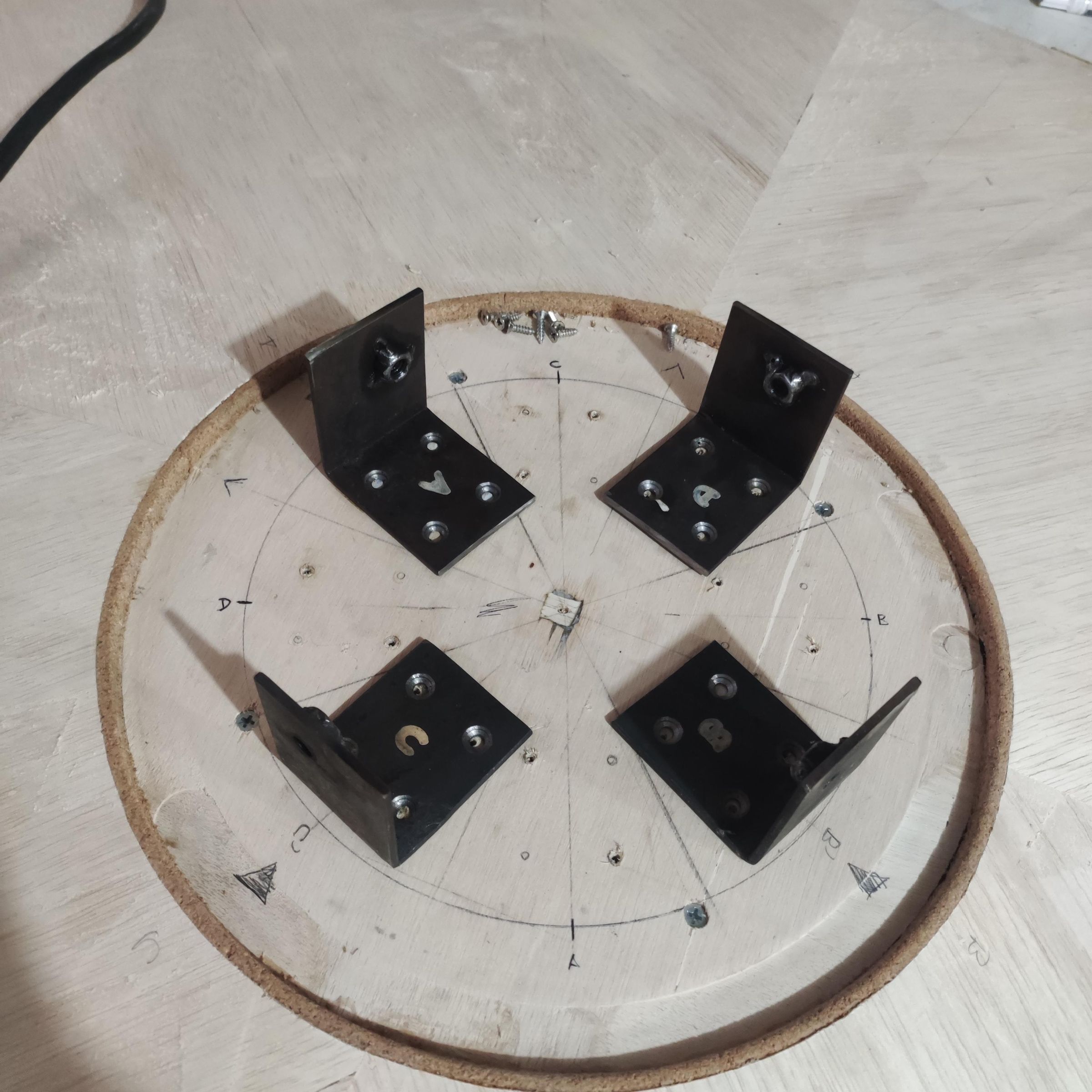

We continue with the fastening system. Previously, I mentioned the optional use of a welder. This depends on the L brackets you can obtain. If you choose not to use a welder, you can create threaded holes in these pieces for the screw. In this case, the thickness of the piece will need to be sufficient to hold it firmly.
Since I couldn't find brackets of the required thickness, I decided to make them from scratch. I cut 4 pieces from a 2" plate, bent them at a 90º, and drilled 4 holes to attach them to the core, using the positions of the connection blocks as a guide.
For now, I haven't drilled the 5/16" hole for the screw yet. When precise holes are needed, I find it better to mark their position with the assembled object (of course, whenever this is possible). So, I assembled the base and top and marked the positions of the 4 holes from the connection blocks. I did this using the same 5/16" drill bit and applying some paint to one end to make it collide with the L bracket.
Then, with the marks in place, I drilled the holes and welded a nut to each one. Once again, the placement is slightly off-center, but it works.

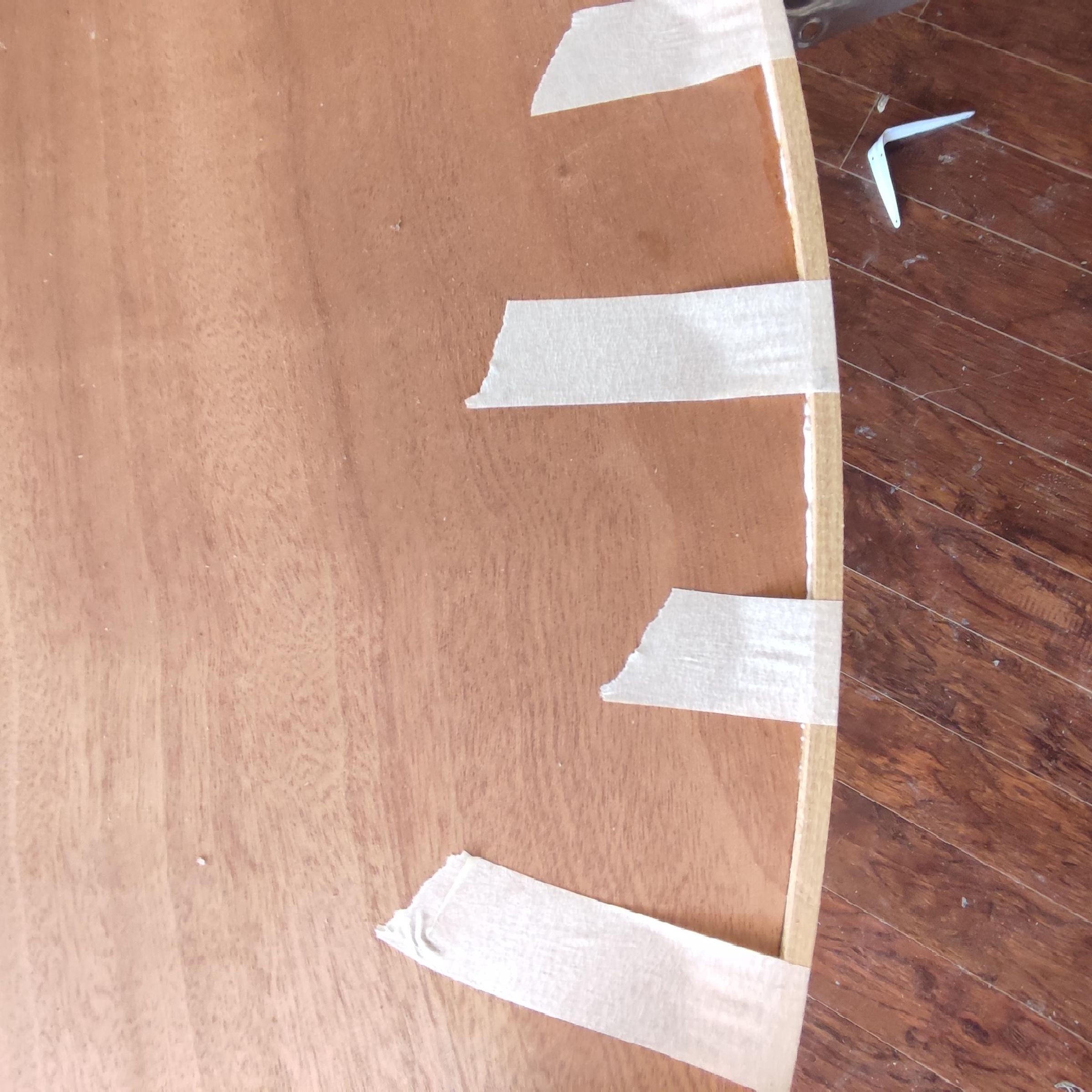

The table is almost ready; well, it's time to glue the decorative top with enough glue. I did this, leaving approximately 1 cm around the entire diameter, and then used the flush trim bit to profile the entire circle. Now you can look for something to cover the edge. I used some thin wood sheets that I had on hand.
