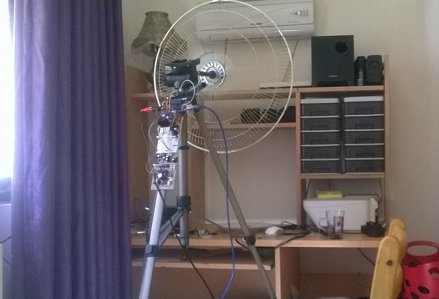

My Last project 4KM wireless for my Arduino :)
