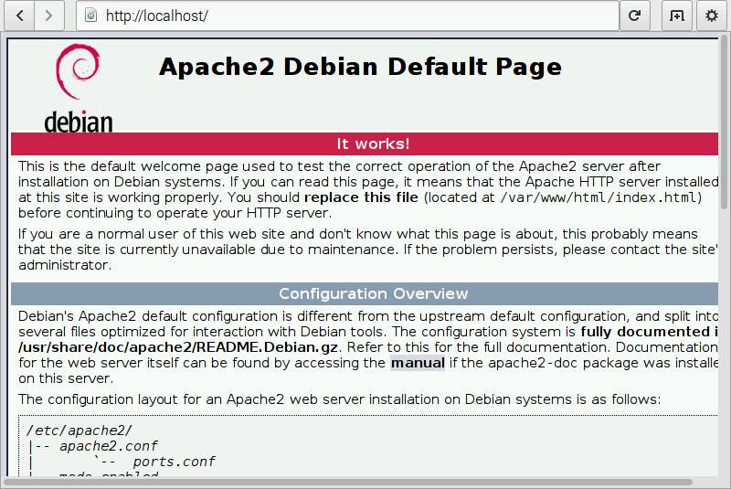

Step 3: Install Apache
Install the apache2 package. The -y flag answers the pre-install security question for you.
sudo apt-get install apache2 -y
Apache comes with a test HTML file that generates a placeholder web page to test the installation with. This test HTML file comes in Apache's root directory. By default, Apache is set to look in this directory for web documents to create content within a web browser. To take a look at this test page and confirm Apache did indeed install correctly pull up it up in your web browser by typing in this URL address:
http://localhost/
If Apache installed correctly, you will see the Apache test web page in the browser:

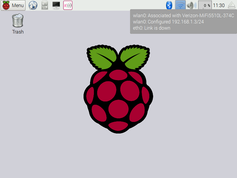

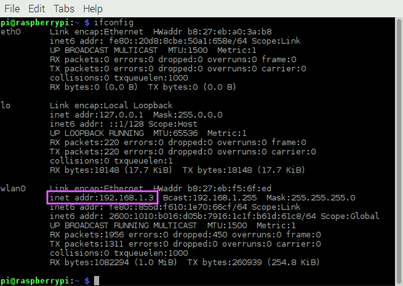

Find Your Raspberry Pi's IP Address
You can use the localhost address to access the web page while on the Raspberry Pi. To access the web page from another computer you need your Raspberry Pi’s IP address. To find the IP address type in LXTerminal:
ifconfig
You can also find it on the desktop if you hover the cursor over the WiFi reception symbol.

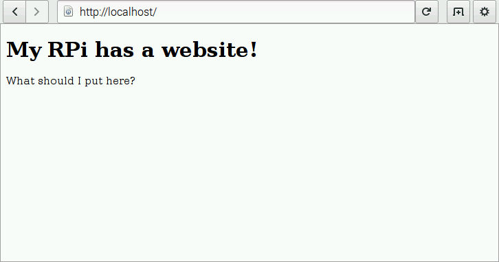

First, tell the browser what version of HTML you are using. This document is declared as an HTML5 doc:
<!DOCTYPE html>
Start with the html and body tags:
<html>
<body>
The bulk of your content goes next, between the body tags. Make the first line a heading with the h1 tag. The number after the "h" defines the importance of the heading which affects the size of the font. Use the p tag to define a paragraph:
<h1>My Raspberry Pi has a website!</h1>
<p>What should I put here?</p>
Finish the page by closing the body and html and tags:
</body>
</html>

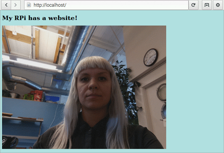

Save the document with the suffix .html and visit localhost in your browser. You will see your web page!

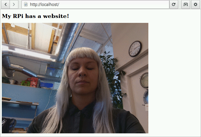

What should you put on the web page? Let's put an image up, or better yet, the animateMe.gif! In order for any asset to be displayed on this web page it must be put it in Apache's document root. You should copy and paste it so it stays in your boof/fotos directory too. To copy and paste a file in command-line use the cp command. First, cd to your home directory:
cd ~
Copy and paste the animateMe.gif file:
sudo cp boof/fotos/animateMe.gif /var/www/html
Go back to the html directory:
cd /var/www/html
Reopen the index.html file so you can add the image:
sudo nano index.html
To define and embed an image on an HTML page use the img tag. Put the following line between the heading and paragraph.
<p><img src="animateMe.gif"></p>
Open the page in the browser and it will look like this except with your own stylish selfie GIF.

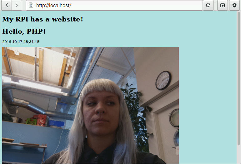

Combine PHP with HTML
As long as PHP code is contained within tags you can include it in an HTML file structure. As an example, combine your current HTML and PHP scripts and make the text larger by using HTML tags.
Let's include a simple PHP script that displays the date and time. Paste the following anywhere between the <body> tags:
<?php
echo date('Y-m-d H:i:s');
Save the file with Ctrl + o but change the extension from .html to .php, which will save a new file. So as to not confuse the browser, remove the old .html version:
sudo rm index.html
Refresh localhost in your web browser. The output will look like this:
Ok, so what is the difference? It looks like a regular HTML page doesn't it? Refresh the page and watch the magic. The magic being the time will change! That's PHP and its built-in date() function working for you to make a dynamic web page.

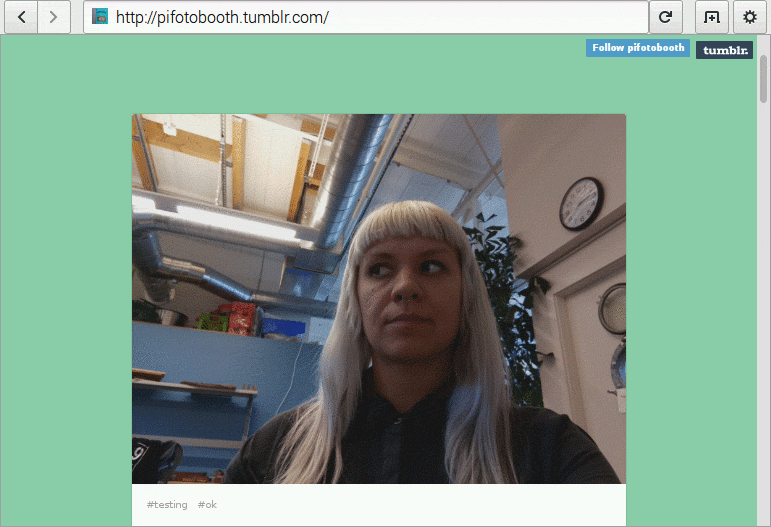

This is the exciting part! Go to your Tumblr page and check out the GIF! Swap "published" in your program to "draft" if you wish to create draft posts instead.
