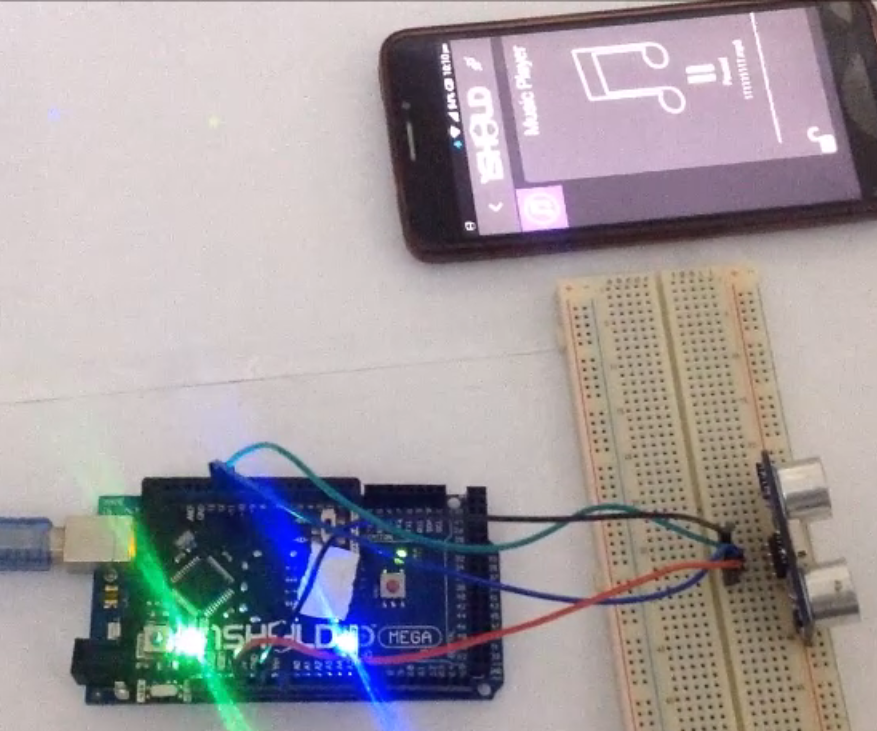

Step 2: Wiring and Setup
1.mount the 1sheeld on the Arduino board
2.Make sure the power switch shown above is turned to 5V (for Arduino UNO users) if you're using another Arduino board check here
3.Connect the X3 220 ohms resistors as shown.
4.Connect the long leg of the RGB to the GND
then connect the Red Leg to pin9, Green Leg to pin10 and Blue Leg to pin11.

Step 4: Putting It All Together
  1. After connecting all components as shown.
  2. Connect the Arduino to your laptop and make sure the code is uploaded.
  3. Switch the 1Sheeld back to operating mode.
  4. Open your 1Sheeld app and connect your phone to your 1Sheeld board. (Check 1Sheeld tutorial here if you haven't already).
  5. Select Color Detector Shield, and press on the multiple shields icon at the top right of the app.
  6. Now, hold your phone, then scan the color of any object and watch your RGB.
