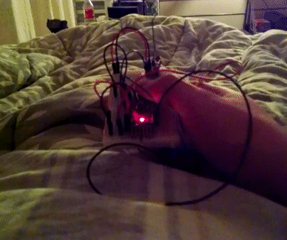

*If you've never used the huzzah ESP8266 breakout module before don't worry, as long as you are familiar with the Arduino IDE then you'll be able to use this.You can program the chip inside the huzzah directly using the Arduino IDE. The reason we use this module instead of an Arduino is because we also need Wifi. The board comes with no pins soldered on, so you will have to have some soldering skills!

5. You'll want to hook up the control relay to the Huzzah ESP8266 as laid out in my diagram.

I was curious to see how many milliamps my whole device used during operation. It turns out while the coils are de-energized the MCU uses roughly 74mA. When the coils are energized, the MCU and control relay combo use a total of 130mA.
Since I am currently running it on a battery, I would revise my Huzzah code in the future to implement the esp.deepSleep function to lower the power consumption while the MCU is not checking for changes. I hope my tutorial was helpful!
