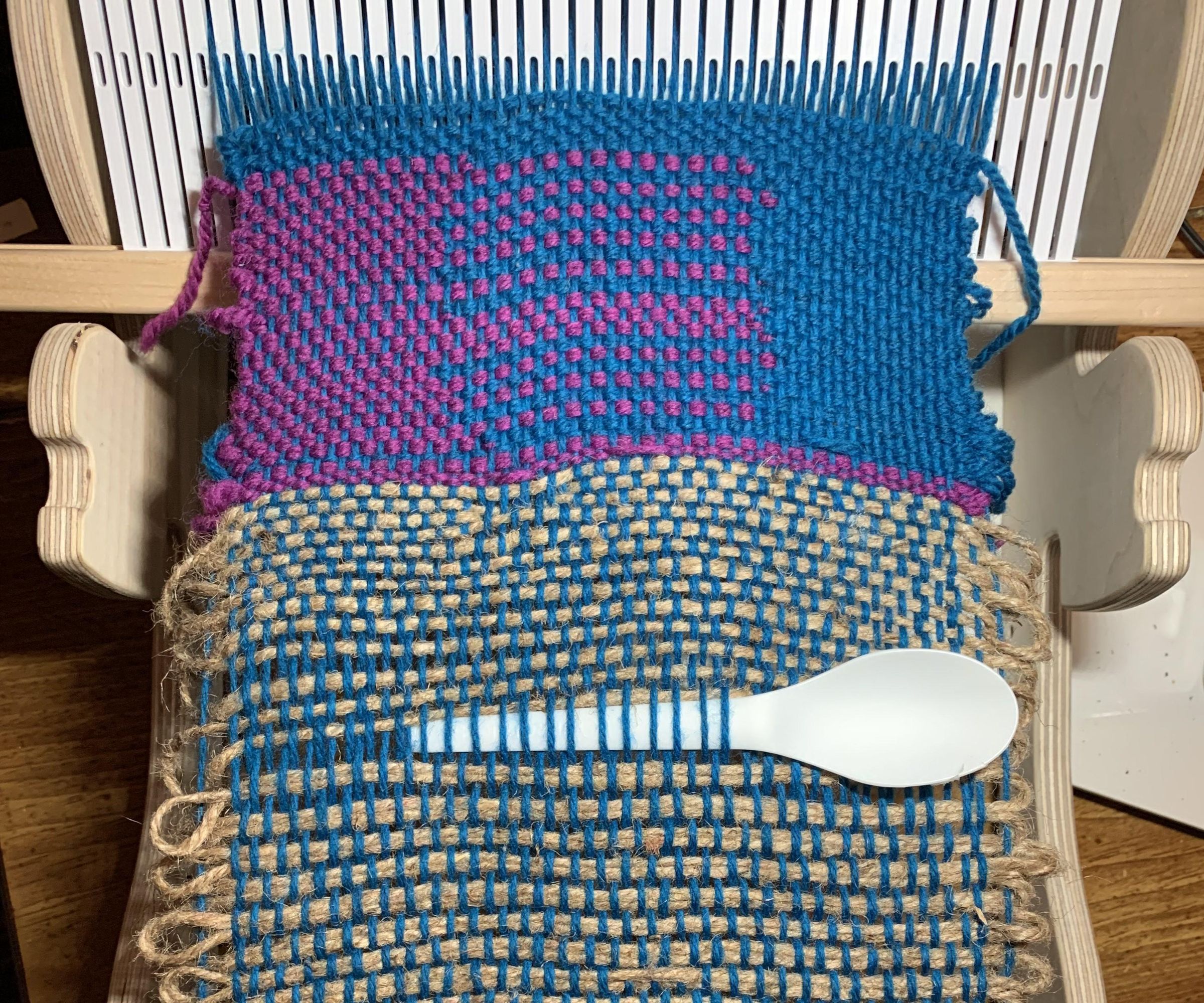

The goal of this project is to weave with elastics and gain an understanding of how weave structure affects the stretchiness of a fabric. I intend to weave three different fabric structures with varying levels of stretch. Hopefully, by the end of this project, I will have an understanding of how the type of structure can change the elasticity of a given textile.

To gain a starting point for understanding, I used a page from the book "Manual of Swedish handweaving," which mentions elastics in a section about "crepe structures." from what I gathered, a crepe structure has a somewhat ambiguous definition: a structure that has no apparent pattern and creates a rough texture. so can't anything be a crepe? why is crepe used in elastics? I honestly don't know but a good way to find out is to get on the loom, so I started weaving these three patterns shown above.
