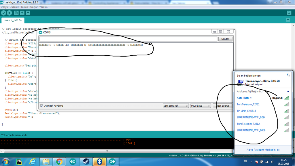

Step 4: Uploading Code and Test It
Now if your relay is at all okay then upload the code attached here to the NodeMCU. Change your ssid and pass of your router at the beginning of the code. then upload.
See the video if you are using for the first time. After uploading open the serial monitor and copy the URL. Now open up a browser and search for that URL. You will come with a screen as given in the pic attached.Now you can switch on and off the lights. As always you can always add more devices along with more relays and change the code as your need.You can open with laptop or mobile which are connected to the same router as that of the NodeMCU is connected.
