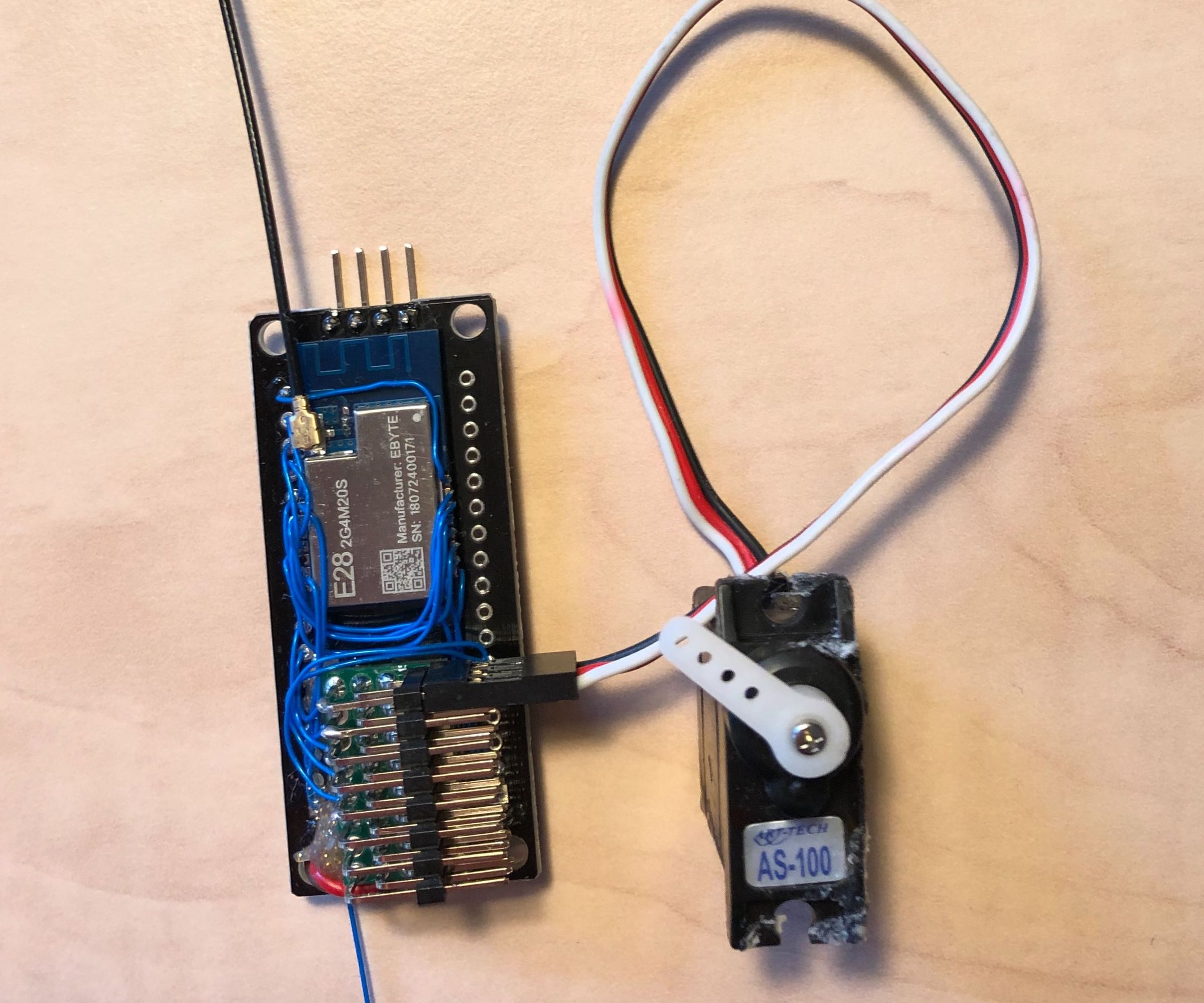

Step 2: Hardware
The hardware setup is very simple. I use the D1 (pitch) and D2 (roll) output on the ESP8266 to control the RC servos respectively. The board is powered from a USB power bank. The RC servos are powered from the 5v and GND pin of the board.
