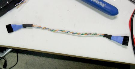

Step 6: Solder It on Perfboard or PCB
You can either etch your own PCB or just use small perfboard. I assembled mine on small square perfboard from Radioshack.
Just follow schematic, or you can use my board layout. Note: I used polarized connector (J1) on mine. Only 5 pins out of 6 used.
Note: In the video I also have another 3 pin connector. You don’t need it, I used it to connect IR receiver to the same board (for my Remote Volume Controller project)
