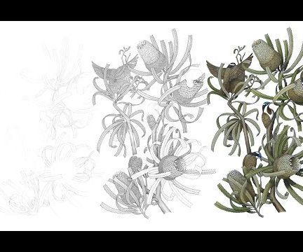

Step 1: Initial Sketches
In this first stage the sketches for the etching are created. The sketches are fairly detailed but do not contain anywhere near the amount of information seen in the final etching. The sketches are just a guide to work for and are primarily limited to line work. The final sketch will be transferred to the etching plate using transfer paper in a later stage.

Step 9: Hand Colouring the Print
Once the finished prints are left to dry, ideally for at least one week, they can be hand-coloured if desired. Hand colouring prints with watercolours is a traditional method that is quite time consuming. Watercolour paints should be diluted with water until they are not too opaque. It is best to apply paint one colour at a time in thin, translucent layers. If colouring an edition of prints it is a good idea to mix colours for all prints and work colour by colour on all prints at the same time.
