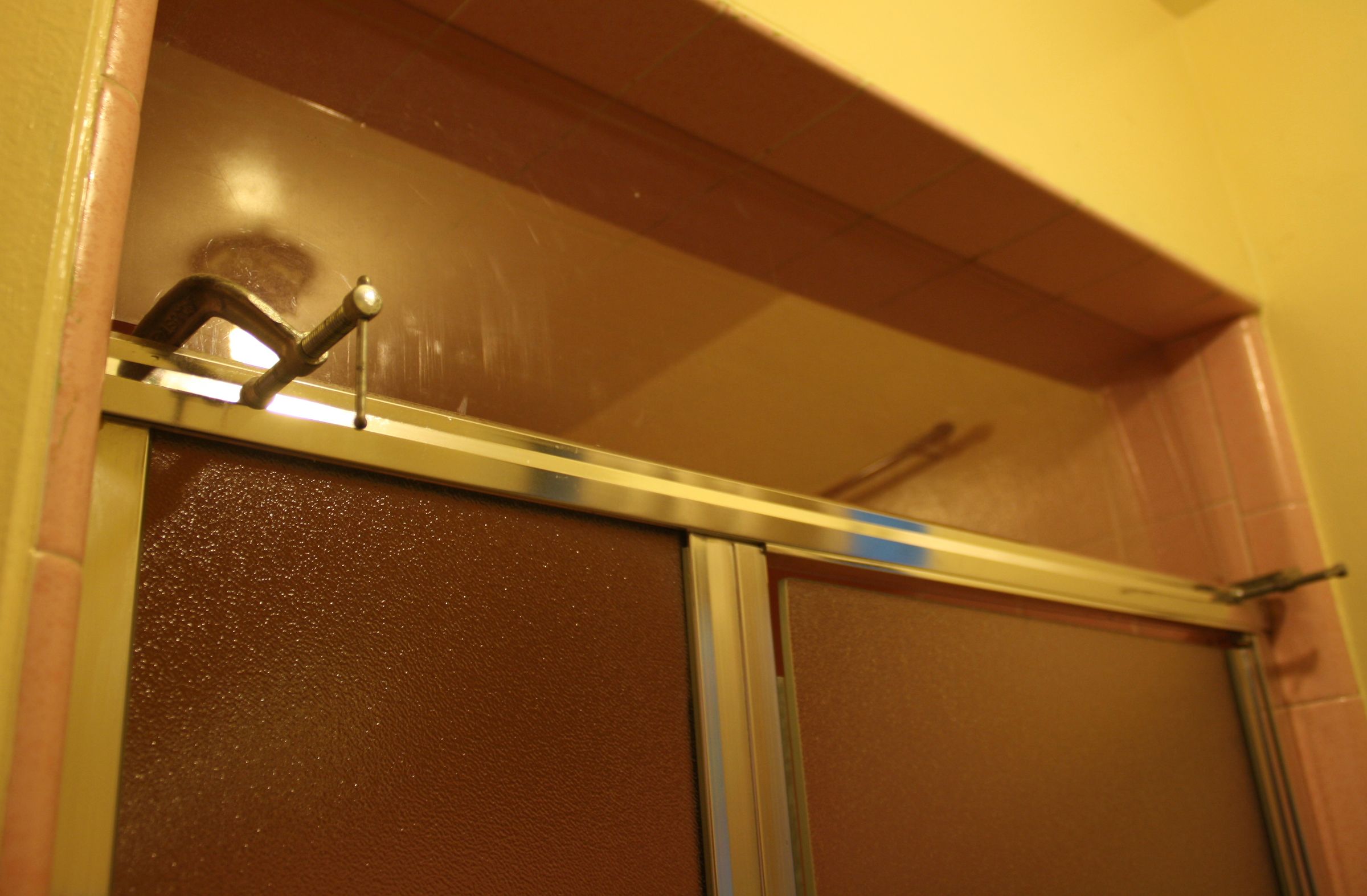

I enclosed my shower by putting a piece of Plexiglas (clear acrylic plastic sheet) over the top, and hanging clear plastic drop-cloth material to cover the gap in front. The Plexiglas is supported on three sides by sitting on top of the fiberglass shower stall; and by an aluminum channel in front.
Since all of the surfaces inside the enclosure will get very damp during the shower, you don't want to have any unprotected wallboard or plaster inside the enclosure. Normally this means that the Plexiglas lid should go right at the top of the existing tile or fiberglass, low enough that any wallboard is above the lid. If that means you'll bump your head, see step 23 for some other options.
Measure the size needed for the Plexiglas carefully. It needs to be big enough to sit on top of the tile or fiberglass around the edge of the stall without falling in, but small enough to fit between the walls.
If there are three walls where the Plexiglas can sit on top of the stall, the support for the third side can be a simple piece of aluminum angle extrusion. If there are two sides that need added support, it may be necessary to add a support for the corner between them--either a leg going down to the outside of the stall, or a cord hanging it from the ceiling.

Have the Plexiglas and the aluminum within reach at the shower stall. Place the Plexiglas in position, and then place the aluminum L extrusion under the front edge. You could glue or screw them together, but I didn't find that to be necessary.
The aluminum piece is necessary: I first tried without it, but found that the Plexiglas wasn't stable--it would flex and fall down every once in a while. (Note the broken corners which I crudely patched--don't let that happen to yours!)

I simply cut a polyethylene sheet with scissors to drape over the opening above the door, and clipped it in place with binder clips. Since I'm taller than the door, I wanted a flexible material that I wouldn't have to worry about bumping my head on.
When it's really cold outside the stall, and warm inside, you can feel cold air coming in any little air leak, especially near the bottom. To greatly reduce that effect, I cut a one-inch strip of polyethylene sheet and taped it across the bottom of the door as a weatherstripping flap.

Step 23: Appendix: Other Enclosure Options
If the height of the tile or fiberglass shower enclosure is not right for the level of the lid, you can't just rest the Plexiglas on the rim like I did. Here are some other options:
1) If the tile goes all the way up to the ceiling, you can hang the Plexiglas lid from the ceiling. For example, drill holes about an inch in from the corners of the Plexiglas, and hang it with synthetic cord. Keeping it at least a few inches below the ceiling will help prevent moisture from accumulating between it and the ceiling. The lower you hang it, the warmer you'll be since you need to heat up less space.
2) If the tile or enclosure ends too low and you'd bump your head on the Plexiglas, you can either tile more of the wall to be able to put it higher; or you make a tent-like top from plastic sheeting. You can raise the center by hanging it from the ceiling; then tape the edges to the tile or fiberglass enclosure walls using clear packing tape. To attach a cord to the center of the plastic, bunch the plastic around a marble-sized rock (or marble, or anything else about that size) wrap a cord around it, and tie it off. Then hang that from a hook in the ceiling.
Option 2 is also good for a quick, cheap, and dirty option even if the height isn't a problem.
