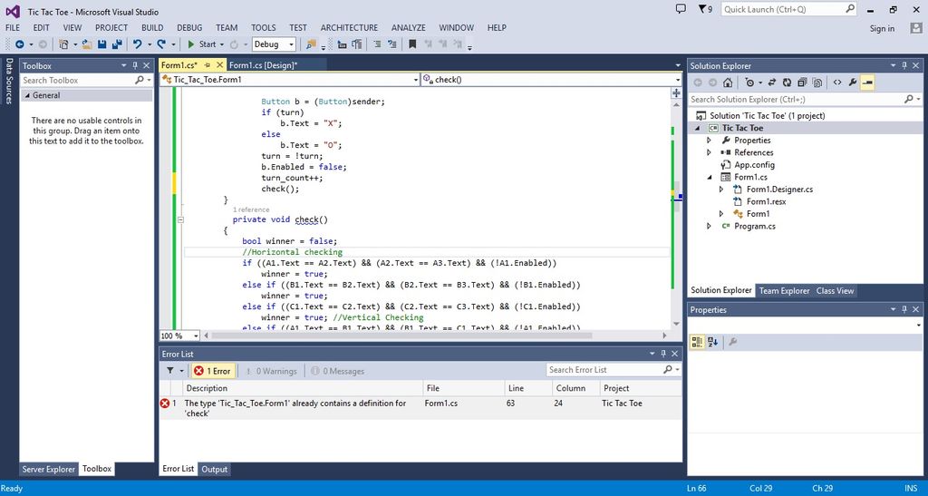

Step 5: Checking the Winner
Our
main aim in this step is to check the winner. So we need to create a new class here. So basically the renaming of the button will be useful here.
1. Under " public partial class " type this===>>
private void check()
{ bool winner = false; //Horizontal checking if((A1.Text==A2.Text)&&(A2.Text==A3.Text)&&(!A1.Enabled)) winner = true; else if((B1.Text==B2.Text)&&(B2.Text==B3.Text)&&(!B1.Enabled)) winner = true; else if((C1.Text==C2.Text)&&(C2.Text==C3.Text)&&(!C1.Enabled)) winner = true; //Vertical Checking else if((A1.Text==B1.Text)&&(B1.Text==C1.Text)&&(!A1.Enabled)) winner = true; else if((A2.Text==B2.Text)&&(B2.Text==C2.Text)&&(!A2.Enabled)) winner = true; else if((A3.Text==B3.Text)&&(B3.Text==C3.Text)&&(!A3.Enabled)) winner = true; //Oblique Checking else if((A1.Text==B2.Text)&&(B2.Text==C3.Text)&&(!A1.Enabled)) winner = true; else if((A3.Text==B2.Text)&&(B2.Text==C1.Text)&&(!A3.Enabled)) winner = true;if(winner) { disableButtons(); String win = ""; if(turn) win = "O"; else win = "X"; MessageBox.Show(win + " Wins ! " , "Yay"); // Click Image for more clarity(string operation 2/21) } else { if(turn_count == 9) MessageBox.Show("Draw !","Bummer"); } }//End of class
