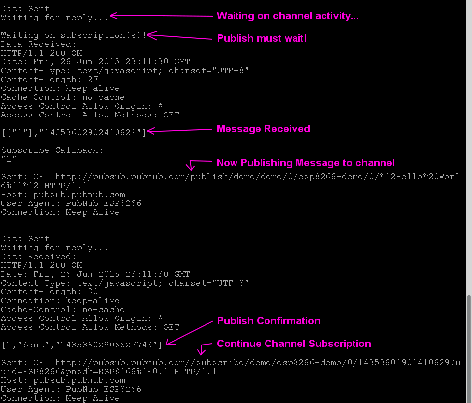

A message of "1" will turn on LED1, while "0" will turn it off. Pushing SW2 will request a publish which will take place at either the next subscription message received or a timeout, due to the limitations previously discussed. Removing the "Subscribe" section of code or otherwise adjusting the overall program flow will allow for real time publishing.

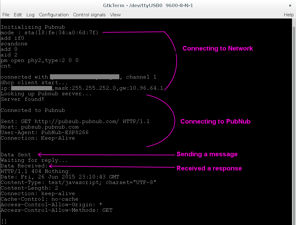

If you plan on modifying the code to do your bidding (and I highly encourage you to do just that) you will want to make use of the DEBUG_PRINT() statements scattered about the library. These will print information through the serial port whenever various events take place. The UART is initialized to a baudrate of 9600, but this is easily modified in include/user_config.h. In Linux, I am using the program gtkterm for serial bugging.
The first image shows a typical initialization of this demo.

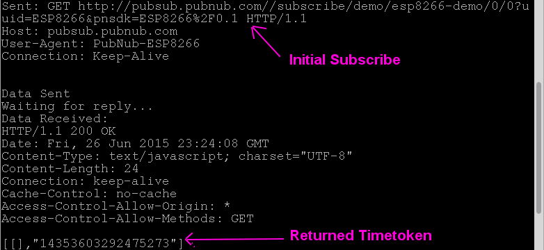

After this initial message is sent, PubNub will send an empty response. Now, we can subscribe to a channel. The first subscribe call will use a Timetoken of '0'. PubNub will respond with a valid timetoken which should be used in the next subscribe call. (Refer to the second image.)

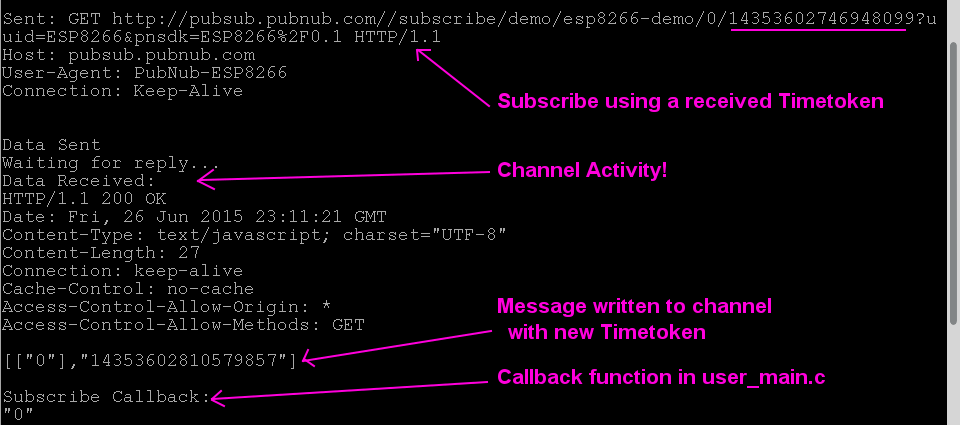

From here on, every resonse after a subscribe will contain a new Timetoken. This new Timetoken should always be used in the next subscribe call. After a subscribe call, the program will wait for a response or a timeout. When a message is received, it will be displayed, and the user defined subscribe callback function in user_main.c will be called. (Refer to the third image.)
If the button on GPIO0 is pushed, a publish request will be made. You should see a "Waiting on subscription(s)" message. The publish will then happen after the next message is received or a timeout occurs (in roughly 300 seconds). After the publish event, a new subscribe call using the last Timetoken is made again. (Refer to the fourth image.)

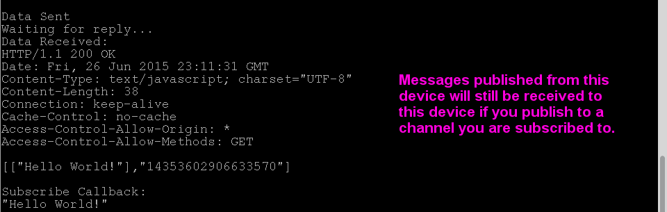

Note, that any messages sent from this device to a subscribed channel will be received on this device as well. (Refer to the fifth image.)
