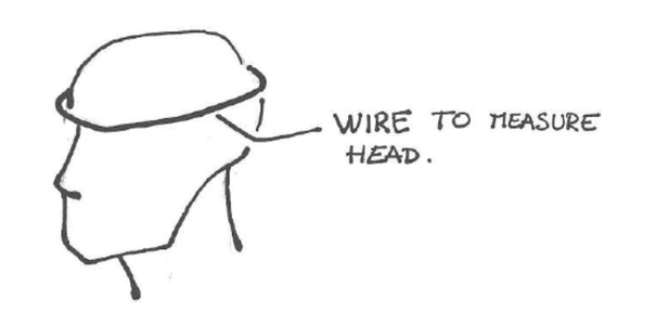

Step 1: Measures of the Head
Bend a metal wire around the head to have the measurements. Once you have the top view and the side view, you can draw them on PU foam block.
We use PU foam because it doesn't react with polyester.
Make sure to draw the center-lines on the block too, so you have a reference and you can make it symmetrical.

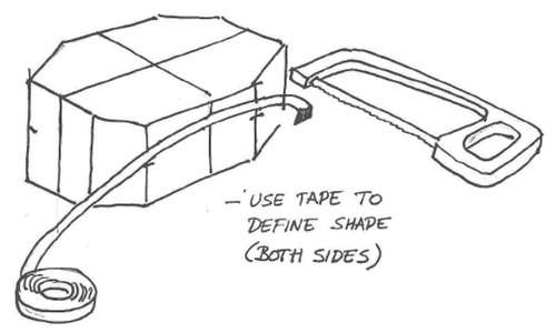

Use paper tape as a reference and guide to cut the foam.
Cut as much as possible, grinding causes more dust.
Don't make the edges round yet, it's easier to control the shape with straight lines.

Also use paper tape to cut (knive or a saw). Use tape on both sides to have a good guidance.

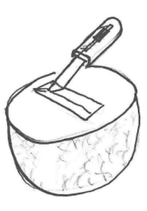

Step 3: Rounding the Edges
To round up the edges, you can use sanding paper. You can make a sanding block in order to create smooth sides, because it gives you more control about the movements.
Use double sided tape to stick sanding paper on a piece of wood.

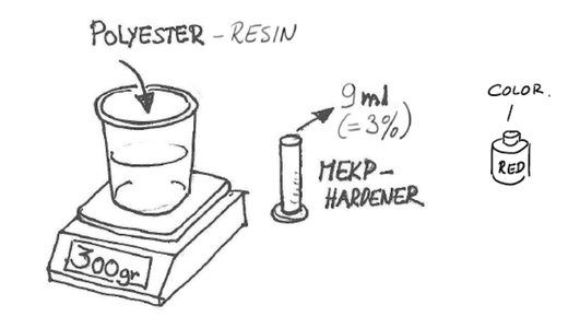

Mix 300grams of resin with 9ml of hardener (3%). You can also add a color that you like.
Stir well, in 8form movements.
Once it is stirred, the potlife is about 15minutes.

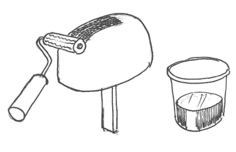

Paint the PU foam with polyester-resin.
Add glasmat and push on it with a roller. If you use a brush, don't swipe! Only make pushing moves.
Once there's only layer attached, paint everything again with polyester-resin and add another layer.
Add about 3 layers of 250gr and 1 layer of 30gr.
Use the de-air roller between each layer.
The fine (30gr.) layer gives the helmet a smooth finish.
Work fast, lifetime of the resin is limited (about 15min).

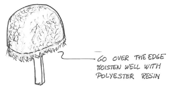

Moist the edge (downside) well.
