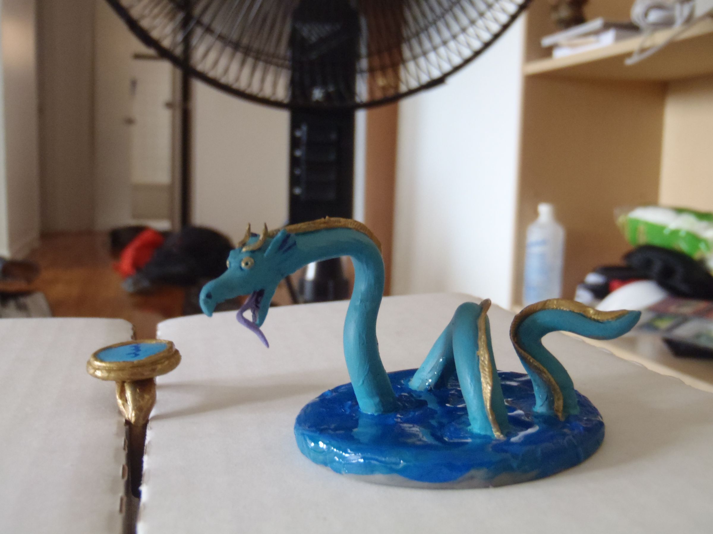

Step 4: Start Sculpting!
Here's where you start to get creative! It's time to sculpt!
1. Start by putting some sculpey at the joints and torso to secure the wire in place. Regular super sculpey works best here, but you can do it with the firm one as well.
2. Move on to coating the rest of the wire with as thin or thick of a layer of clay as necessary for your mini.
3. Start shaping the clay with your tools: Flatten it with the flat side of the tool and smoothe it with the needle. You can also work in details using the sharper edges.
4. Add clothing, armor, etc. I tend to do this by working the armor and clothing in my hands and then slowly working the edges into the rest of the clay using the flat edge of the tool. This works best when combining two pieces that are made of regular sculpey or one of each. Firm sculpey is much more difficult and you cand use regular sculpey as a binding agent between them and over the edges since you'll be painting it after anyways you don't really have to worry about the difference in material or colour, once they're baked and painted, it'll should be pretty seamless.
5. Make one last check before baking that the wire is all at least under a bit of clay. It can often still be seen through regular sculpey because of its slight transparency and you can still cover the wire with paint, but it's best to keep it as centered as possible in the clay.

Step 7: Painting!
I'm no pro at painting so I don't really have many tips for this section, but here they are anyways:
1. Base coats can be useful: If your mini is going to be mostly lighter coloured, I strongly suggest to do a base coat of white, especially if you sculpted it mostly out of grey sculpey. This will allow you to put less coats of paint and make forgotten areas look more acceptable. If your mini is mostly darker colours, you can paint it black for the same effect.
2. I usually start by painting the base black. This isn't necessary if you want to make a more elaborate base, but it helps me figure out the edges of the sculpture and the base while painting. By the end there are all kinds of colours splashed on the base which are then easy to cover up with a final coat of black.
3. if you notice holes in your sculpture due to bubbles bursting during baking or something (this rarely happens, but I've seen it before), you can fill the hole with the paint. Since it dries up leaving a rubber film, it'll often even out imperfections if you put globs of paint on them.
4. Many details you sculpted can be made clearer and more obvious by using paint properly. In the mini I was making in the pictures, I felt that the loincloth wasn't obvious enough and could lead to confusion. Lining it with a red border made it much more obvious and delimited it nicely. Similarly, adding silver buttons to the many pouches on the mini makes them stick out.
