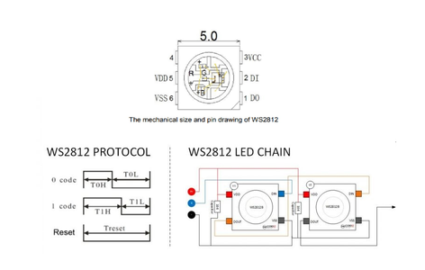

  • The Led Strip
WS2812B LEDs have an IC built into the LED, which allows one-wire interface communication. This means that you can use one pin on your controller to power several LEDs. It usually contains three wires: VCC, GND, and data. A series of code controls each led making it easier to control.
Check this article by sdiplight.com to better understand its working principle. LINK

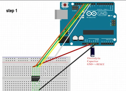

Step 1: Connect the circuit as shown in step 1 and upload the code "Arduino ISP" inside Arduino IDE. To upload the code, just go to File > Example > Arduino ISP > Arduino ISP. This enables an Arduino dev board such as Arduino Uno to upload code to ATTINY85.

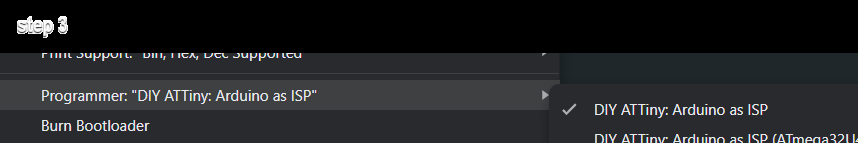

Step 3: ensure that the programmer is set as Arduino as ISP. Tools > Programmer

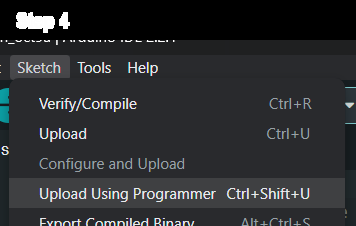

Step 4: Upload the code using Arduino ISP as a programmer. Otherwise, the code may not upload properly. Sketch > Upload using programmer.
