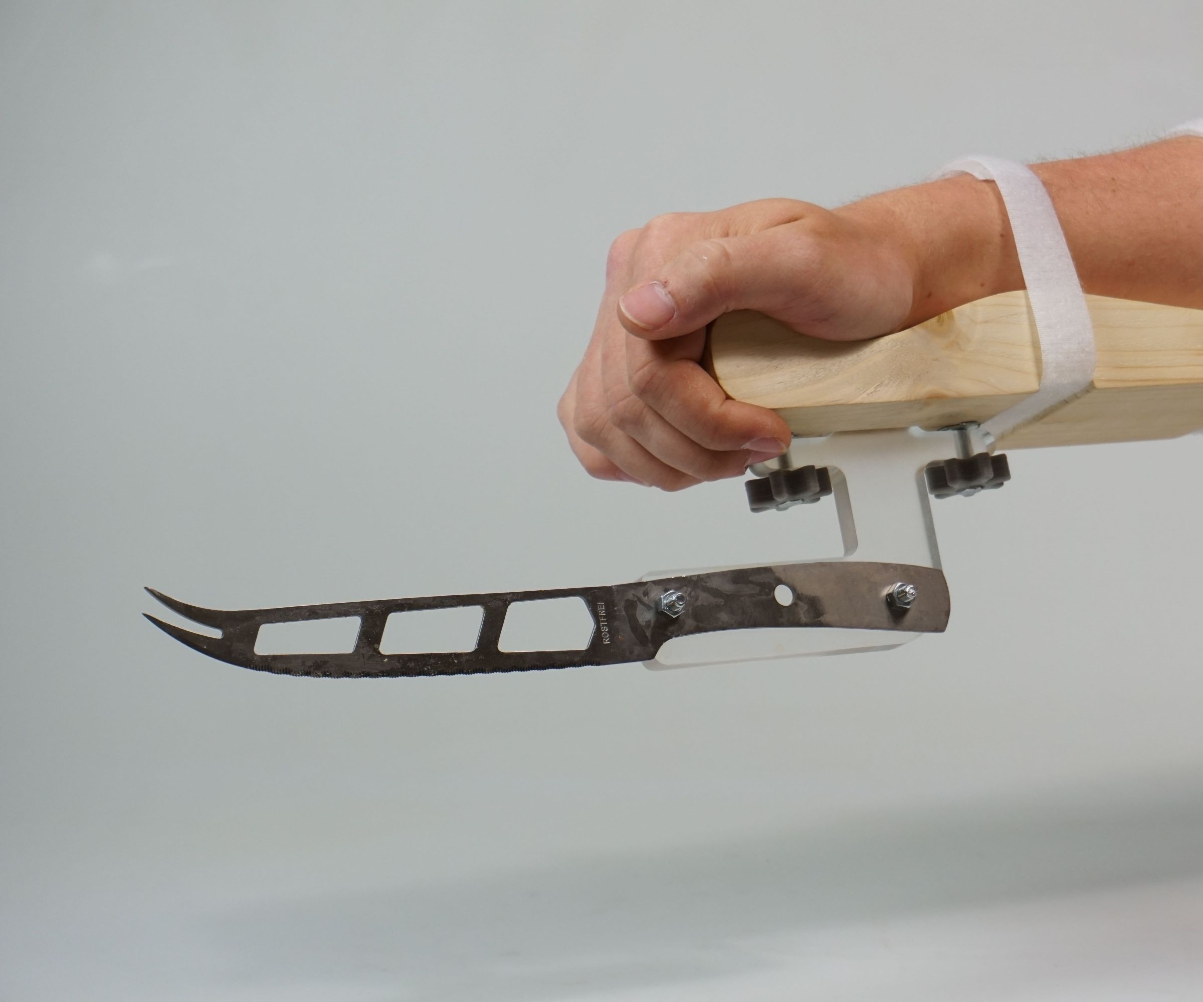

Introduction: Cutting Aid Basic
The Cutting Aid helps a person to use a knife in the kitchen without having to use the muscles in the fingers.
It is designed so that everyone can make it!

Step 1: Parts List
- Your knife
- Knife holder
- Connection
- Protective cover
- Standard bolts & nuts
Step 2: Information
Part name, Actions and Techniques, (material):
Knifeholder: adjusted to measurements of the knife. Lasercut or 3D print (pmma/ PLA)
Knife: dismantled and to be measured.
Arm splint: personal. Silhouet sawing (wood)
Protective cover: fixed. Cutting out and bending (metal)
Connection: fixed. Metal turning, polishing and drilling (metal)
