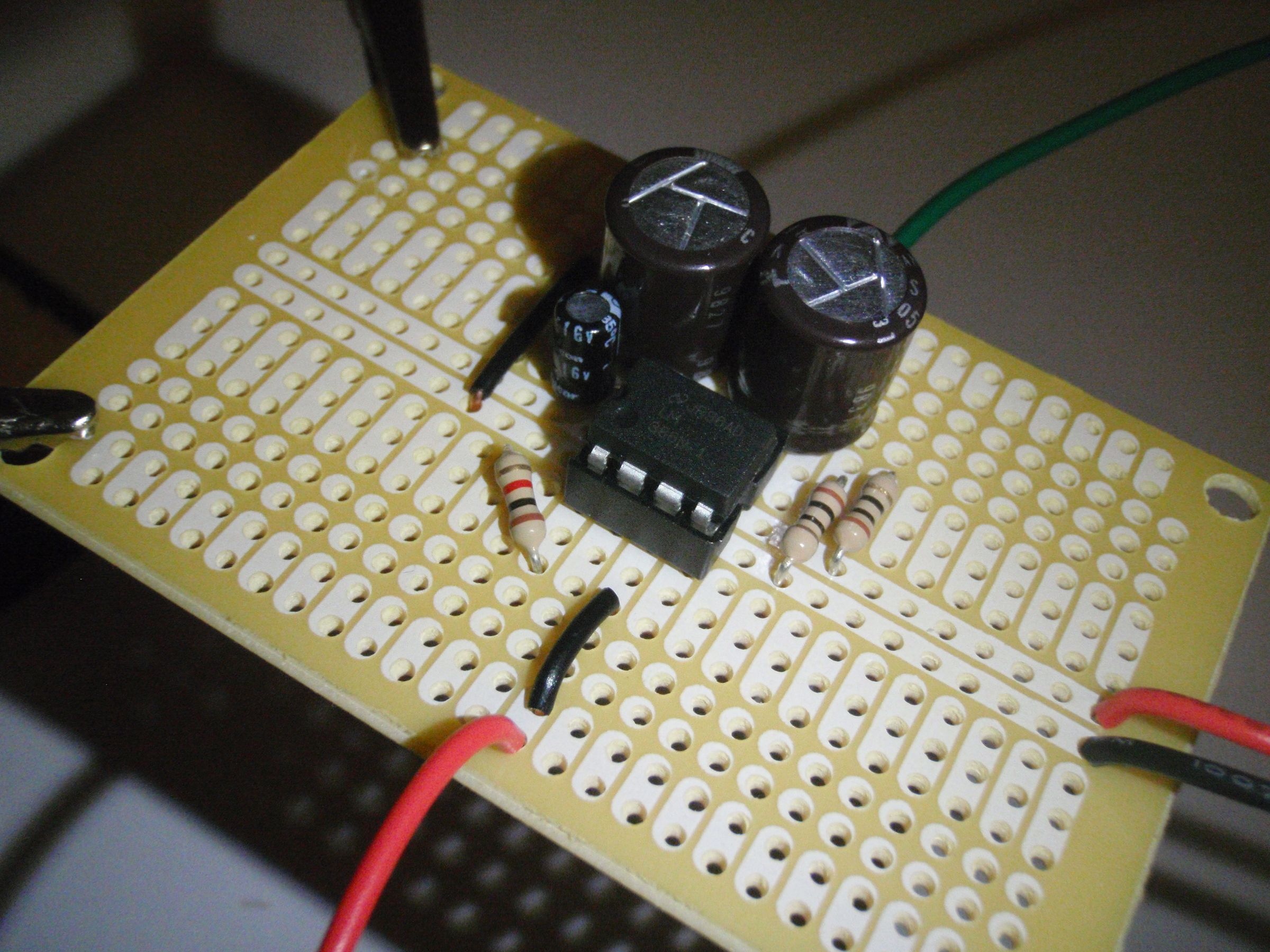

My first intention was to design a DC Voltage boost converter to convert 3vdc to 5vdc so that I could power my iPod or any other device requiring 5 volts to charge. I read about oscillation circuits and boost converter circuits and combined the two. My results were staggering when I was able to convert 4.5 volts to over 100 volts by accident. I decided to post an instructable for this instead, for now. If you have any tips to increase the efficiency or output current please comment below, I appreciate any suggestions.

Step 2: Place Components
Arrange components as you see here or as close as possible.
Step 3: Observe Diagram
Look through the wiring diagram to see what components need to be connected to what prior to soldering.
Step 4: Solder Components
Solder components carefully to ensure there are no shorts, also ensure all connections are made at all points.
Step 5: Clean Up and Test
Trim component leads and clean solder joints. Be sure to double check connections to make sure a connection isn't left out. Hook up battery terminals and multimeter and see what you've got!!!
