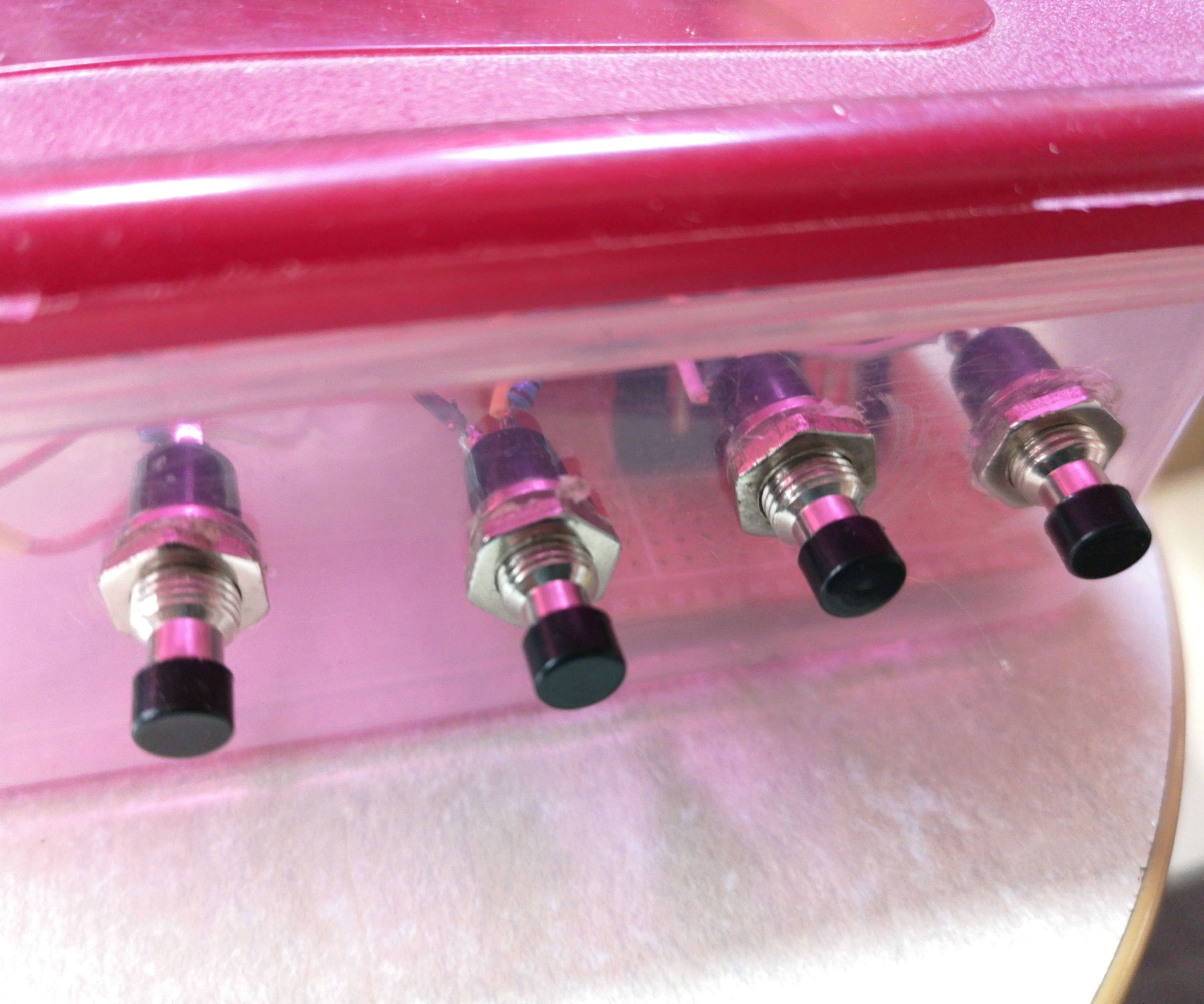

Introduction: DIY ATtiny Development Board & Programmer
Recently I m using the ATtiny 85, programing it through the arduino.
However I have found myself constantly shifting the chip between programing circuit and the development circuit.
Well until I have built the development board...
