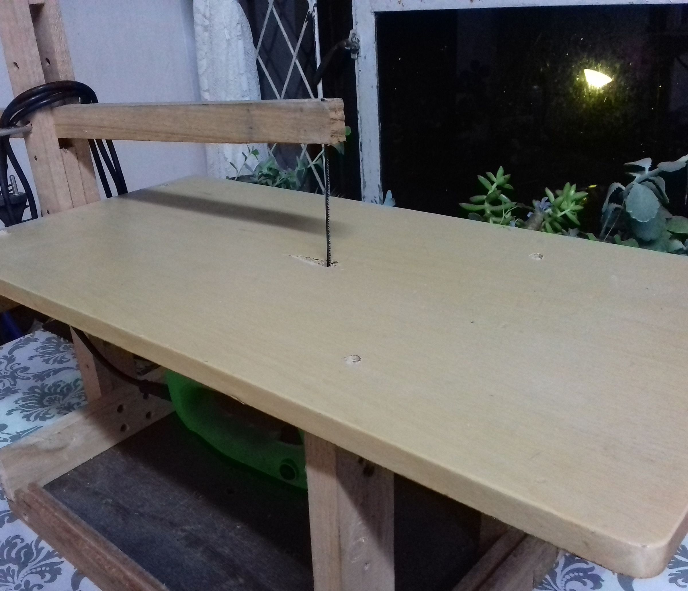

Scroll saw

The cellphone holder would have to be able to rotate, tilt, raise and lower. After much deliberation, I started with a base, how else will it stand right?!. So a basic hand drawn shape on plywood and this was then cut out on the scroll saw.... something every woodworker should have.....I then cut out a square in the center and used the router paired with a round over router bit to create the edging as you see in the pic.... I then added a short piece of reclaimed wood from a veggie crate.... roughly 5cm x 5cm and 15cm long, to this which I squared the one end to slot into the square I made in the base and glued it in....the opposite side, I drilled 2 holes and made a slot, for the up and down movement.
