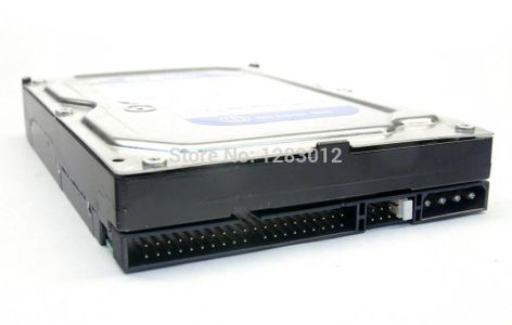

Step 1: Prepare Old HDD
Take an old 3.5" HDD and remove all screws and take off the top cover,remember hidden screws covered by the manufacturer sticker.
Keep removing screws,logic board and brushless motor until get bare metal of the Drive
