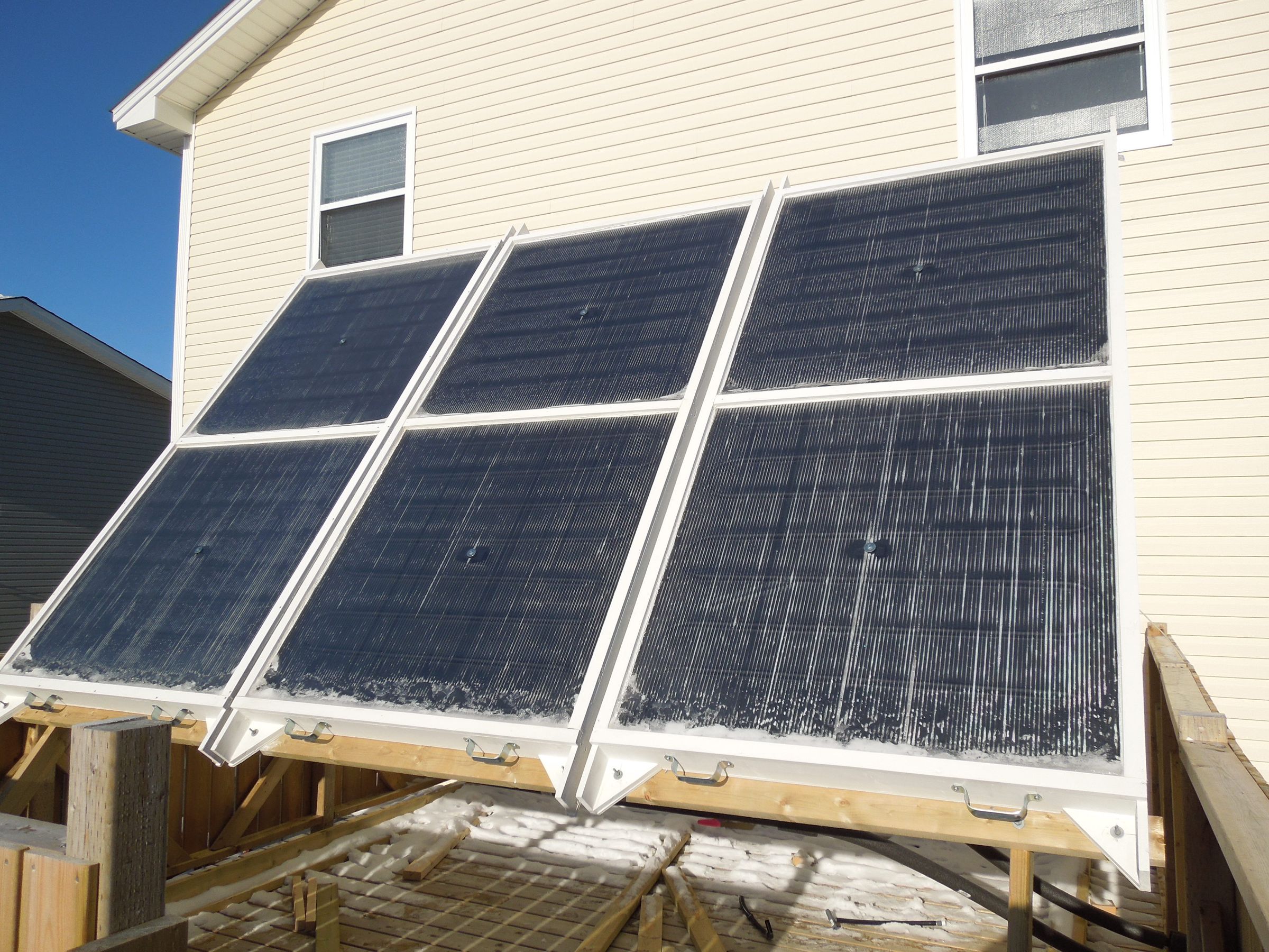

3)Some appliances do not have an on/off switch. I am doing some experimenting with hydronic solar thermal collectors and the pump I'm using does not have an on/off switch. To control the pump I have to plug or unplug it, which is annoying. Other things that usually don't come with switches are soldering irons and hot glue guns.
