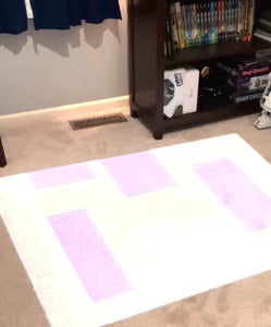

If you start it now, the box will light up when you walk into a sprite, great! The issue is that it's finicky and will not show up properly on the projector. In order to fix this, the camera needs to be on the floor a few feet away from the play area and needs to see all of it. This distance can vary depending on how big the play space is. The bigger the playspace, the higher the camera needs to be. click the fullscreen button in the right corner, then the start flag. If you stand on the box on the floor, it should light up and change color if everything is made correctly. Try jumping back and forth from each box and watch the effect!
Step 6: Getting Creative

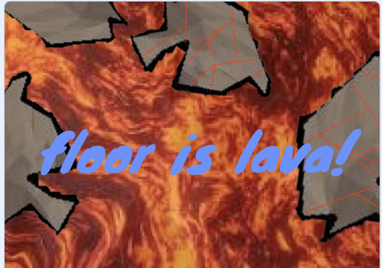

You can add more boxes, create a piano, change the texture, This step is all yours!
Be careful when adding more boxes though, the program may trigger multiple at a time. What I did in my example for the top middle box is that I noticed that it looked like I was standing on the bottom of the playspace, so I made an invisible box right where I was standing to trigger changing the box on the top!
The purple box is the one that lights up, while the green one is the one that gets triggered.
Another tough one was the top left box because it kept triggering the left box instead of itself; so I did the same thing but I put a dummy on the box, then made a small invisible box where it the dummy stood.
