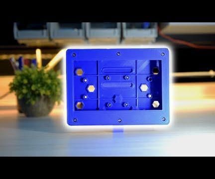

My case is divided into 4 parts, the first one you see is the top cover.
The second one is just an insert which goes in the bottom of the third part and holds the charging pins and the magnets.
Third one is the middle part which hold the actual buds, the charging pins and the magnets.
Fourth one is the bottom part which holds the battery and all the electronics.

Step 4: Assemble the 3D Printed Insert and the Middle Part
This is what my version of the assembled insert looks like, the pogo pins are sandwiched between two magnets.
If you are not able to buy the pogo pins, you can salvage them from smart watch chargers. Be careful when removing them, they are very fragile and can easily break.
Make sure you put the magnets in the correct polarity so that the buds are attracted.
Once the insert is fully assembled, plug them into the middle part with correct orientation. You can use hot glue or an acrylic glue such as T7000 to hold the inserts in place.
Feel free to design your case/inserts differently so that they are easier to mount.
