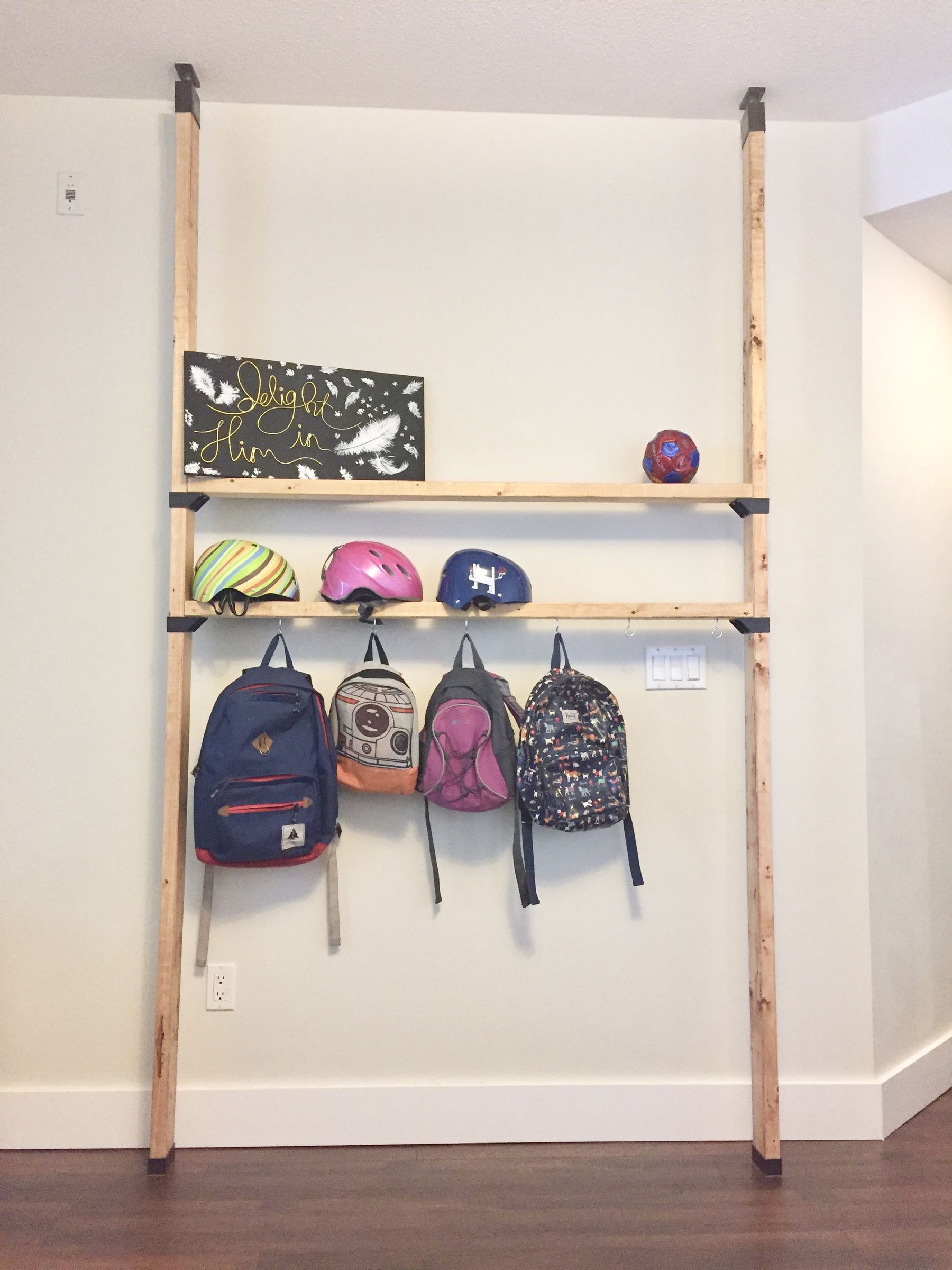

This basic standing desk has a small footprint. The frame for the desk, which are two 2×4 timber posts, is set up against the wall. The desktop fastens to the posts using shelf supports. All in all, it takes up little space.

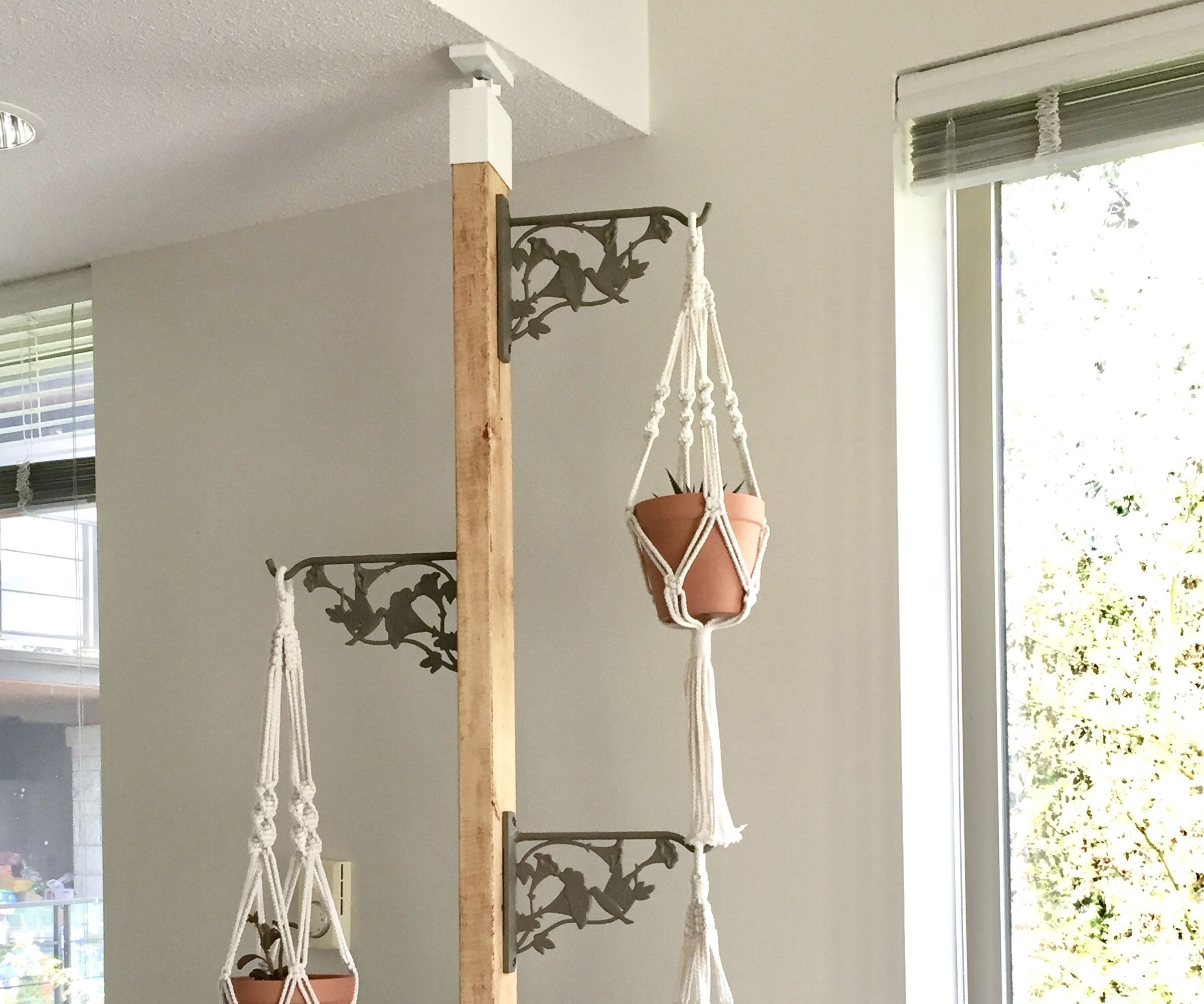

It’s quick and easy to build and you can locate it anywhere in the apartment. The timber posts are easy to set up using Labrico 2×4 Adjuster brackets. There is a top and bottom bracket which pop on each end of the 2×4 post. The top bracket tightens against the ceiling by turning the adjusting screw.
It’s held there by tension with no tools required.

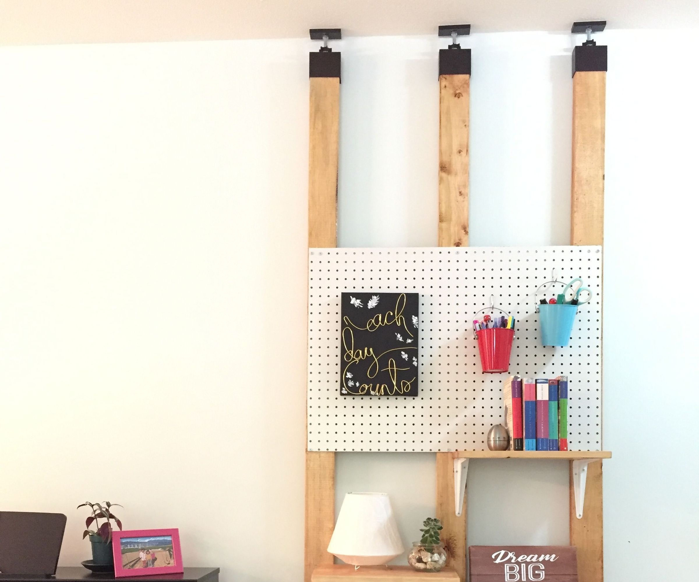

Add a pegboard for important notices, calendars and stationery items. This is great for extra space. Be sure to leave enough gap between the bottom of the pegboard and your opened laptop.

Step 13: MORE Storage? Add a Pegboard
Here are the dimensions that I used to add a pegboard.
You can definitely customize this to suit your needs.
Step 14: A Tip!
Just make sure with the pegboard, you have enough height to fully open your laptop.
