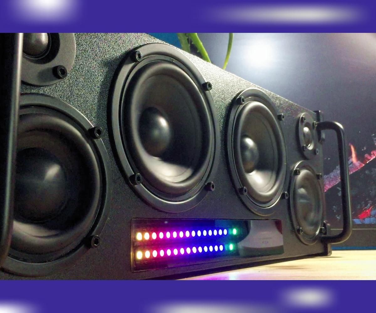

Introduction: DIY Surround Sound Bluetooth Speaker
Hey everyone! Want a badass, one-of-a-kind Bluetooth speaker? You've come to the right place!
This wireless speaker features Bluetooth 5.1 technology, a sick SP-107 RGB music processor, and some serious bass. The unique design offers 180-degree sound! You're probably wondering why that's cool.
Here's why:
  1. Bluetooth 5.1 lets you stream music at higher bitrates for crystal-clear sound.
  2. Four 3-inch woofers and a powerful TPA3116 amp deliver thumping bass.
  3. The SP-107 RGB music processor creates awesome light shows to match your tunes.
  4. 180-degree sound means your party will be rocking.
The speaker's enclosure is crafted from 12mm moisture-resistant MDF, while the front and top panels are constructed from double-layered 6mm MDF. MDF is an ideal material for acoustic speakers due to its exceptional vibration damping properties and ease of workability. The application of self-adhesive PVC film for the finish eliminates the need for toxic paints and results in a visually appealing aesthetic.

Step 1: Marking MDF Panels
MDF panels are easy to mark. For the most accurate results, I recommend using a 0.5mm mechanical pencil. For marking hole centers, I use a thin awl. The drawings can be downloaded here:
Step 2: Front Panel
Here's a breakdown of the front panel creation process:
  1. Start with two 6mm MDF panels. These are the base materials for the front panel.
  2. Create the cutout:
  3. On one of the 6mm MDF panels, use a jigsaw to carefully cut out a rectangular opening measuring 105mm by 32mm.
  4. Important: Before cutting, drill small pilot holes (6-8mm diameter) at each corner of the intended cutout. These holes prevent the MDF from splintering as the jigsaw blade enters the material.
  5. Bond the panels:
  6. Apply a generous layer of waterproof PVA adhesive to the surface of the panel without the cutout.
  7. Align the two panels carefully, ensuring they are flush.
  8. Place the assembled panels into a press.
  9. Pressing:
  10. Apply pressure to the panels within the press for at least six hours. This allows the PVA adhesive to cure completely, creating a strong and durable bond.
  11. Result:
  12. After pressing, you have a 12mm thick front panel with a precisely cut rectangular opening.
This process ensures the creation of a sturdy and well-constructed front panel that is ready for further assembly or finishing.

Step 19: Final Enclosure Assembly
Install the back panel into the enclosure:
  1. Attach with M4x20mm black carbon steel wood screws.
  2. Attach the protective corners to the enclosure with M4x10mm screws.
  3. Apply a 3mm thick translucent black plastic sheet to the RGB LED indicator using double-sided tape for protection.
https://youtu.be/g0ahNpwzElI?t=1728
Step 20: Final Check
  1. Press the battery voltage control button.
  2. If necessary, connect an external power source to charge the battery.
  3. (I using a laptop power supply rated at 18V 6A.)
  4.  Wait for the charging LED to turn off.
  5.  Press the battery voltage control button again.
  6.  A voltage of approximately 16.8 volts indicates a full charge.
You're all set!
https://youtu.be/g0ahNpwzElI?t=1806
