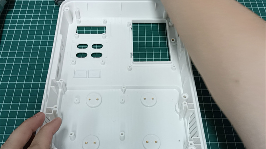

Step 1: Make the Case

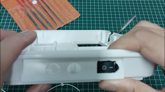

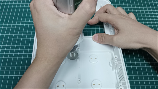

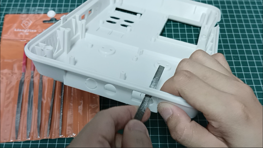

To speed up the process of making my device, I bought a case online that was close to what I needed. I then modified it to fit my requirements better. Here's what I did:
First, I cut a small hole in the case to make sure the screen's wires wouldn't be blocked. I smoothed out the edges with a file.
Next, I noticed that the case didn't close properly when I put in the Raspberry Pi. So I had to cut off a few pillars on the back cover of the case. After that, I could easily close the case even with the Raspberry Pi inside.

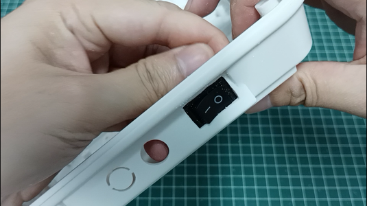

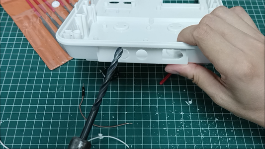

Lastly, I made a hole on the case bigger so that I could fit my switch button.

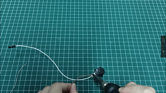

Step 2: Make and Connect the Switch

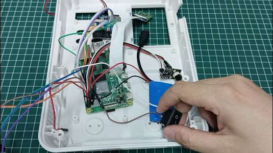

When I was planning it out, I totally forgot about the on/off switch. It wasn't until I was halfway through making it that I suddenly remembered. I realized that if I didn't include a switch, it would be a real pain to turn the thing on and off - I'd have to keep opening up the box and plugging/unplugging the power cord. But if I put in a switch, it would be way easier to control the power.

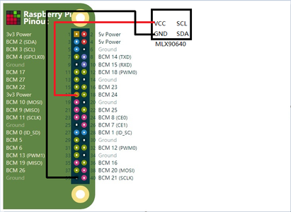

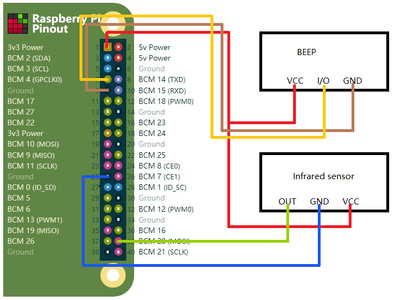

Step 3: Connect All Modules Together

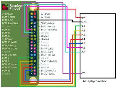

After preparing the case, you can start connecting all the modules together. This step is crucial and requires careful attention. Make sure you don't connect the wires incorrectly, especially the positive and negative poles. If there is a short circuit, it may damage the modules or even your Raspberry Pi!
In addition, there are two cameras that you need to connect to the Raspberry Pi. One is a QR code camera that can be plugged into any USB port on the Pi, and the other is a mask recognition camera that should be connected to the Pi's default CAMERA interface.
Here is the wiring diagram that I prepared. You can follow this diagram to connect the modules. Please make sure you don't connect them incorrectly.

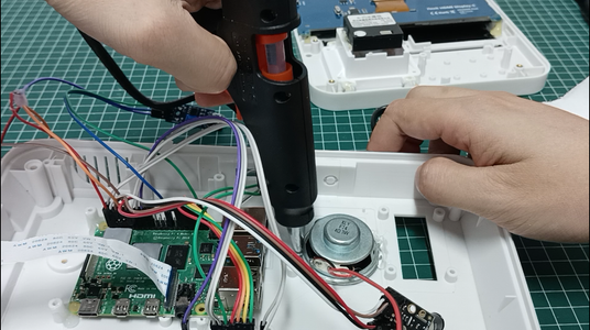

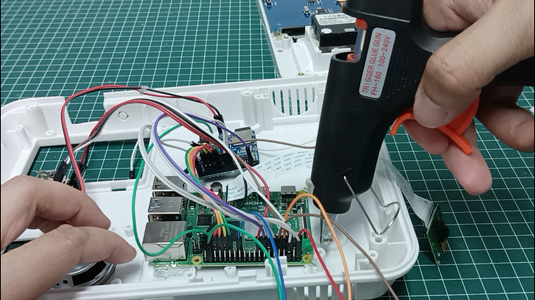

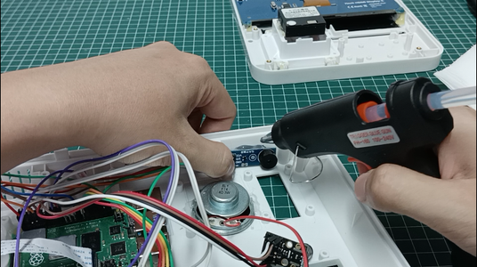

Step 4: Fixing and Assembly

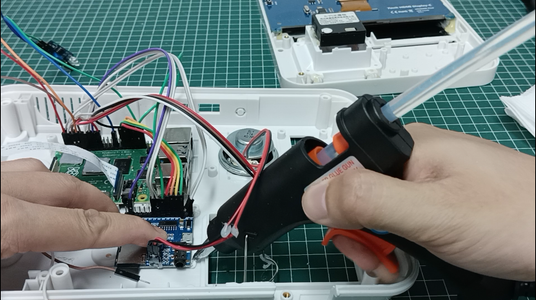

First, let's use some hot glue to stick the screen and QR code camera onto the front of the case. This will make things easier when we're putting everything together later. Then we can fix all the other parts onto the back of the case. I decided where to put them based on the case I'm using, but you can arrange them however you like as long as everything can connect properly and the case closes up completely.

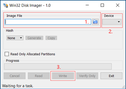

Step 5: Wrtie the Image
I've finished the hardware part, and now in this step, I need to download an image onto my computer. Setting up the environment is a bit complicated and if I make a mistake, it could mess up the software and I'd have to start all over again, which takes a lot of time. That's why I highly recommend using the image I'm providing.
Before I can burn the image, I need to download and install a software called "Win32 Disk Imager," which will help me burn the image onto an SD card. After I've installed the software, I'll open it, find the image I'm using, choose the SD card, and click "Write" to burn the image.
Once the burning process is complete, I'll insert the SD card into the Raspberry Pi, and then it's ready to be turned on!

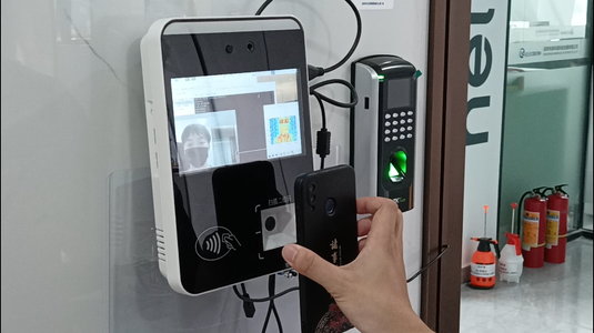

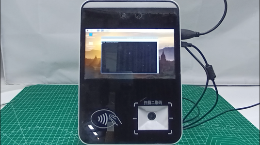

After completing all of the above steps, I can see the same effect as shown in the video. Isn't it amazing? And it only requires a Raspberry Pi 4B to achieve such a cool function, which impressed my colleagues and made me very happy. It also helps remind my colleagues to wear masks and reduce the risk of infection.
