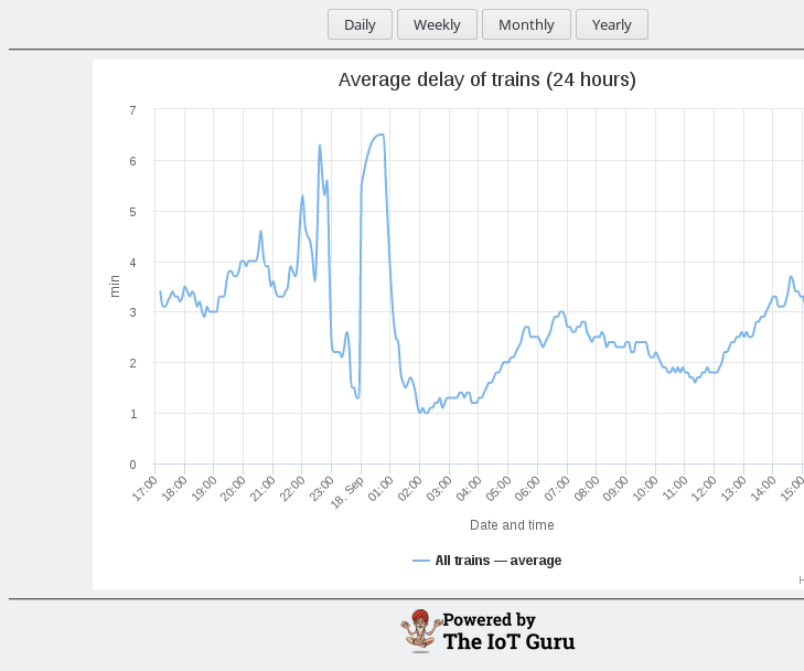

Step 5: Run and Check
If everything is fine, your thermometer box will send the sensor measurements to the cloud and you'll see such nice graphs over time if enough measurements have accumulated.
Live examples:
- https://iotguru.cloud/field/srcPlk78rcpgCgCgKWcR6g/temperature
- https://iotguru.cloud/field/tGib1WSRvEGJ98rQYU8R6g/temperature
