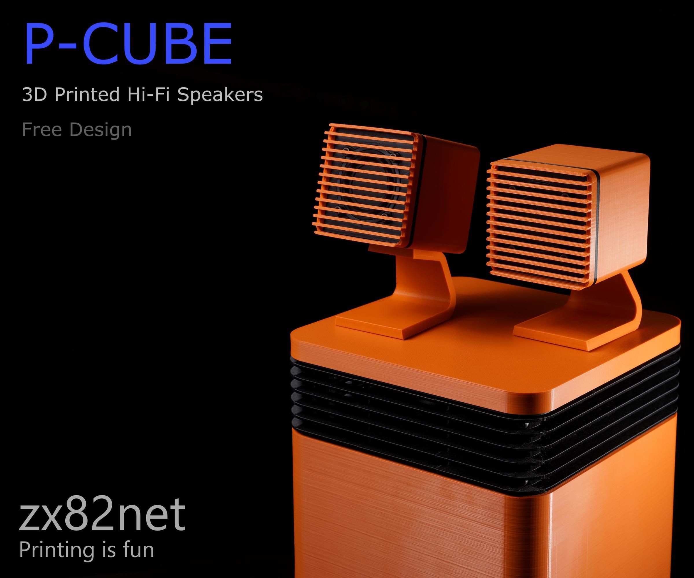

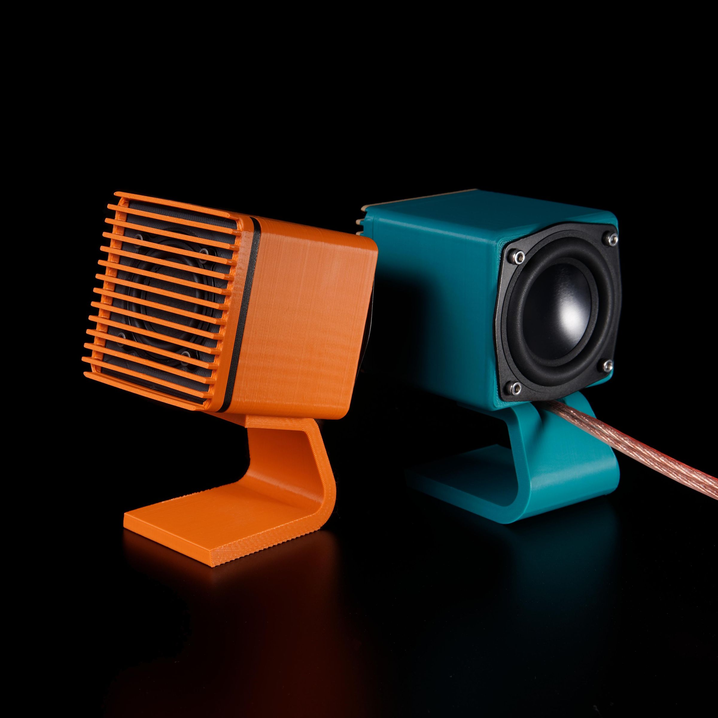

Check you some of my other audio Projects:
P-CUBE Speaker System Instructable:
https://www.instructables.com/P-CUBE-Speaker-Syste...
