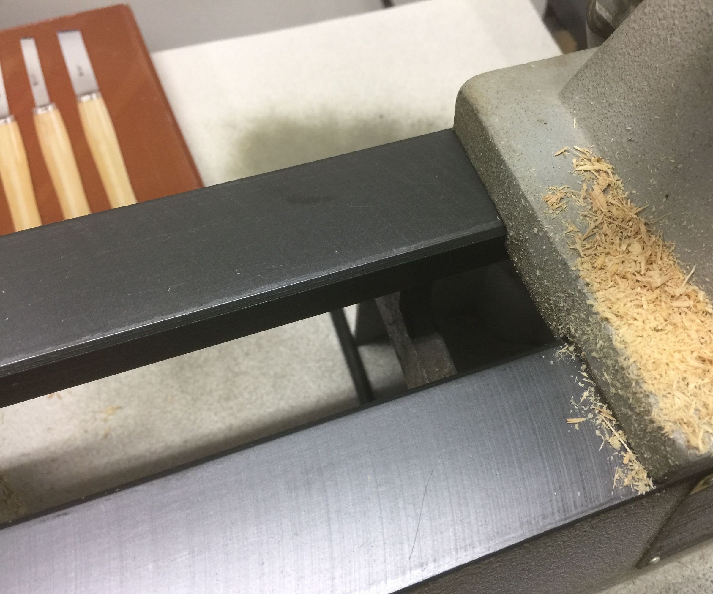

Step 6: Enjoy!
After everything's back together, your saw is ready for service again. Take a step back and admire the awesome job that you've done!
To keep your saw from rusting over again, avoid exposing it to moisture. This is difficult to do in the average garage or workshop, but you can take steps to reduce exposure. Avoid setting drinks and other tools on top of the table that might contain moisture. You should also periodically reapply a coat of wax to protect the surface.
Your saw's new finish, if properly maintained, will last for the life of the tool and serve you well. Enjoy!
