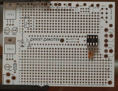

Step 1: Socket and Resistors
Add the DIP socket so that Pin 1 goes in the hole marked PIC and the notch looks like the photo.
Add the 330 Ohm resistors (Orange - Orange - Brown) to the board
K25 - P25
K26 - P26
K25 - P25
K26 - P26

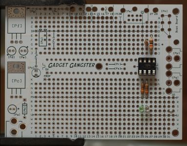

Step 2: Remaining Resistors
With a bit of excess lead, add a jumper from T32 - T31
Add the 10K resistor (Brown - Black - Orange) from E27 - J27
Add the 1M resistor (Brown - Black - Green) from F26 - G26. This resistor doesn't lay down, but goes straight up and down (transistor radio style)
The longer lead of the green LED goes in S25. Short lead goes in T25
The shorter lead of the red LED goes in S26. Long lead goes in T26 (Yes, this is opposite of most LED's)

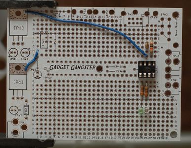

Step 3: Connecting the Decision Probes
The Decision Maker makes a complex set of very scientific measurements through the Decision Probes.
Take a bit of hookup wire, but one end through one of the several small holes in the metal area at [Pf], the other end connects to J26.
For the other pad, use a bit of hookup wire to connect H1 to one of the small holes at [Pc].

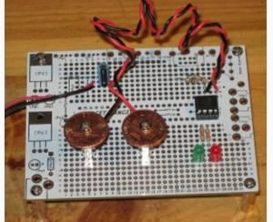

When your project is complete, you'll simply place a finger at each of the Decision probes, and lift a finger to receive your decision. If you want to get fancy, you can use a metal spacer through the big holes in the Decision Probes and connect a penny to each, as shown in the pictures on Gadget Gangster.

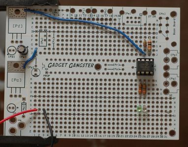

Step 4: Finishing Up
Connect the battery box, the red wire goes at T2, the black wire goes at T3. You can thread the power wire through the holes at the bottom left of the board for stress relief. Add the capacitor at [Pe] so the stripe is closer to [Pe].
Add batteries and insert the PICaxe in the socket (the notch as indicated in the photo). That's it! If you buy this kit on Gadget Gangster, the PICaxe will come pre-programmed. there's also a schematic to download and the source code.
