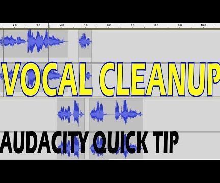

Step 4: Adding Emphasis 1 - Isolating Audio
In this project, I wanted to create a strong emphasis on certain words. We need to isolate those parts before we apply any additional effects.
Copy your vocal track and paste it below.
On the new copy, highlight the parts that you will need to remove. Zoom in by using the Zoom tool, or by hitting Ctrl and scrolling forward on your mouse's scroll wheel. The selection needs to be exact.
Use the Silence Audio tool to silence the selected audio, leaving only those parts you wish to emphasise.
